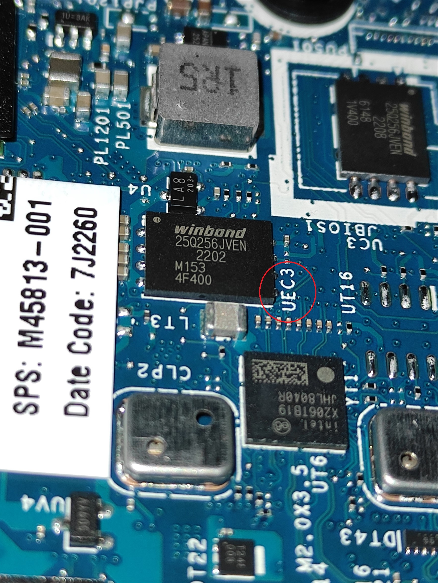

                                Hi, I've got an Hp X360 1030 G8 Laptop. It has locked bios. Is it required to take off both the bios chip as well as the EC chip or is it possible just to use the bios chip?
                                Another thing is it possible for me to use the zip files which are unlocked for other laptop in this forum?
                                I would greatly appreciate your help in this matter.

                                  Hello, you must read and upload your in of the uec3 chip, it is always best to repair the original file, many times the bios of other computers do not work, especially in the new generations, and if they work, some detail may remain...

                                    Hi, Thank you for your quick reply.
                                    I've taken off the main bios chip and made a copy of it. I am unsure what you mean(For which I apologize) by uec3 chip. Is this the chip next to the main bios chip or the one at the back of the board?
                                    Luckily I was able to make a copy (of the main Winbond BIOS chip)and I've attached it.
                                    I was able to find the uec3 chip on the motherboard. I will send a copy of it after reading it.
                                    Please let me know if there is anything else I may be missing. I appreciate your efforts.

                                      You must read the chip that I mentioned before, check the image.

                                        Re: HP X360 1030 g8 Bios unlock
                                        Thank you for clarifying that I was able to get the chip off and got the data off I've attached both files.
                                        Once again I appreciate your help.

                                          Ok write just the uec3 test and comment the result.
