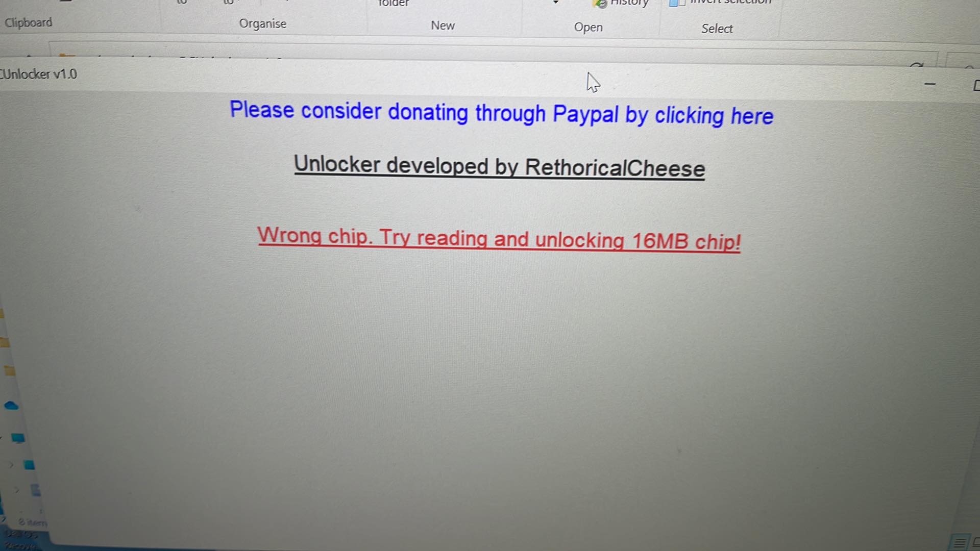

    i provide the serial number
    sorry may be my English not good enough can you tell me please what else need to do
    Try RCUnlocker on the 16MB chip.
      unsuccessful
      32mb chip

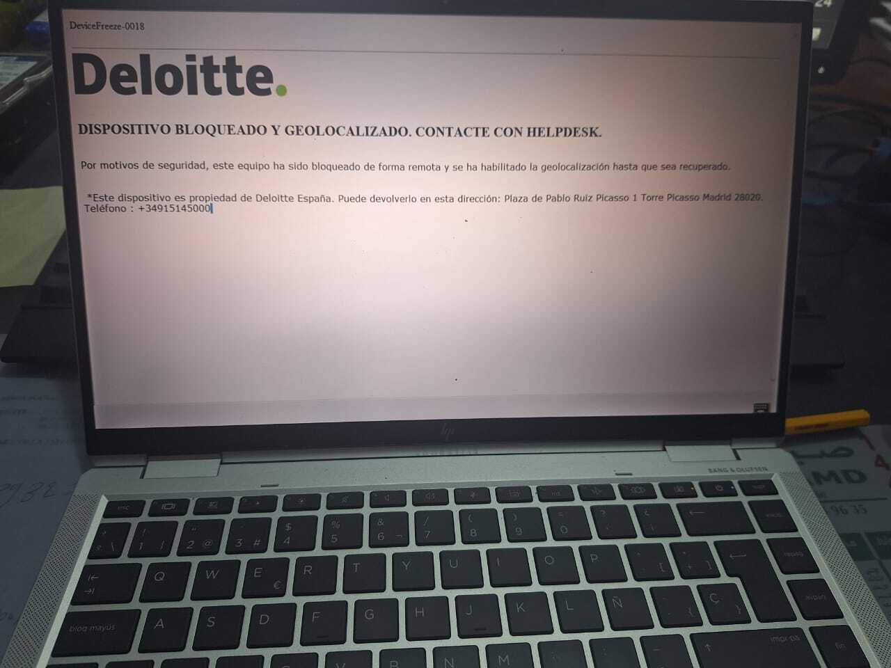

        can i remove computrace of this laptop with rcunlocker?
        • hoaca388
          Badcaps
          • Jan 2022
          • 12513
          #64
          Impossible, please post bios + ec file here.

                      #70
                      i found problem on ssd when i change it to another laptop give same thing
                      device freeze 0018

                              #74
                              Originally posted by Ghamidi
                              try this file
                              noisy fan with black screen
                              reflash MAIN Bios only
                              format ssd and wait about 1 hour message appear
                              Originally posted by minhdigital
                              Send to you, Try
                              working fine 2 days now after formating laptop without msg thanks a lot to all
