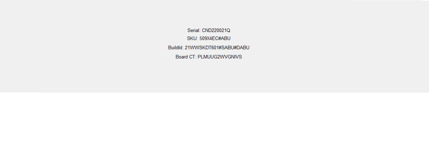

                  You're welcome.
                  Find attached to the post the image with the DMI information you'll need and separately the Feature byte as a code for copying.
                  Code:
                  476J6S6b7B7H7M7R7W7maBaEapaqauawbVbhcAdpdqfPguhZjhk8mEmwn7nVngpDpqqx.Rq
