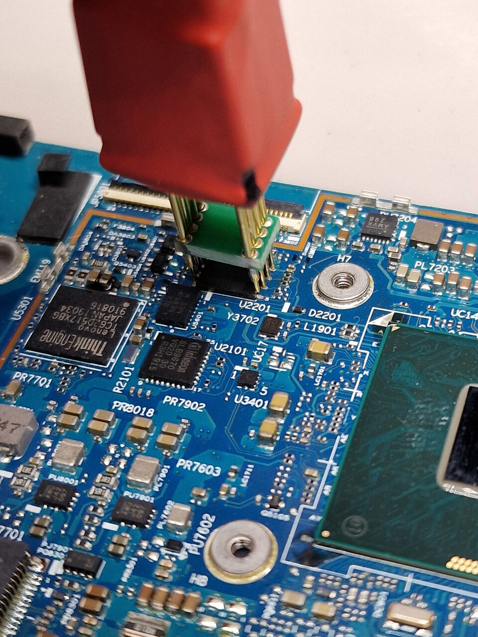

                  Try IMSProg https://github.com/bigbigmdm/IMSProg .You can`t use a SOP8 clip as it is. Cut the clamp off completely and then solder the wires to the copper pads or if you want to keep the clamp cut part of the insulation off and solder extra wires to the existing ones ,then solder the new wires to the pads. Keep the wires as short as possible. The other alternatives are to buy a WSON pogo adapter (you have to hold it very steady to get a good backup) or desolder the chip and use a WSON adapter board.
                  • Nicola Bianchi
                    • Jan 2025
                    • 15
                    • Switzerland
                    Yeah, I think my SOIC8 clip is not the right one.
                    Now I ordered a WSON8 tester which should be better.
                    Talk to you soon.

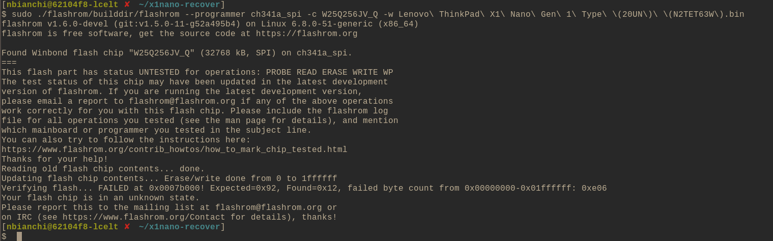

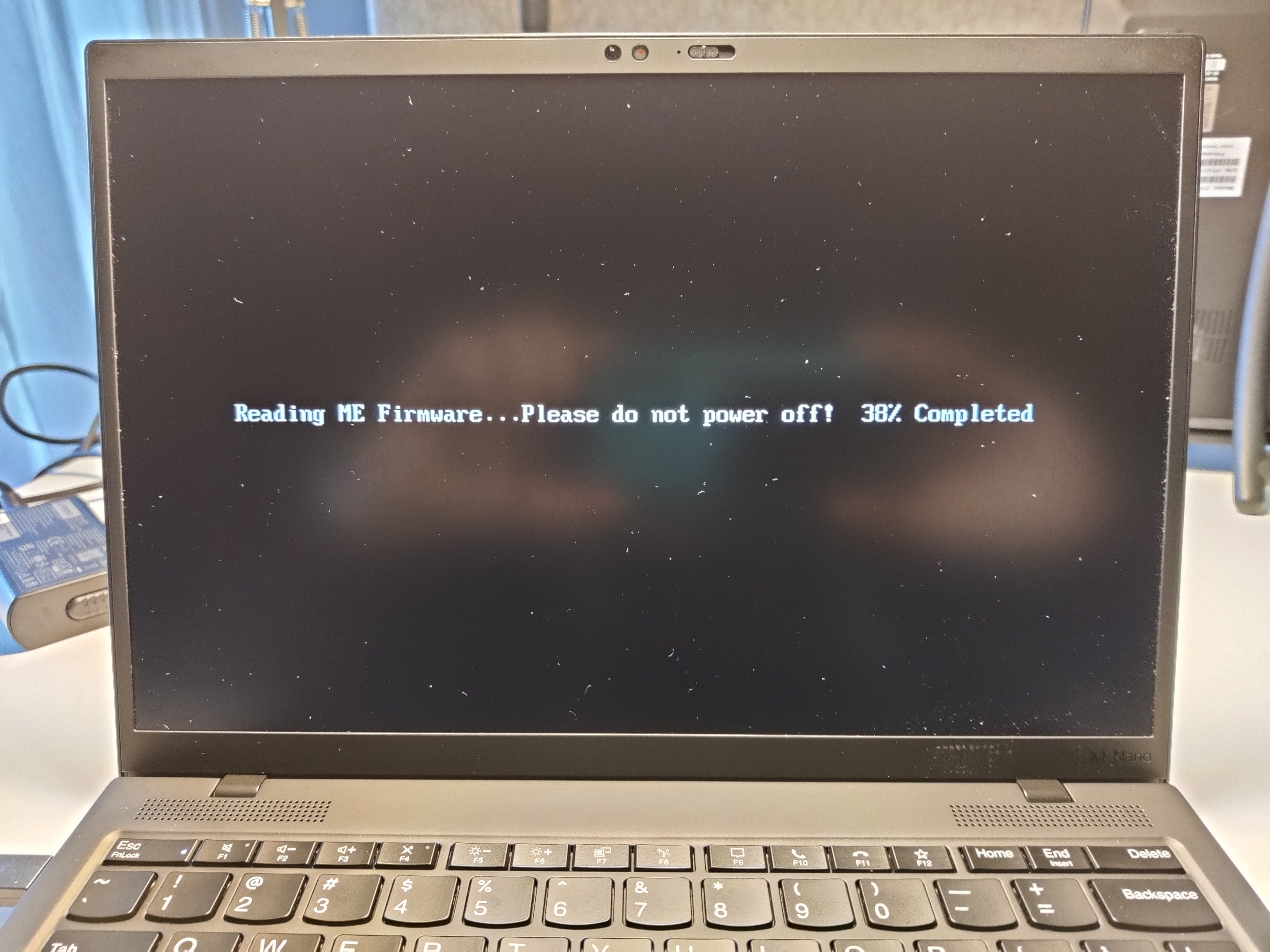

                            I did a first attempt to flash the BIOS file, the tool reported back an error, but I tried to boot up the laptop anyway.
                            The result is that he did something different than before: "reading ME Firmware" ... but now it ended up in the same "BIOS Self Healing backup progressing ...100%" state.
                            I will try later to flash it again.

                              I don't use flashrom, but I can see failed in verifying the chip. That means the file on the chips isn't identical with the file that you already programmed.
                              all donations are welcome,
                                • 21922
                                Try using flashrom agin, and IMSProg, if you get the same error at the same point the chip has a problem. If you get different errors in differnt places it could be you not holding the pogo adapter steady enough.

                                  Hi guys,
                                  I did manage to get a successful write!
                                  Unfortunately though, the laptop is still in the same situation, stuck in the "BIOS Self Healing backup progressing ...100%" screen 🤷‍♂️
                                  A couple of notes:
                                  - I had to use W25Q256JV chip type instead of 25R256JVEQ ... maybe this in an issue?
                                  - I used flashrom that for W25Q256JV_Q has only an untested state
                                  .... still that the write succeeded 🤔

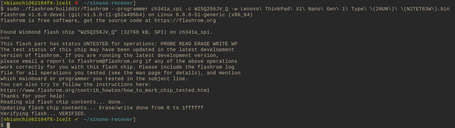

                                      For the records, I managed to recover my X1 Nano using the attached bios firmware using flashrom
                                      sudo ./flashrom/builddir/flashrom --programmer ch341a_spi -c W25Q256JV_Q -w X1_Nano_Gen_1_Laptop_ThinkPad_-_Type_20UN.bin
                                      Thank you for the support!
