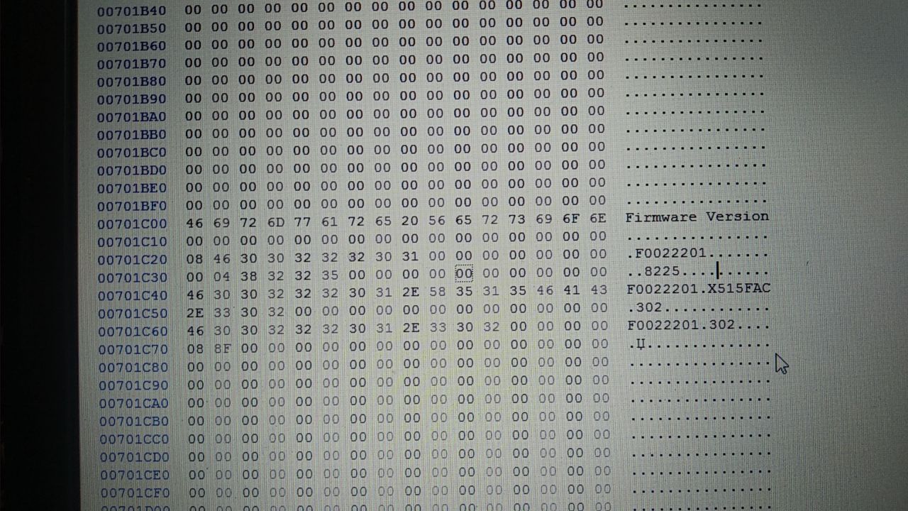

    HI Guys, I need bios for laptop Asus X509FAC rev 2.0
    My old bios

      My old bios container address 00701C00 X515FAC.302 words
      I want dump clear ME for X515FAC.302

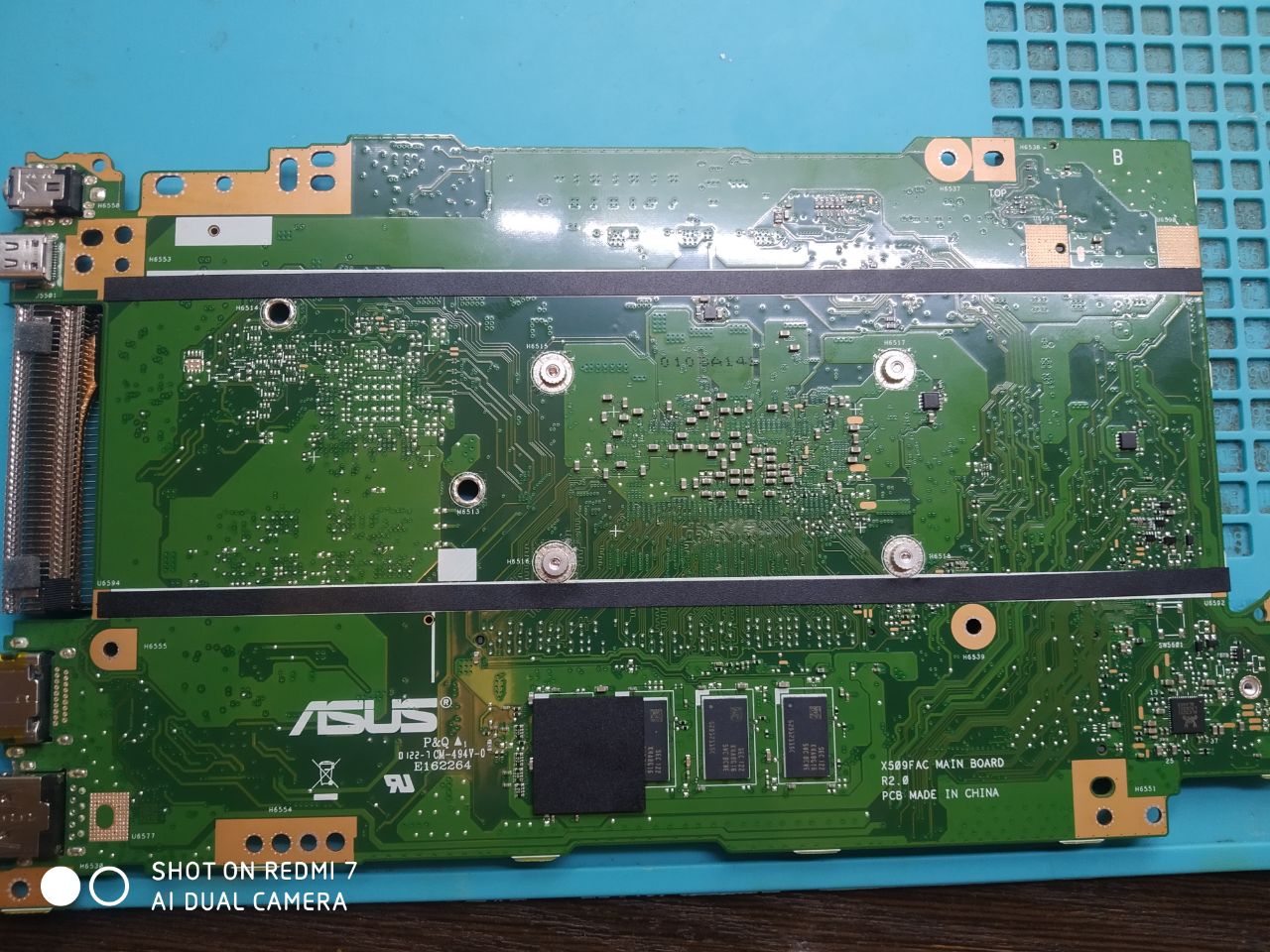

        Take a picture of all the stickers next to the ram slot and the QR codes on your motherboard.
        • husniddin
          • Jan 2017
          • 98
          • Uzbekistan
          Re: Dump Asus X509FAC
          Foto motherboard

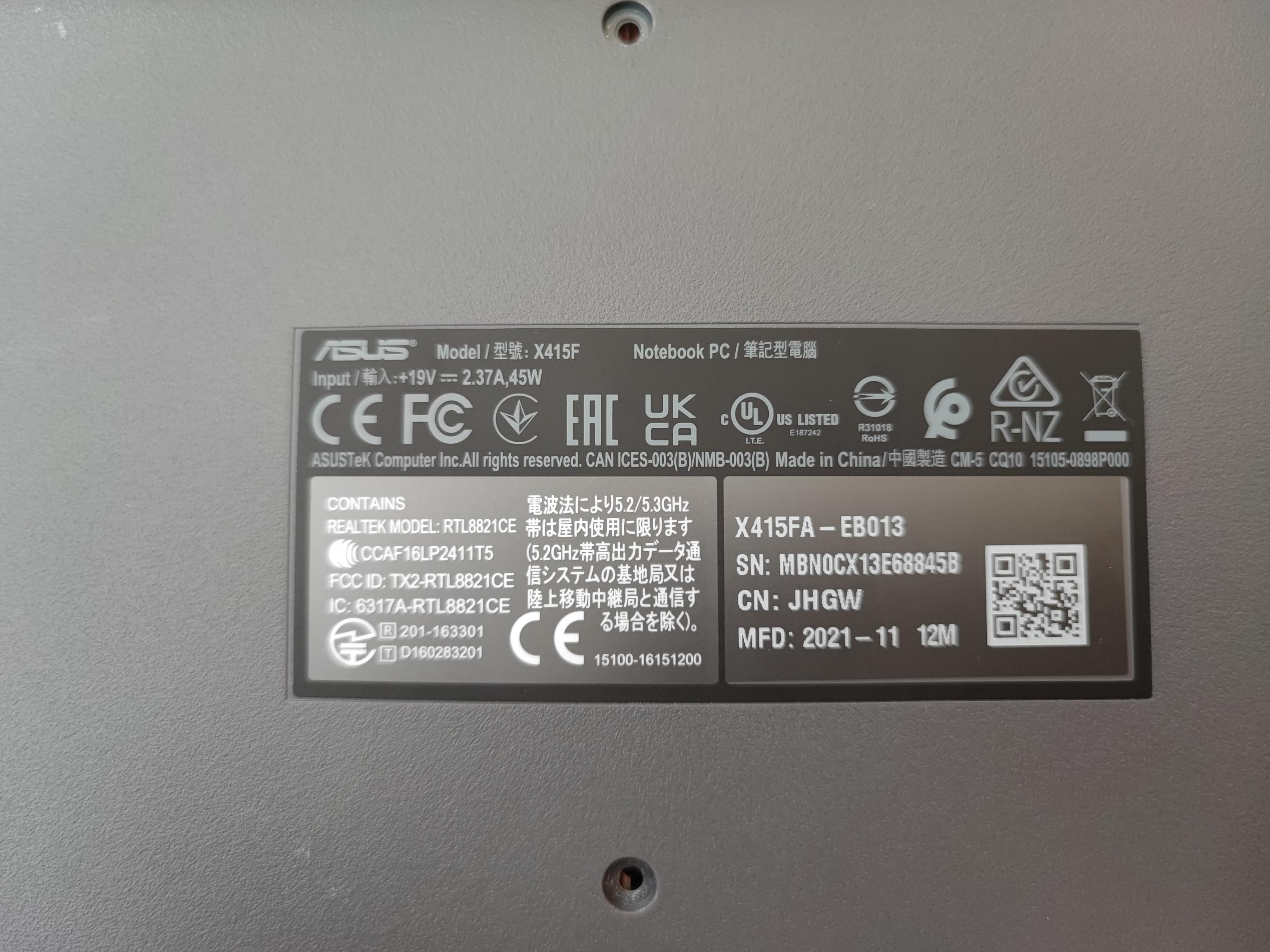

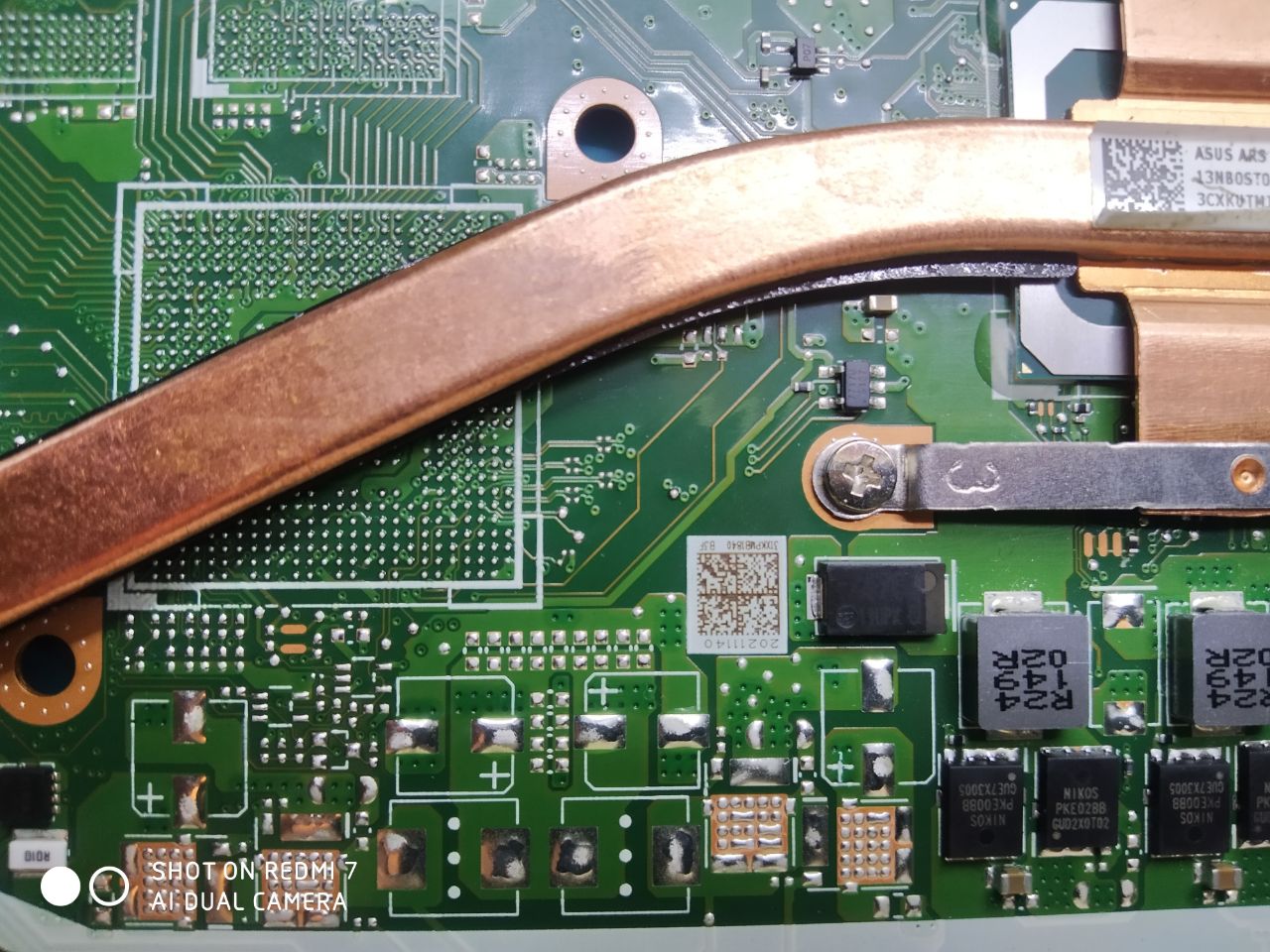

                  Laptop from another service, laptop din't switch on. They write another bios and think that it will fix problem but.... Original dump lost.
                  After this laptop was inspected by myself and i find that one mosfet on core was in short and burned resistor. Now laptop start, initialisation success but to slow. I try replace clear ME from repository but nothing changes, I never work with 10th generation. Maybe you have some guide links for this generation?

                    Post the laptop serial number,its on a sticker on the base.

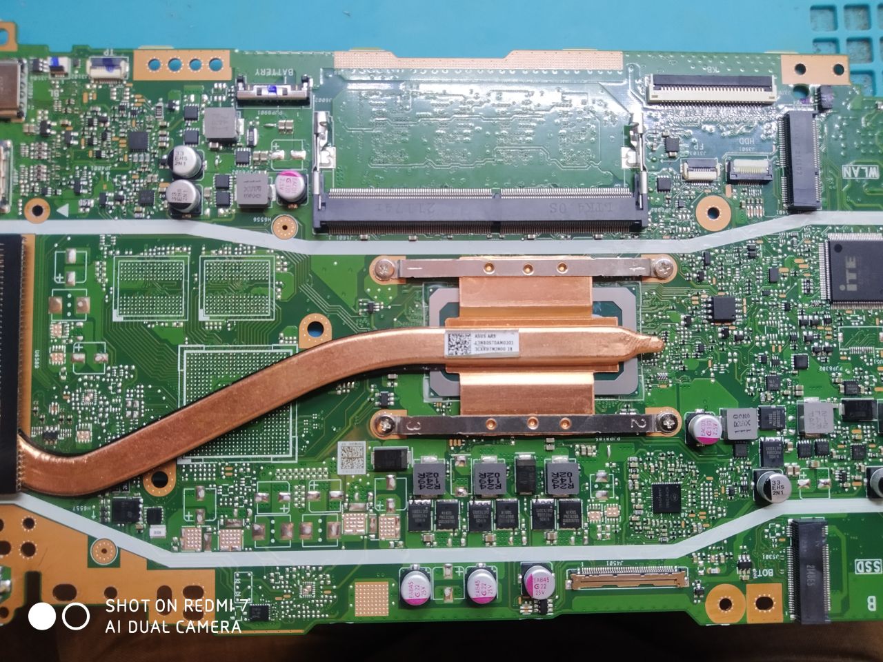

                      There is scanned from QR near SOC
                      QCCXKP83E14313483,MA43NBCX00SP2RMB,X415FAC,60NB0W10-MB2000,205,
                          Thank you very much it working!!!
                          Im sorry but where i can find some turtorial/instructions for 10th gen clear ME
                          How i understand you take original dump from asus downloads and after you separate hex code? From what strings? Clear ME was 14.0.47.1545 ? And wat else you change in build ? Sorry for to much questions from my side )

                              One more thing, its correctly working in bios but in case of loading from drive or usb stick laptop all time reboot before win logo. I try different nvme but still rebooting after logo ASUS. It can be bad bios or problem in SOC? Board without video (UMA)
