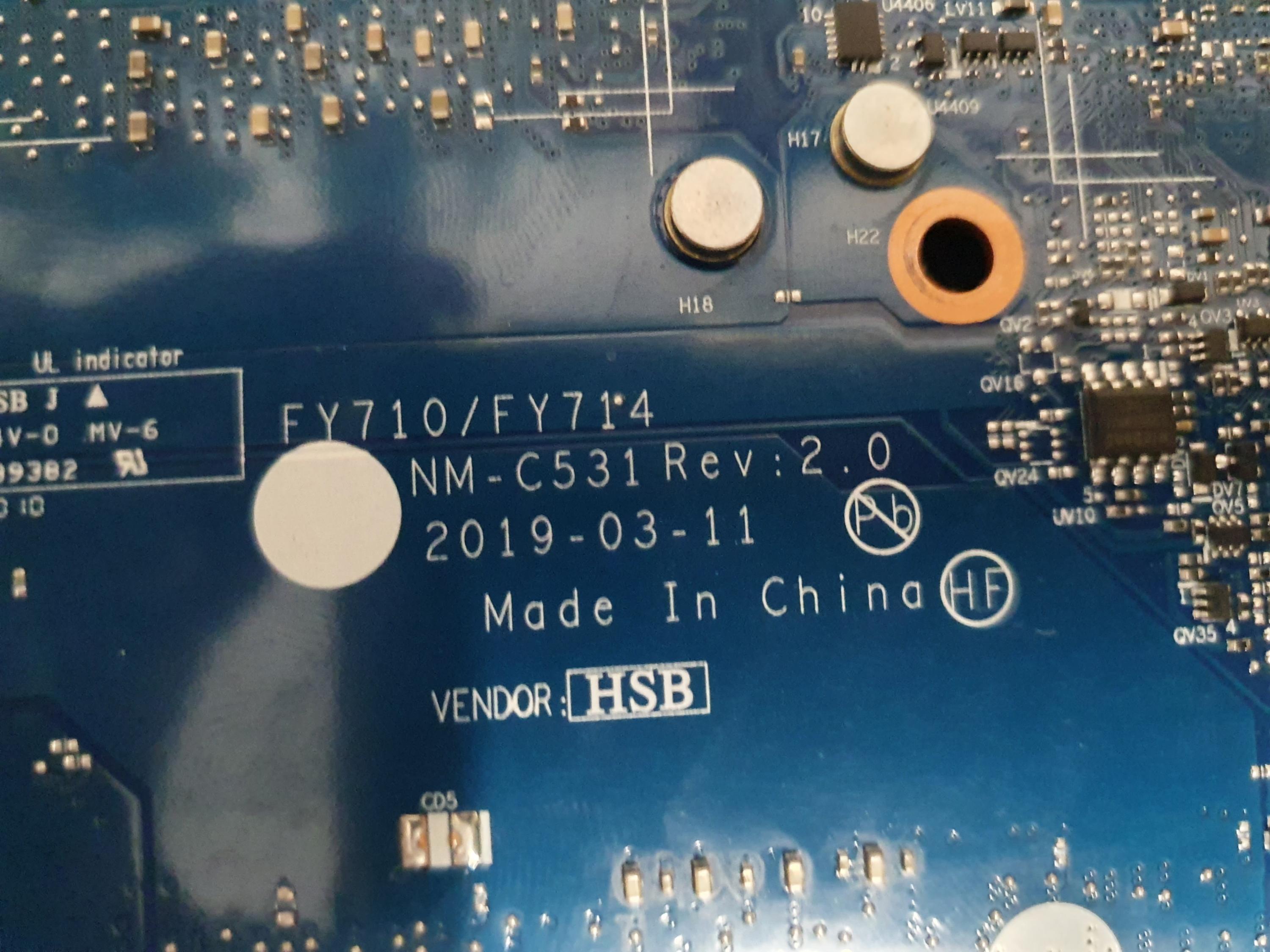

              Lenovo y540-17IRH Bios
              Lenovo y540-17IRH
              Board fy710/fy714 nm-c531 rev:2.0
              BIOS help me ?

                Re: Lenovo y540-17IRH Bios
                Originally posted by fcelikel
                Lenovo y540-17IRH
                BIOS help me ?
                post the original bios of the laptop

                  Re: Lenovo Legion Y540-17IRH bricked, need BIOS
                  There is 3 volts, 5 volts, the keyboard led is on, no display
                  • peste
                    • Dec 2016
                    • 13718
                    • ROMANIA
                    try post#3
