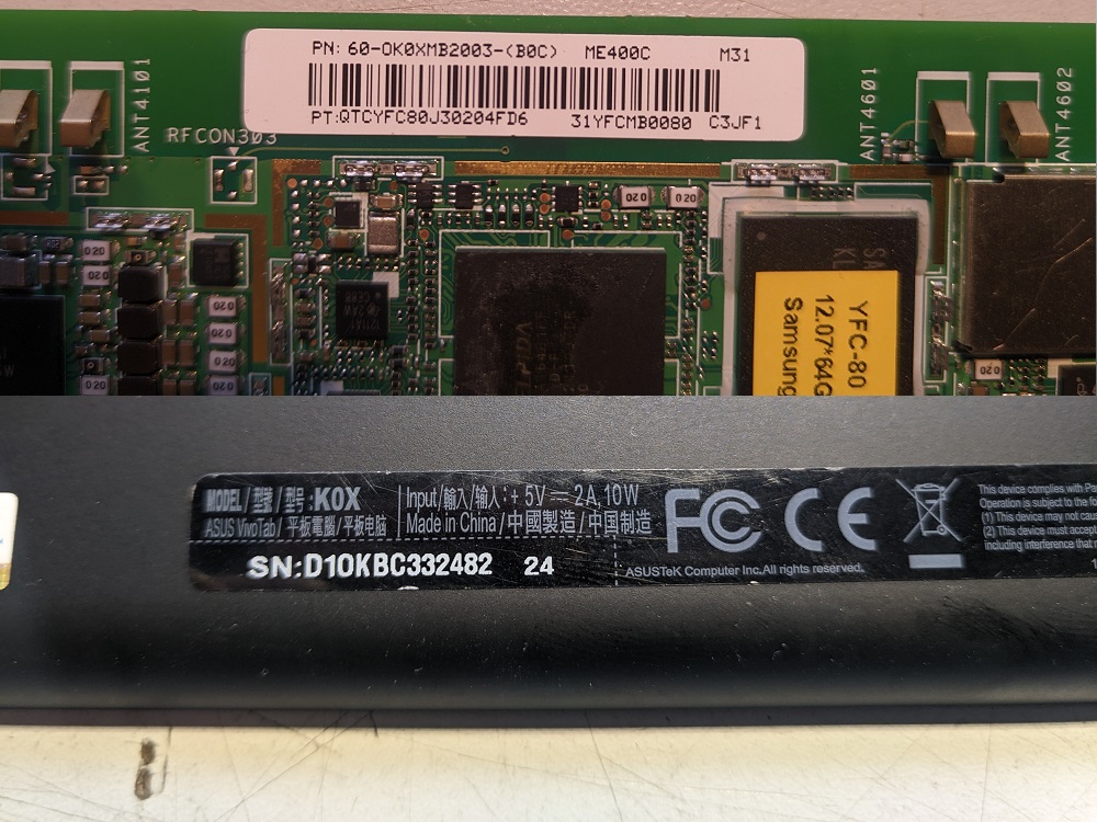

        Send photo model and serial Asus.

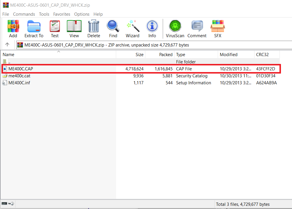

          See if there are any other chips. File download from Asus more than 4MB of data.

            here

              Re: Asus ME400C (VivoTab) Bios?
              hmm not good...cannot find another....maybe is part of bios stored on emmc
