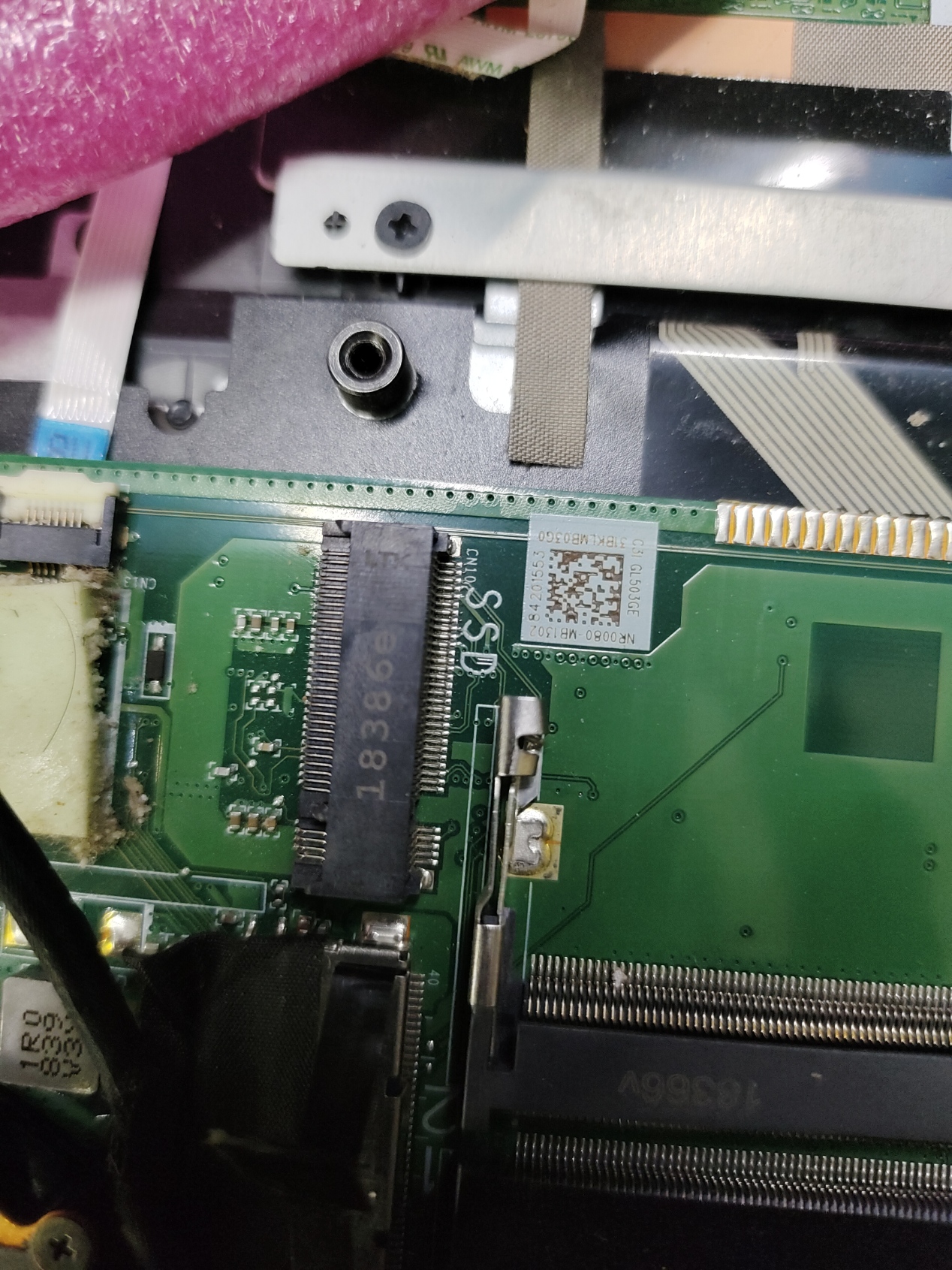

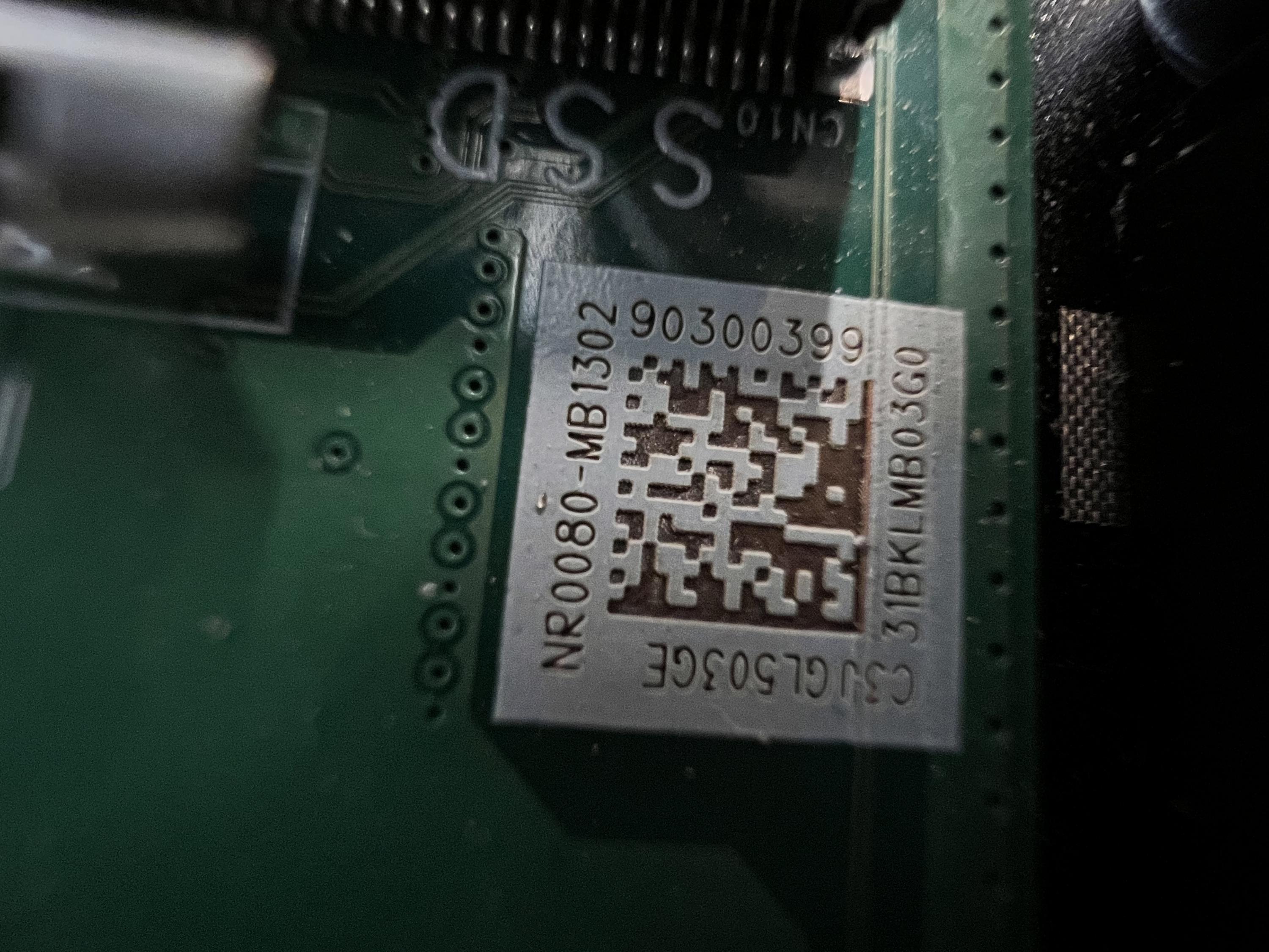

                      Can you post a picture of the square white QR code next to the RAM slot clip .
                      • Lucidic
                        • Oct 2021
                        • 9
                        Re: GL503GE (DABKLBMB8C0 Rev C) BIOS needed
                        Here it is
                        Edit: this is what that code says according to my we code scanner
                        NR0080-MB1302
                        C3U GL503GE
                        665005 06 1
                        31BKLMB03GO
