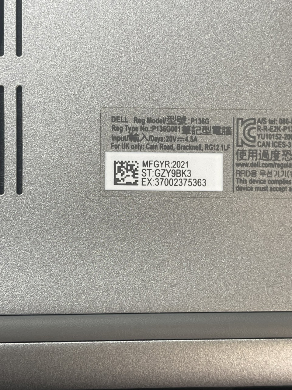

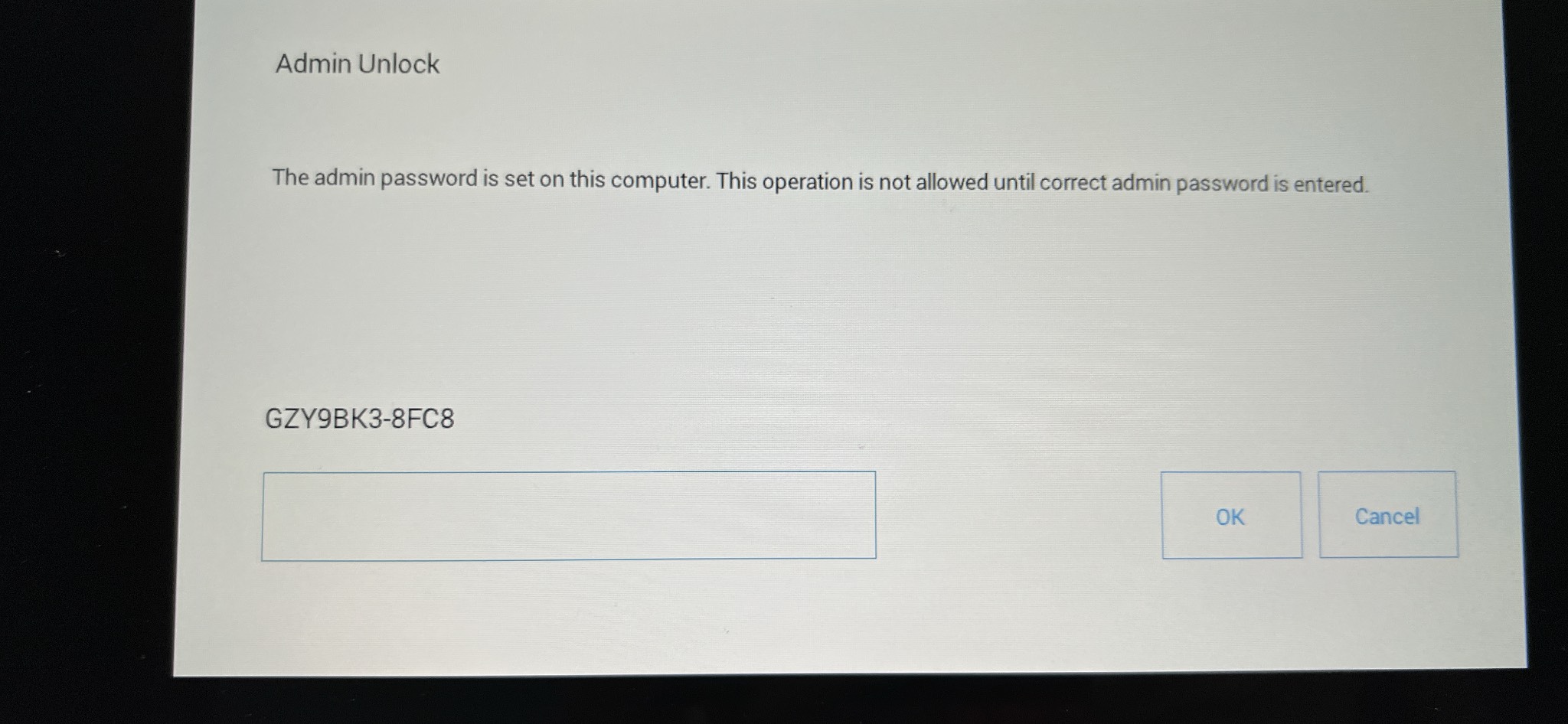

need bios GDC31 LA-K371P rev.3.0
  • devp62
    • Dec 2014
    • 52
    • uk
    Re: need bios GDC31 LA-K371P rev.3.0
    Any help anyone please
    • mmccomputer
      • 71
      • France
      Re: need bios GDC31 LA-K371P rev.3.0
      Hello everyone
      Please can you help me to rebuild a correct bios file from this backup (No Display) ?
      • Markus1741
        • Sep 2020
        • 843
        • N/A
        Re: need bios GDC31 LA-K371P rev.3.0
        Originally posted by mmccomputer
        Hello everyone
        Please can you help me to rebuild a correct bios file from this backup (No Display) ?
        Try ...
        Your notebook is a Dell Latitude 7320?
        Service-Tag G4Y5LN3
        or you can try this
        https://www.badcaps.net/forum/showpo...63&postcount=1
        Last edited by Markus1741; 07-13-2023, 06:59 AM.
        • mmccomputer
          • 71
          • France
          Re: need bios GDC31 LA-K371P rev.3.0
          Originally posted by Markus1741
          Try ...
          Your notebook is a Dell Latitude 7320?
          Service-Tag G4Y5LN3
          or you can try this
          https://www.badcaps.net/forum/showpo...63&postcount=1
          yes the model and service tag are good, but this dump are not working with me, but the fan and backlight for keyboard still on
          • tranbaolaptop
            • Nov 2016
            • 17
            • viet nam
            Re: need bios GDC31 LA-K371P rev.3.0
            password e7520 unlock help
            • tranbaolaptop
              • Nov 2016
              • 17
              • viet nam
              Re: need bios GDC31 LA-K371P rev.3.0
              password e7520 unlock help
              • tranbaolaptop
                • Nov 2016
                • 17
                • viet nam
                Re: need bios GDC31 LA-K371P rev.3.0
                password e7420 unlock help
                Tag : GZY9BK3
                • hoaca388
                  Badcaps
                  • Jan 2022
                  • 11559
                  • Viet Nam
                  Re: need bios GDC31 LA-K371P rev.3.0
                  Originally posted by tranbaolaptop
                  password e7420 unlock help
                  tag : Gzy9bk3
                  aaaaaa
                  • Dhaka Lab
                    • Nov 2020
                    • 29
                    • Bangladesh
                    #29
                    Re: need bios GDC31 LA-K371P rev.3.0
                    please remove admin passowrd
                    model dell Latitude 7420
                    service tag: 723M5G3
                      • 20611
                      #30
                      Re: need bios GDC31 LA-K371P rev.3.0
                      Originally posted by Dhaka Lab
                      please remove admin passowrd
                      model dell Latitude 7420
                      service tag: 723M5G3
                      Password suffix 8FC8 or something else ?
                      https://www.badcaps.net/forum/showpo...42&postcount=4
                      • hani55
                        • 100
                        • morocco
                        #31
                        Re: need bios GDC31 LA-K371P rev.3.0
                        help me Brothers REPAIR bios
                        dell not power
                        dell Latitude 7420
                        GDC31 LA-K371P rev.3.0
                        ser tag : 65V2DK3
                        • hoaca388
                          Badcaps
                          • Jan 2022
                          • 11559
                          • Viet Nam
                          #32
                          Re: need bios GDC31 LA-K371P rev.3.0
                          Originally posted by hani55
                          help me Brothers REPAIR bios
                          dell not power
                          dell Latitude 7420
                          GDC31 LA-K371P rev.3.0
                          ser tag : 65V2DK3
                          Latitude 7420
                          Service Tag: 65V2DK3
                          • hani55
                            • 100
                            • morocco
                            #33
                            Re: need bios GDC31 LA-K371P rev.3.0
                            thanks brother i
                            • Mrnixdorf
                              • Sep 2016
                              • 120
                              • Morocco
                              #34
                              Re: need bios GDC31 LA-K371P rev.3.0
                              password e7520 unlock help
                              la-k371p
                              ST 9W4B043
                              • volinakis
                                • Jan 2021
                                • 2695
                                • N/A
                                #35
                                Re: need bios GDC31 LA-K371P rev.3.0
                                Originally posted by Mrnixdorf
                                password e7520 unlock help
                                la-k371p
                                ST 9W4B043
                                your laptop is Latitude 7420, not e7520.
                                • Mrnixdorf
                                  • Sep 2016
                                  • 120
                                  • Morocco
                                  #36
                                  Re: need bios GDC31 LA-K371P rev.3.0
                                  thanks brother i
                                  • ahmetermin
                                    • Mar 2015
                                    • 38
                                    • batman
                                    #37
                                    Re: need bios GDC31 LA-K371P rev.3.0
                                    password E7420 unlock help
                                    ST:4JQ3CK3
                                    • Macdonald
                                      • Mar 2021
                                      • 23
                                      • Zimbabwe
                                      #38
                                      dell 7420 bios
                                      hie everyone i have my dell machine dell7420 core i7 11th gen i tried to remove the bios chip from the motherboard for reprogram but the challenge i got is the leg of the bios got broken in the process of removing it i didn't get the chance to copy the originals files from the chip because of the broken leg
                                      now when i program the bios from another bios file or extracted bios update the machine is switching on when i plug the battery and its freeze on dell logo , when i switch on without the battery its changes the colors blue, green, red no display any help pliz
                                      dell latitude 7420
                                      GDC31 LA-K371P
                                      REV: 3.0(A02)
                                      2021 - 08 - 30
                                        • 20611
                                        #39
                                        Re: dell 7420 bios
                                        Originally posted by Macdonald
                                        dell latitude 7420
                                        GDC31 LA-K371P
                                        REV: 3.0(A02)
                                        2021 - 08 - 30
                                        Post the laptop service tag .
                                        • Stunt
                                          • Oct 2019
                                          • 180
                                          • South Africa
                                          #40
                                          Hi help me remove password
                                          dell latitude 7420
                                          Service Tag 2Q6T3M3
                                          GDC31 LA-K371P
                                          REV: 3.0(A02)
                                          2021 - 08 - 30
                                          • Vesko356
                                            by Vesko356
                                            08-11-2023, 03:27 AM
                                          • jbonavita
                                            by jbonavita
                                            Some issues
                                            Things I tried
                                            04-29-2025, 09:38 PM
                                          • zenius
                                            by zenius
                                            12-08-2024, 06:13 AM
                                          • Wahaz
                                            by Wahaz
                                            10-30-2023, 08:42 PM
                                          • Bloodhoundje
                                            HP Pavilion Gaming Laptop 15-ec2523nd - Dimm2 slot disabled after corrupt bios repair? Advice requested.
                                            by Bloodhoundje
                                            Hi everyone,
                                            I have been doing hardware repair as a hobby for some years now and recently decided to learn about repairing laptops as a fun challenge.
                                            I managed to get my hands on a "HP Pavilion Gaming 15-ec2523nd" notebook that only shows a white power LED and doesnt respond to anything.
                                            After initial testing I concluded the bios seems to be corrupted since all voltages are normal and there are no shorts. HP has a feature for a bios restore from USB with winkey+B for this model. This did not work.
                                            I have desoldered the bios chip (GigaDevice...
                                            03-16-2024, 03:12 PM
