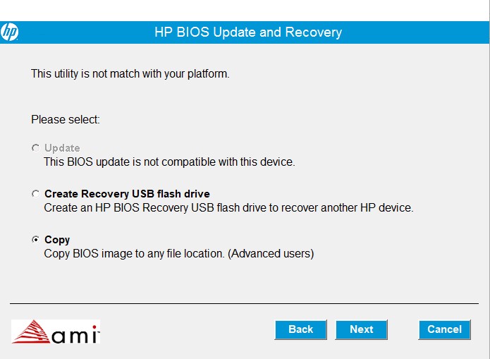

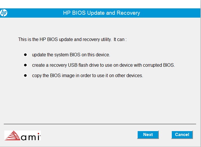

    Download the bios https://ftp.hp.com/pub/softpaq/sp135...0/sp135625.exe .You can get the bios by entering the serial number at the support page,or by entering the laptop model number.If there is no bios shown or a message says no drivers,change the OS to win10 64bit

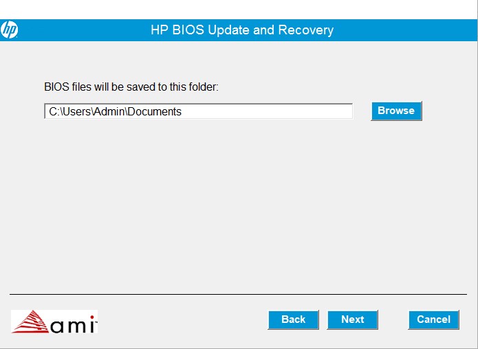

    Run the exe,it will give you the option to save to a location. If there`s a message about installing a driver cancel it,eventually the popup screen will come up allowing you to save the files. There are 2 bios extracted, 8MB and 16MB, so yours is one of them depending on the backup size. The bios is virgin,it has NO DMI ,its easy to copy the DMI from an insyde bios so make a backup !! ,and post it.

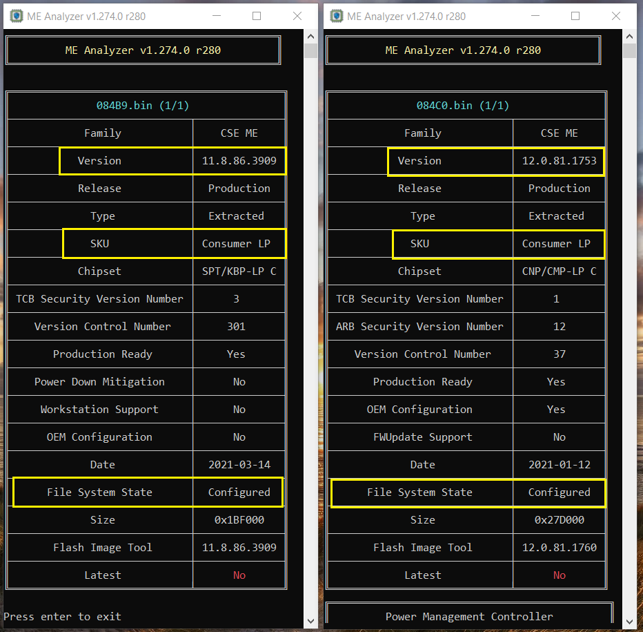

      I try to repair ME but ME analyzer give me weird messages that it is not in index. it shows ME version 300.

        Your case does not need to clear ME.
          Yeah credit to HP for making it easy to extract the newer bios updates and giving the option to make a recovery key or save a virgin bios.
          You don`t have to clean the ME, just use a virgin bios and copy the DMI over,its quicker,in my opinion.You could just flash the virgin bios,if the DMI isn`t recovered by itself you`ll have to use HP`s shitty BCU and/or wndmifit.
