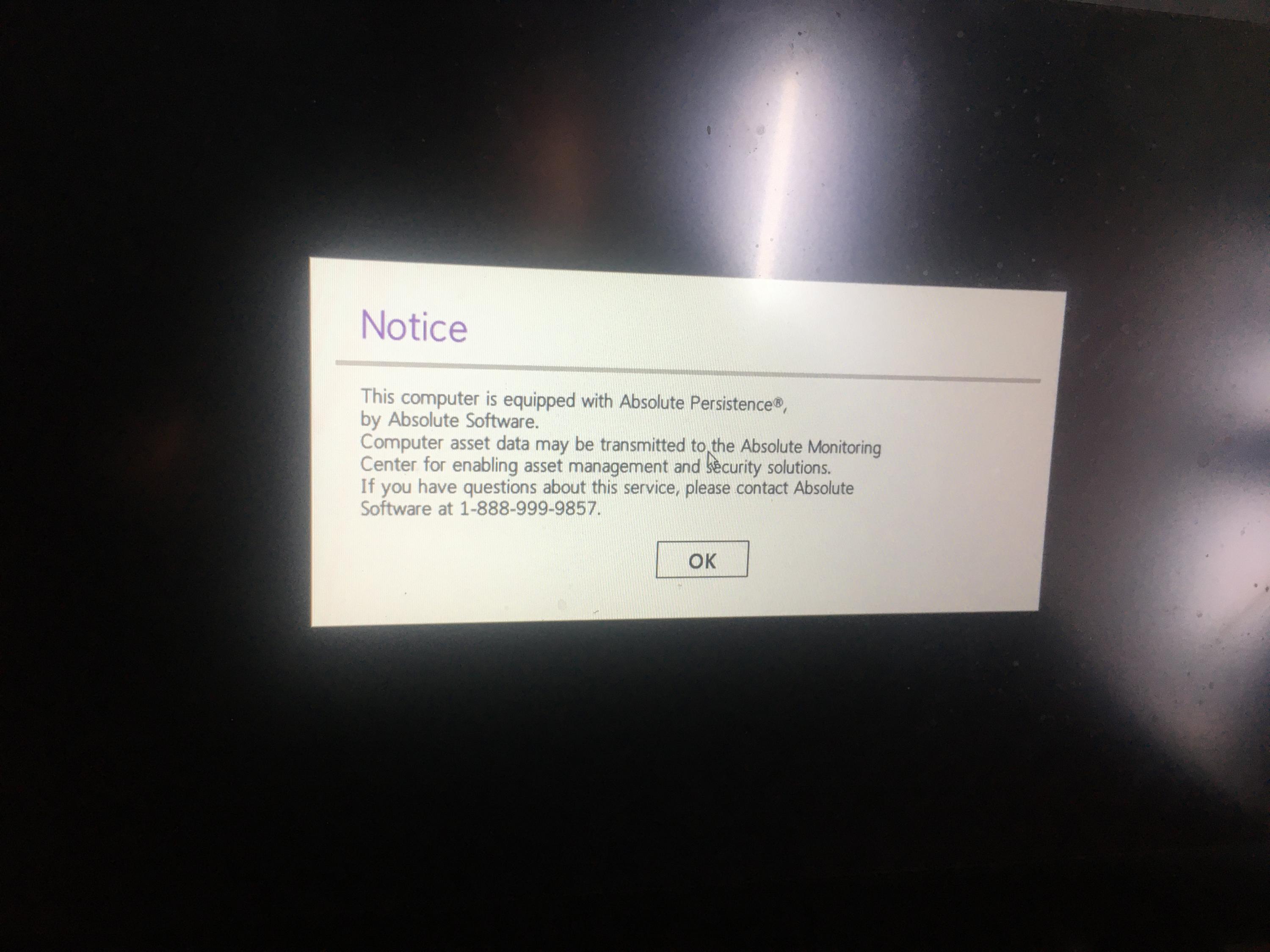

              Re: thinkpad 13 Gen1 locked bios
              Greetings, can you help me to remove absolute blocking?
                Absolute Computrace
                  Originally posted by partner
                  Absolute Computrace
                  thanks but i can't unlock it
                    Attach screenshot

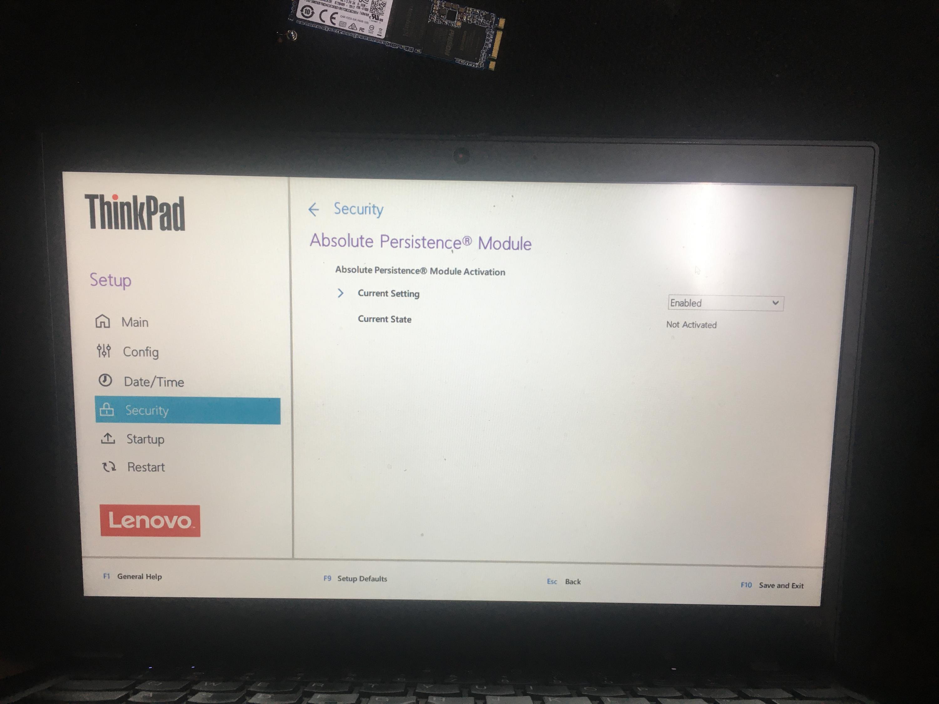

                      Attach screenshot
                      I attached images of the lock
                        Attach screenshot
                        Lenovo Checkmate
                          Originally posted by Vesko356
                          Lenovo Checkmate
                          have mercy, tell him to disable it

                                • echow2001
                                  • Dec 2016
                                  • 44
                                  you can just make your own clean img from lenovo btw just overwrite firmware bios region (offset 0xa00000 for this model) with the image from lenovo driver firmware update page extract it with uefitool for linux cab or the windows one self extracts the bin file for you. just make sure to keep the original gbe region; ME region etc. same idea for other manufacturers but youll have to splice the nvram region contained serial number etc since the product data is contained in efi. no need to download other people's dumps
                                    or you can compare dump against Vesko´s file and you'll discover a new world ...
