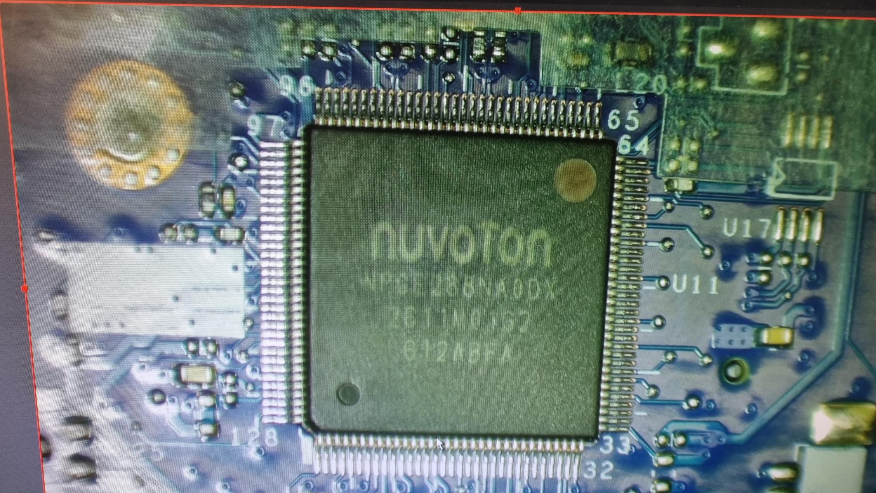

    Hi Guys
    I have a Lenovo Ideapad 305 laptop here
    Long story short - it was brought to me by another alleged repair company. It would not switch on but it would charge the baterry - I fixed this by repairing the flexi ribbon cable from the on/off switch which had a hole in it almost certainly caused by someone putting a case screw through it that was too long
    After fixing that, it powers on for a couple seconds then powers off again. Pressing the start button repeats the process. I get no picture, just the fans spin and I hear the HDD spin up. I tried unfreezing the SIO and resetting the BIOS, no difference. Tried with our without HDD, with PSU/Battery and both no difference. Tried with just one DIMM in either slot, no difference.
    I can see I have 3.3V and 5V but 1.7V, 1.1V, 1.35V come on for a couple seconds then go off again.
    After that I noticed someone has previously desoldered the BIOS and I have no idea what file it has been programmed with
    I read the BIOS contents (attached). The Eprom is a GD25B64BSIG and identifies/reads OK
    Can anyone give me a known good BIOS file or compare the one I posted with a known good one and tell me if it is OK or not?

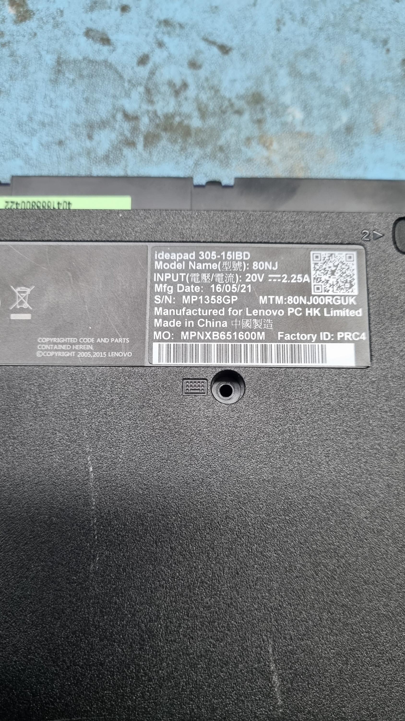

    Can you post the serial number thats on the case.

        Serial Number

          Re: Lenovo Ideapad 305 Bios required

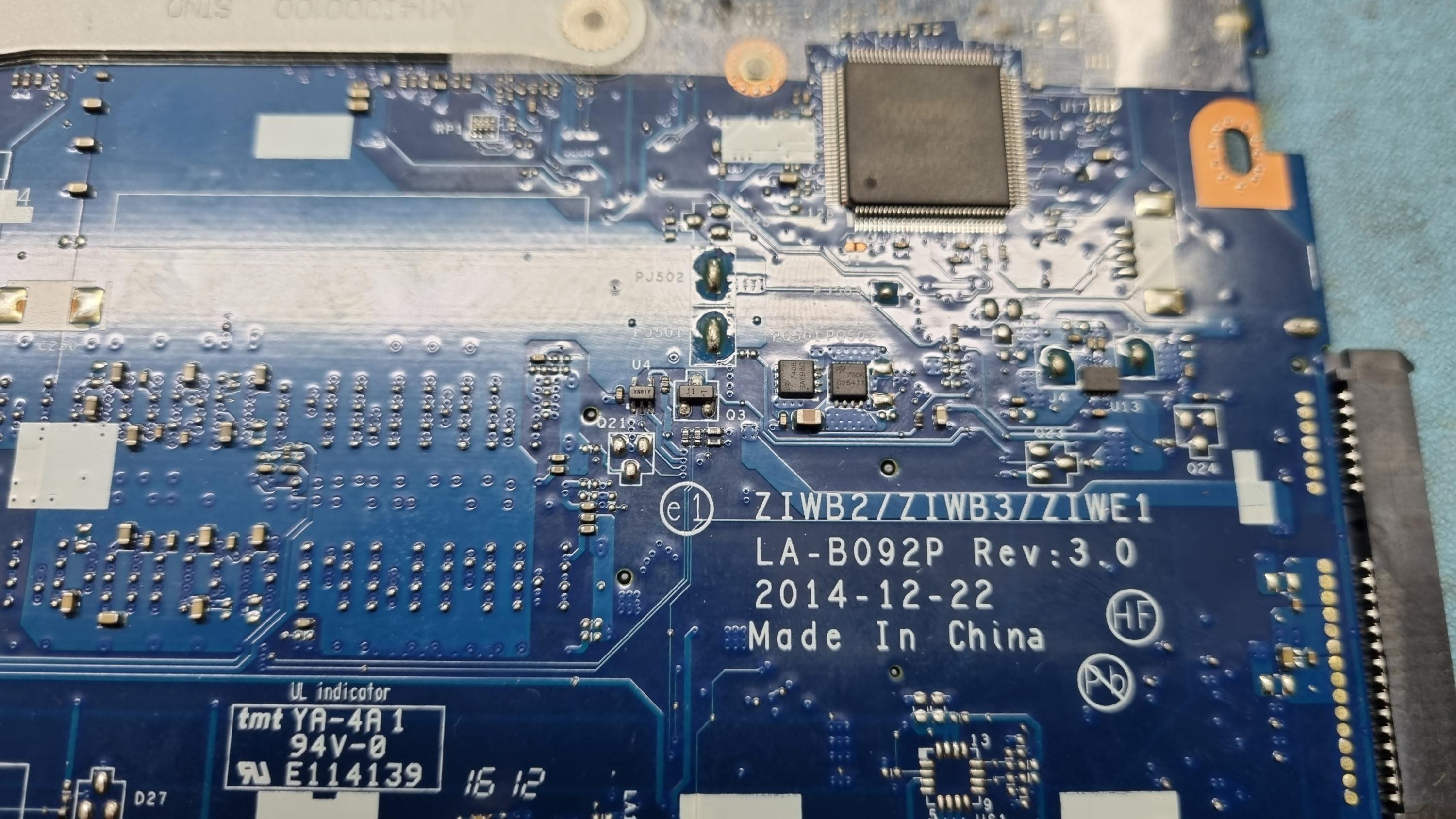

          Thanks for the BIOS file, unfortunately it made no difference - the laptop still has the same symptoms. The battery charges OK, when I press the start button it goes green, I hear the fan and HDD spin up, then after a couple of seconds the green LED goes out, the HDD clicks then spins down and the fan stops.
          I know that I have 3.3V and 5V stable but Vram, Vcore and the 1.7V rail are powering up then down again
          I'd like to go a bit further with this one, mainly to see if I am better than he previous tech who looked at this but now I am getting into new territory so I have quite a few questions
          1/ Does anyone have a schematic for this board ZIWB2 / ZIWB3 / ZIWE1 LA-8092P Rev 3.0? Most likely I think I would find that the SIO or EC or whatever they call the damn thing these days is causing the power rails to come on then go off again, but it would be nice to check that.
          2/ The SIO is NPCE288NA0DX. This is a programmable device, I found this video showing how to do it
          https://www.youtube.com/watch?v=cpTD-HwqbMQ
          He is using an IR16 programmer. I had a look but I couldn't find any obvious links to buy one of these. Is this what I need or should I be looking at some other device? I currently just have a TL866CS and a CH341A with 1.8V adapter.
          3/ Where do I find the software file? Here?
          4/ Should I be trying to reprogram the original SIO or buying a new one? I can also see cheap Nuvoton 288 adapter boards on this page for RT809F/RT809H so maybe that answers Question 2
          https://www.aliexpress.com/wholesale...chText=npce288
          5/ Should I be looking at other likely causes before considering reprogramming the SIO? I heard Lenovo SIO are prone to having a hole burnt in the but this one looks OK physically
          Hopefully someone can educate me on the above topics.
          TIA
          Rich

            • 21662
            The bios is ok. The schematic has been posted in the schematics requests section https://www.badcaps.net/forum/showth...light=LA-B092P
            For the programmer youve got a choice, Vertyanov JIG,SVOD3 or 4 ,RT809H ,theres some others too but a lot more expensive than those.

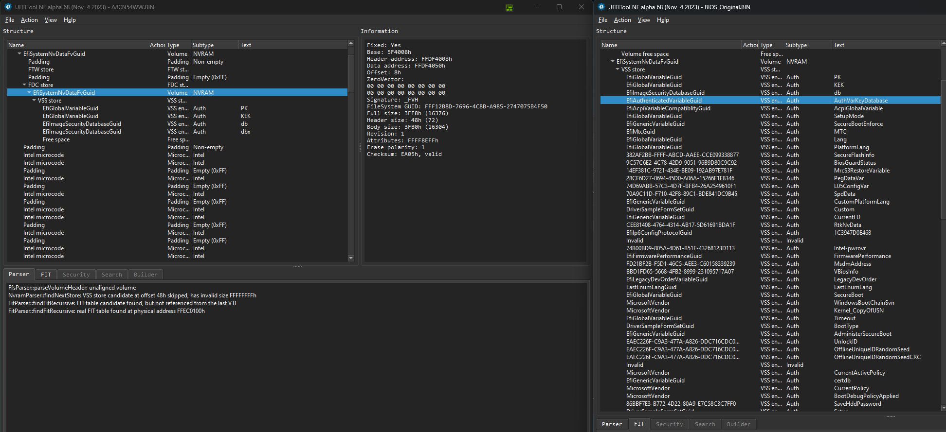

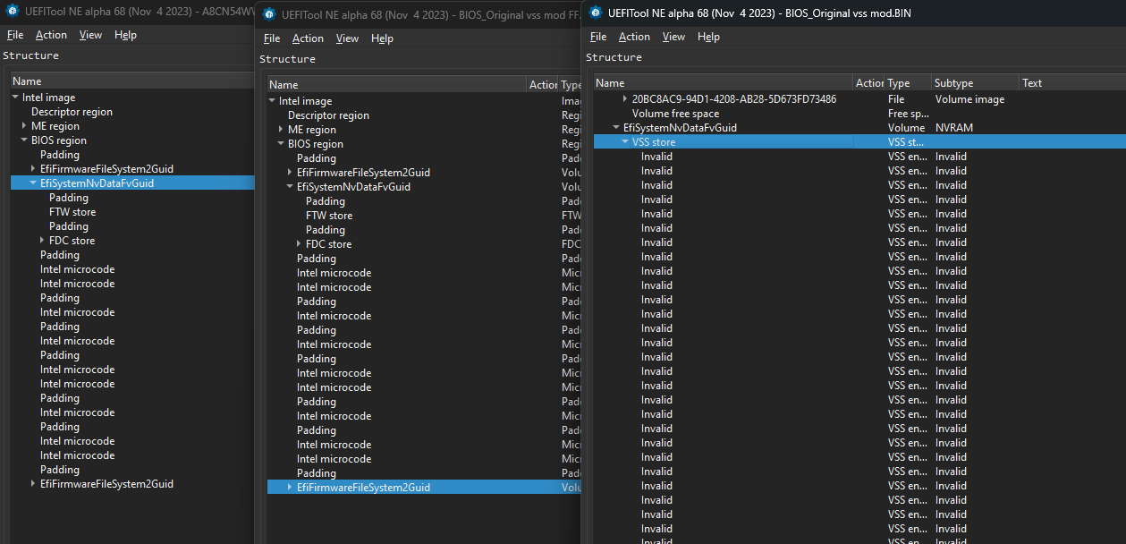

                    If you're brave, you can try this! No idea if it will work for testing.
                    otherwise you would have to disable multiple vss keys to see if one of them disables the password. or it may be stored elsewhere in the padding
                    Compare with smdflea bios ​

                      The Autopatcher doesn`t work with this type of bios (Insyde) , there`s nothing to fix, it`s free and only works on certain models.
                      Bios + DMI attached.
                      • Maxpower3
                        Bad Veteran
                        • Feb 2018
                        • 1319
                        • France
                        Originally posted by SMDFlea
                        The Autopatcher doesn`t work with this type of bios (Insyde) , there`s nothing to fix,.
                        Do you think it could work by invalidating the VSS or with a full FF instead?
                        Click image for larger version  Name:	image.png Views:	0 Size:	78.1 KB ID:	3659653

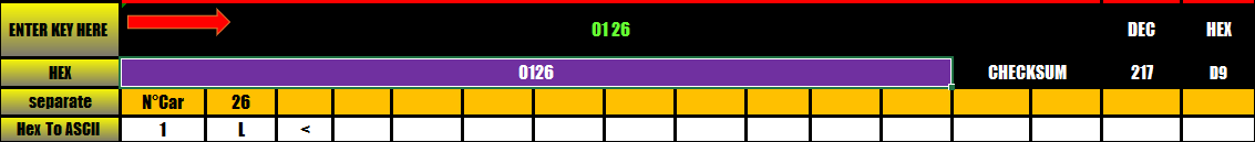

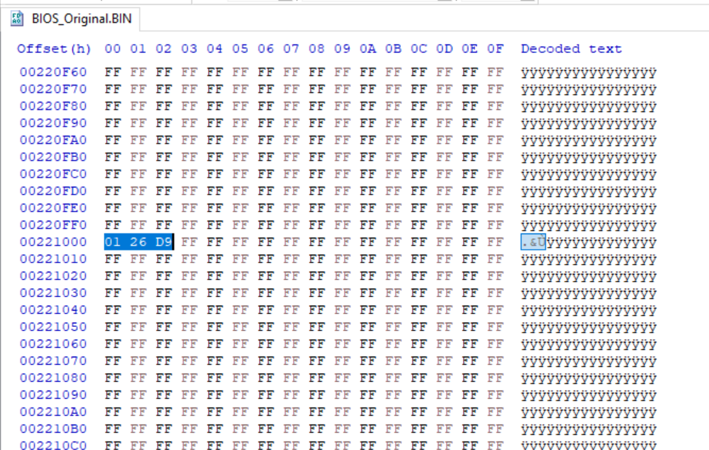

                          Does anyone think the Password could just be "L" letter?
                          all donations are welcome,
                          • Maxpower3
                            Bad Veteran
                            • Feb 2018
                            • 1319
                            • France
                            lol
                            I saw it too but I didn't really believe it.
                            Click image for larger version  Name:	image.png Views:	0 Size:	9.4 KB ID:	3660317
                            I should have trusted the number of characters and the corresponding checksum.
                            In addition, we know it.
                            Finally, I mix everything up by dint of searching.
                            • hardware1
                              • Sep 2021
                              • 2946
                              • N/A
                              lol
                              Yeah, the checksum makes sense. 01+26+D9 = 100h (256)
