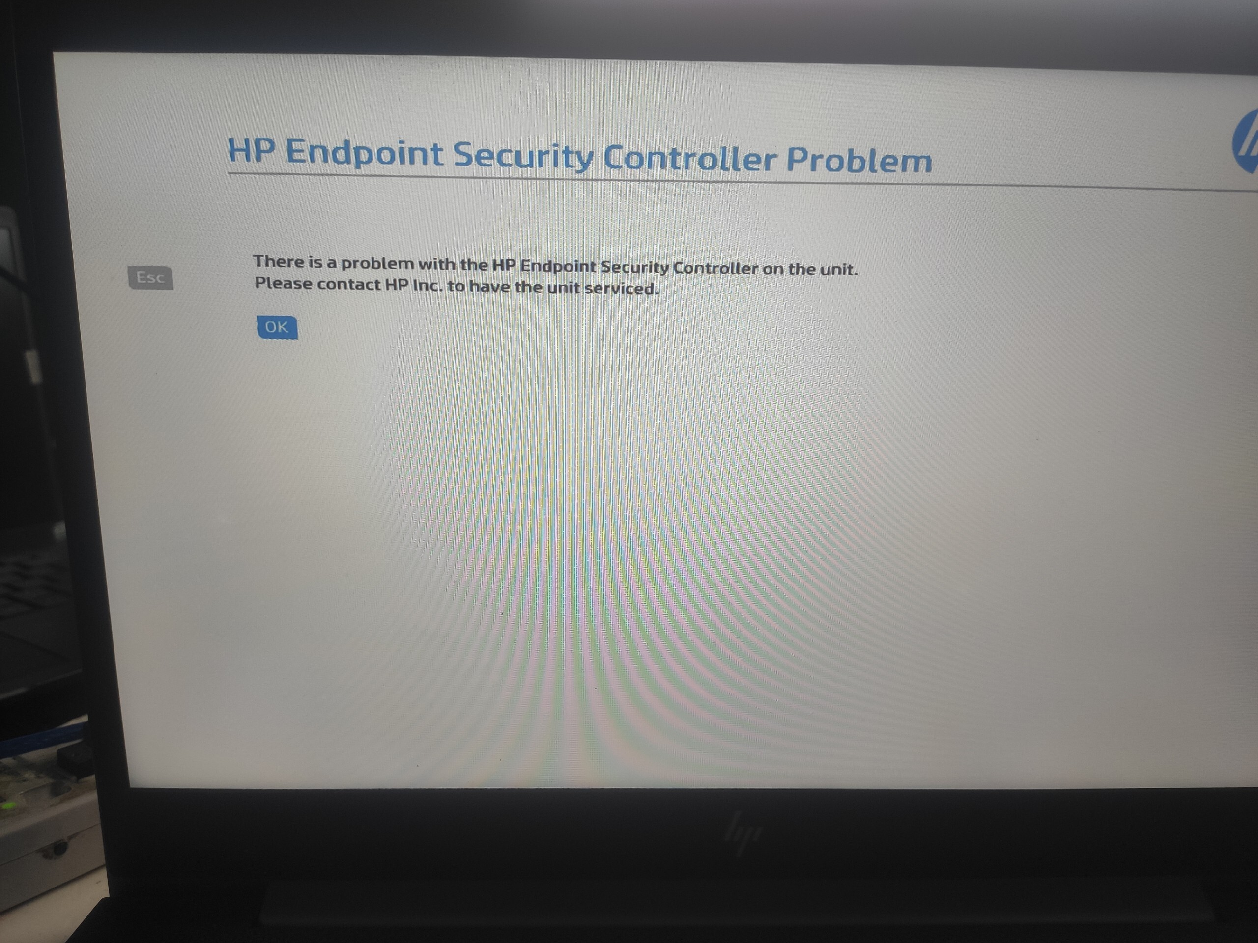

                        Hello, please help me
                        my machine is zbook 14u g6 due to loading a different bios so it is being like this, is there any way to fix it? Thank
                          my machine is zbook 14u g6 due to loading a different bios so it is being like this, is there any way to fix it? Thank [ATTACH=JSON]n3153197[/ATTACH]
                          BIOS and EC files and serial number

                            This is the original bios of the device, the status sometimes turns on and off and has the error like I sent the photo, I hope the masters can fix it.
                            HP ZBOOK 14U G6
                            s/n#:5CG0227827
                              HP ZBOOK 14U G6
                              s/n#:5CG0227827
                              HP ZBook 14u G6 Mobile Workstation
                              • huynguyen.vp
                                • Jun 2020
                                • 33
                                • Viet Nam
                                That bios doesn't turn on, is there another way?
                                • hoaca388
                                  Badcaps
                                  • Jan 2022
                                  • 12330
                                  Impossible
                                  • huynguyen.vp
                                    • Jun 2020
                                    • 33
                                    • Viet Nam
                                    Please help me, it still doesn't work, it still shows this error
