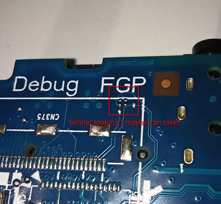

                      Hello, I would need some help with this bios. I have two machines with problems; will start with the first one. I will attach the original bios that I read, it has problems with blinking lights, sadly forgot how many but looked like bios issue so I tried to flash from post #17 here, and when I turn it on I get 7 blinks from caps lock, when I plug in the usb c charger the white charger led is on and then once I get a 6 blinks of orange. For the previous person with 7 blinks you said to check hardware; what should I check? I have plugged everything in except battery, ssd and wifi card; the laptop should work without those?
                      HP ZBook 14u G6
                      PID: 6TP69EA
                      SN: 5CG9507MX2
                      BID: 19WWCFBT601#SAK8#DAK8
                      MOBO: 6050A3022501-MB-A01(A1)
                      Thanks in advance!

                        #52

                        yes it works without them you just need the motherboard and the ram memory..of course and the display...
                        • Philip2809
                          • Apr 2025
                          • 3
                          • Sweden
                          #53
                          Yes, those I had plugged in, but sadly I am getting the 7 blinks. I wanted to try the other bios files here but accidentally knocked one of the small black things (i think resistor) to the side and when I tried to place it back I accidentally lost it and cannot find it; does anyone has a boardview/schematic where I can find the value of it of it is possible to bridge it, or maybe take one from somewhere else on the board? It looked like there was similar ones at the debug pins.
                          • peste
                            • Dec 2016
                            • 13377
                            • ROMANIA

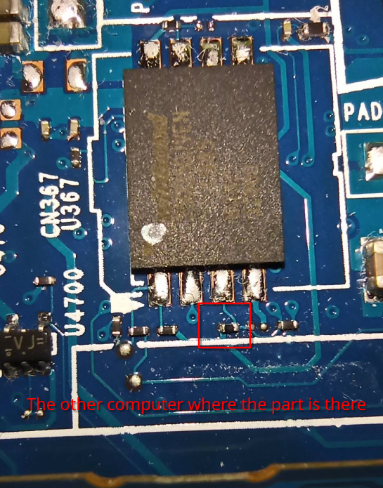

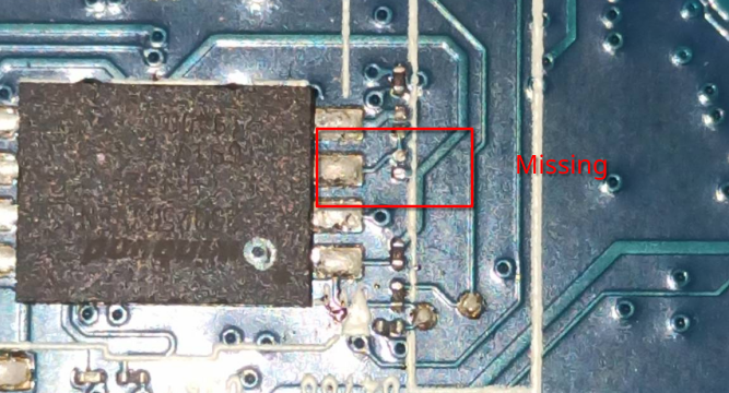

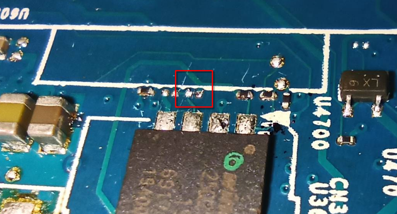

                            #54
                            post a clear picture of the region on the board where the pieces jumped out so we can see..
                            • Philip2809
                              • Apr 2025
                              • 3
                              • Sweden
                              #55

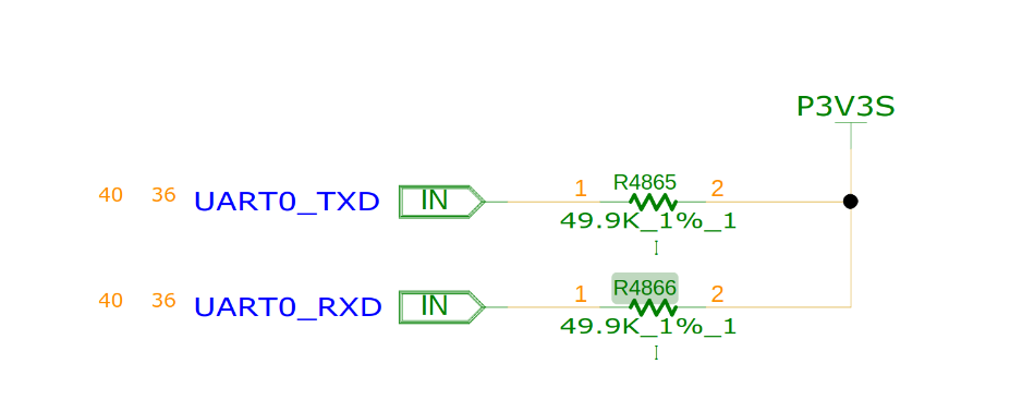

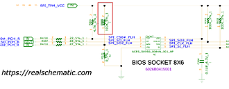

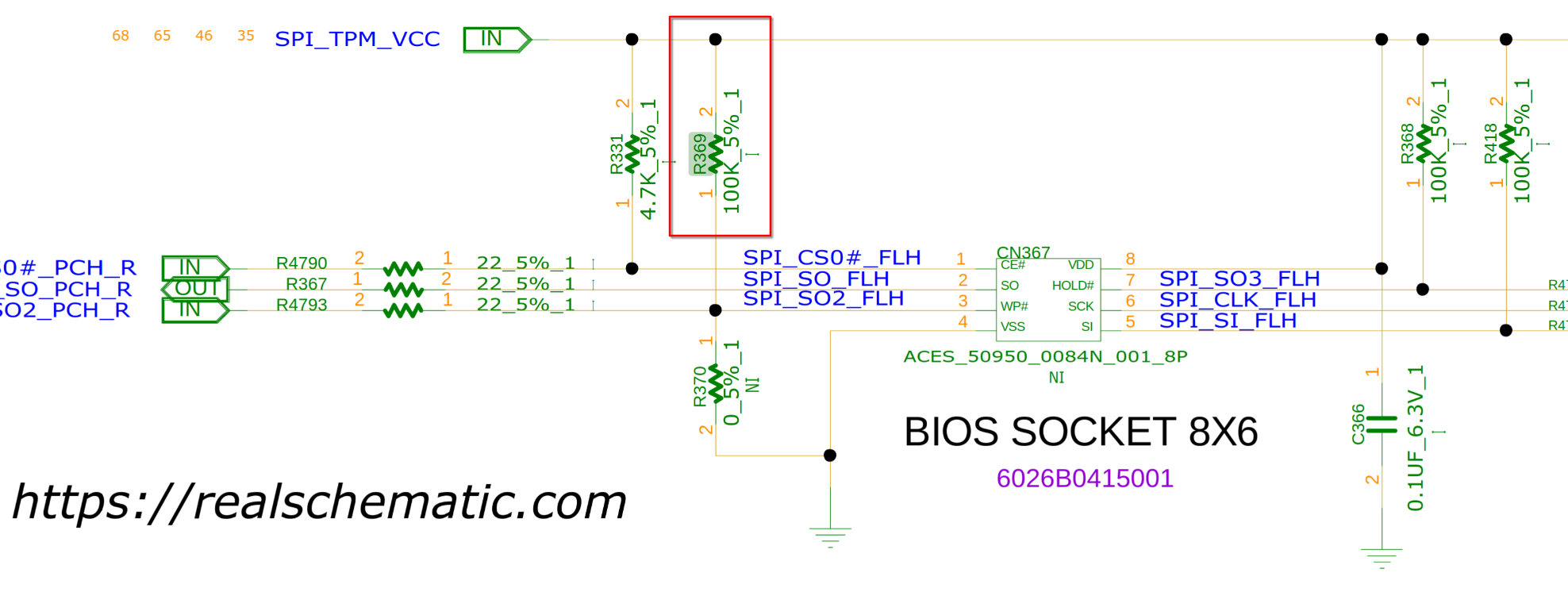

                              Click image for larger version  Name:	missing1.png Views:	0 Size:	443.9 KB ID:	3723615 Click image for larger version  Name:	missing2.png Views:	0 Size:	523.7 KB ID:	3723616
                              Yes, attached pictures of what I accidentally lost; and how it should look based on the other same laptop I have.
                              How it should look:
                              Click image for larger version  Name:	correct.png Views:	0 Size:	676.6 KB ID:	3723614
                              Similar ones at debug port?
                              Click image for larger version  Name:	debug-similar.png Views:	0 Size:	583.1 KB ID:	3723613
                              Got schematic from here:
                              https://www.badcaps.net/forum/troubl...itebook-840-g6
                              The board number matches even tho they say elitebook 840, hp reusing same board with different cpu etc?
                              Anyway it looks to be R369 in the boardview, but I havnt found it in the schematic pdf yet.
                              Thank for all the help once again!
                              edit: found it:
                              Click image for larger version  Name:	image.png Views:	0 Size:	204.0 KB ID:	3723619
                              edit2: also found the debug ones; R4866 however they are 50k, the one I removed looked to be 100k
