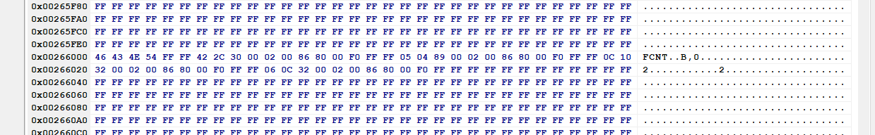

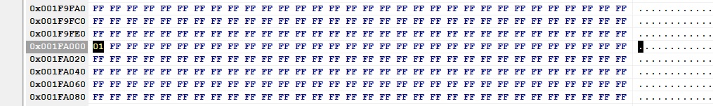

                Interesting. Programming fails because of one address, 0x001FA000.
                I think this means the BIOS chip is faulty. That would also explain the issues with the motherboard. I will try to get another chip and reprogram with the BIOS dump, now to hope no other corruption screwed up the dump, but I unfortunately think that's likely...
                Edit: Erasing and rewriting seems to have fixed it. Let's hope it does.

                  Update: Placed bios back on board, still no boot, same symptoms.
                  I decided to read back the bios to see if anything was at least changed on it. It seems it has, which I'm assuming is expected due to the fist boot sequence.
                  I'll transfer back to the original thread. Seems BIOS is not the issue after all.
