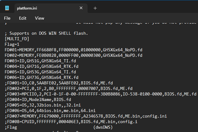

            #85
            Originally posted by hoaca388
            Try all 3, it's so easy to ask.
            bro, thank u very much u are the man, it did work. Now my Nitro 5 is back alive!
            For those wondering which file to use just open platform.ini (after extracting the files from the bios_xxxx.exe file) there u can find what model ur motherboard is.
