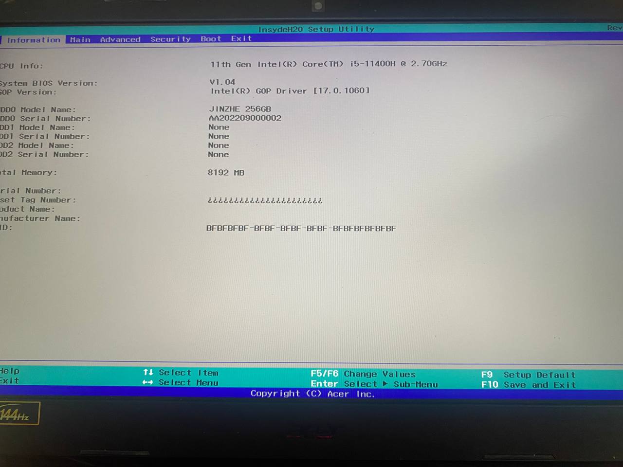

                I need original bios La-l181p Rev B
                Hi everyone. i really need the original bios of acer nitro an515-57 la-l181p rev. I have tried some other bios but they don't recognize nvme. only this bios can recognize nvme but the fan is very loud

                    Here's your New BIOS, it's a Virgin BIOS from Acer with your DMI and Windows Key.
                    Serial Number: NHQD9CN0021281AC483400.
                    thank you for help me. after loading your bios. Machine condition seems to be better. but in bios does not show machine information. looks like it lost DMI

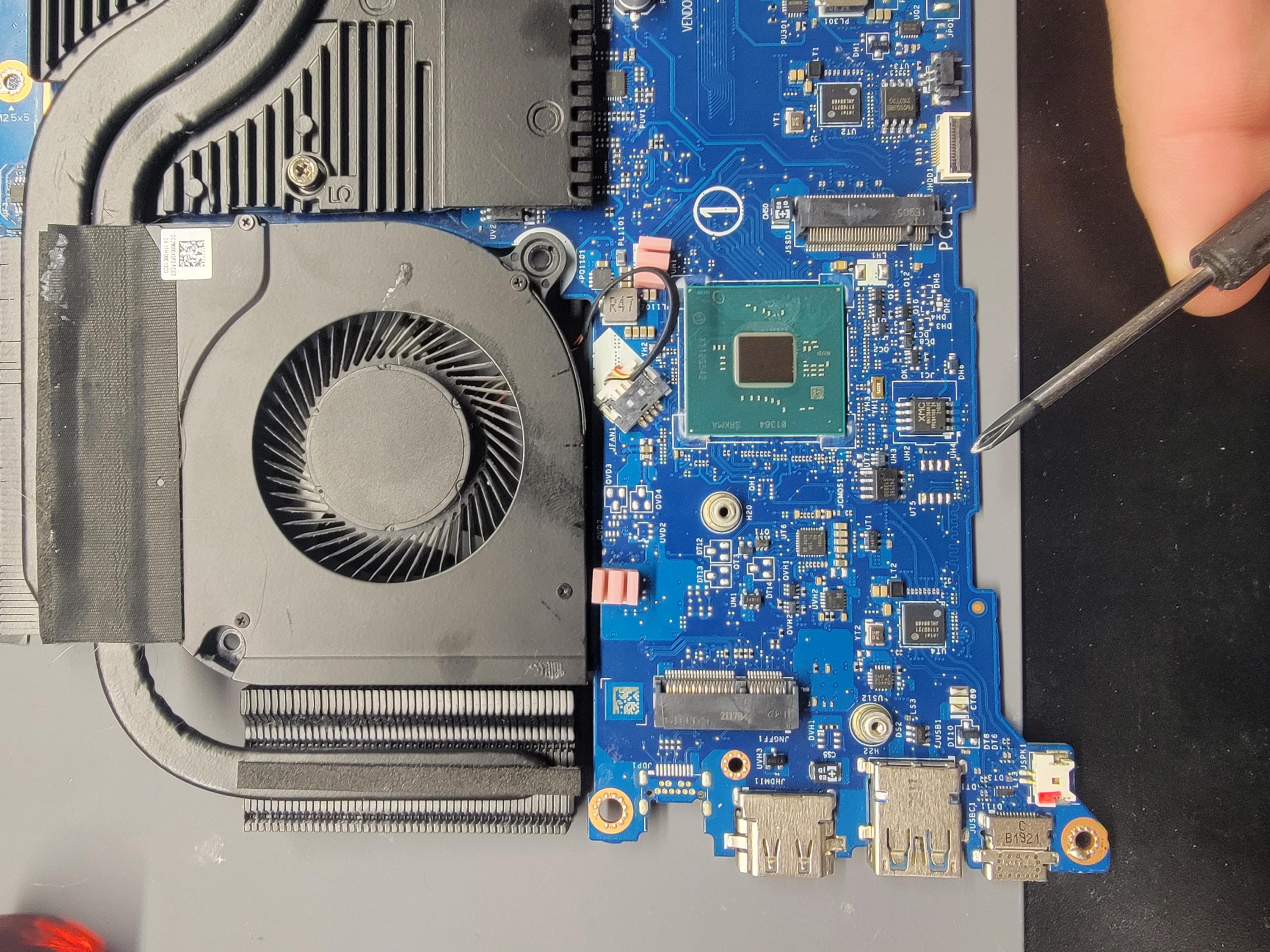

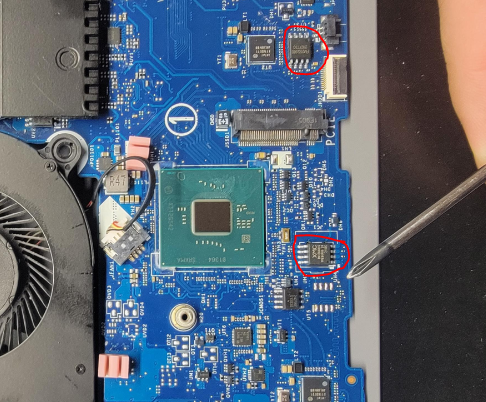

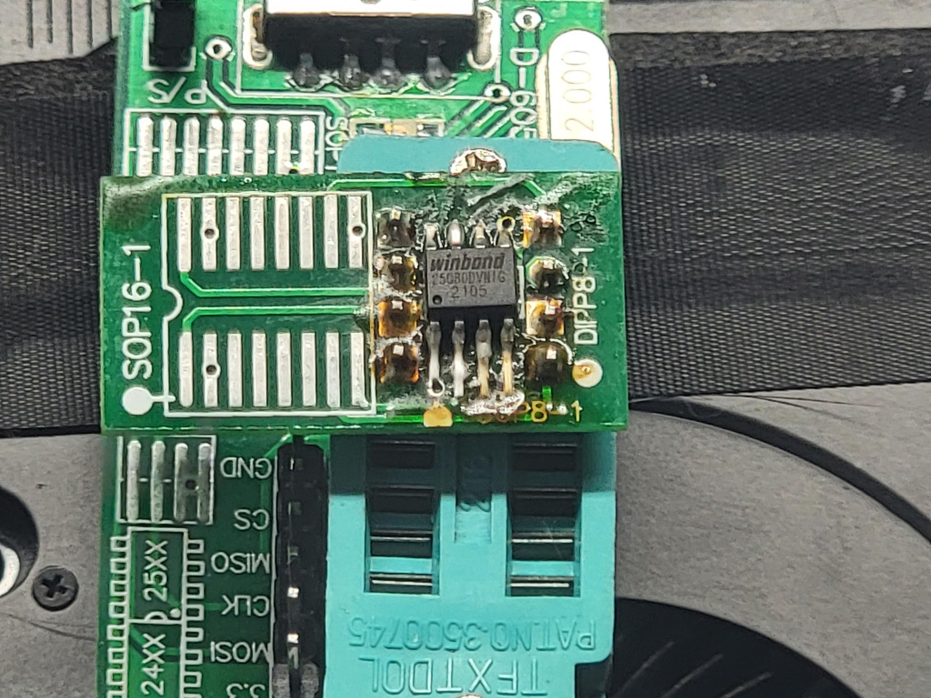

                                  Re: Acer NITRO 5 -AN515-57-536Q need a clean bios
                                  Are there more than one memory chip in the board? The one I removed seems to be a Winbond 25Q80DV, which does show as 1MB / 8Mb on datasheets.
                                  Attached photos of original location + chip.
                                  And yes, my bad, it is a AN515-57.

                                    Yes, the bios chip is different, find it and upload the dump from it here, 25Q80DV is not the right one.
                                      D'oh. Color me stupid. I didn't get the right chip. I apologize folks. I will get the correct one soon.
                                        One of these Chips should be the correct one. Need to see what's written on it, take a closer image.
