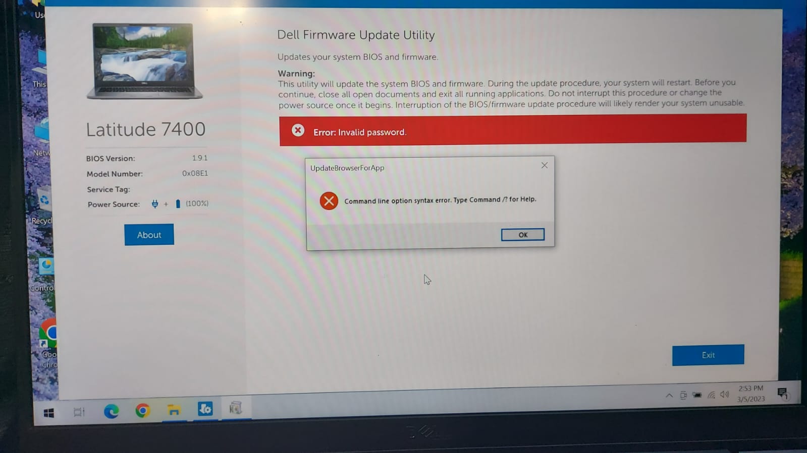

            Vesko, an error occurred during update! I haven't wrote the service tag that had before!
            What you think, what might be the problem?
              The error is shown on the screen - invalid password. You must input the correct (bios) password, or better remove the password, then update the bios. If you like afterwards you can set the admin password again.

                Re: Dell Latitude 7400 EDC40 LA-G871P
                After the Bios Unlock I've asked you if I could update bios version afterwards to the latest one... You said yes there would be no problem and after that I have downloaded the latest one and during update process, it gave me that error! Isn't supposed to be without password?!
                What do you suggest to do?
                  Enter the bios, remove the password if you set any, if you didn't set the password everything should be OK (admin password must be cleared with the unlocked bios), check the Service Tag field - must not be empty, if it is ,the STag must be inputted and saved.
                  At first boot press F2, write the service tag, save & restart. After that at the second boot press Alt+F to exit manufacturing mode. And the fan will slow down.
