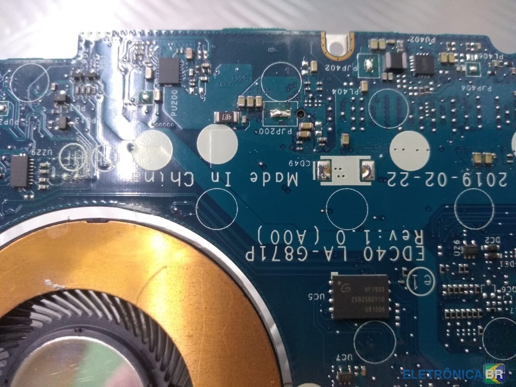

            Hi
            Dell Latitude 7400 S/N 9J9JL33 need bios password removal.
            File size is 16MB
            check the attached locked Bios.
            Thansk in advance

                          would it be possible to send me a picture and locate the bios chipset please .

                            here UC5 big one

                              #174
                              Originally posted by Raziel19935
                              here UC5 big one
                              Thank you for your response.
                              This motherboard indeed contains four EEPROM chips with the following specifications: two 1MB chips, one 16MB chip, and one 8MB chip. The 16MB EEPROM(UC5), which you mentioned is located on the back of the board, is positioned alongside the chipset.
                              UT6 = 1MB
                              UT2 = 1MB
                              UC6 = 16MB
                              UC5 = 8MB
                              There is not any EEPROM with 32MB capacity !!!
                              it make me confuse !
                              Mainboard Model number : EDC40 LA-G871P
                              anyone any idea ?

                                Your laptop configuration is Non vPro ,so it doesn`t have a 32MB chip. You have 8MB and 16MB .

                                  Thanks for your information
                                  is there any solution for this type of motherboard

                                    Read verify and post UC6 = 16MB UC5 = 8MB

                                      *** for those who are stuck on the same device with same chipsets ***
                                      I removed UC5 (8Mb) chip and replace it with 32Mb then I removed the UC6 (16Mb) Chip complately and left the chipset area empty then program the 32Mb chip with bios dump file and BINGO !!! its worked fine
                                      A Bios Program was split into two chipsets But I make it in one chip
                                      Thanks all
