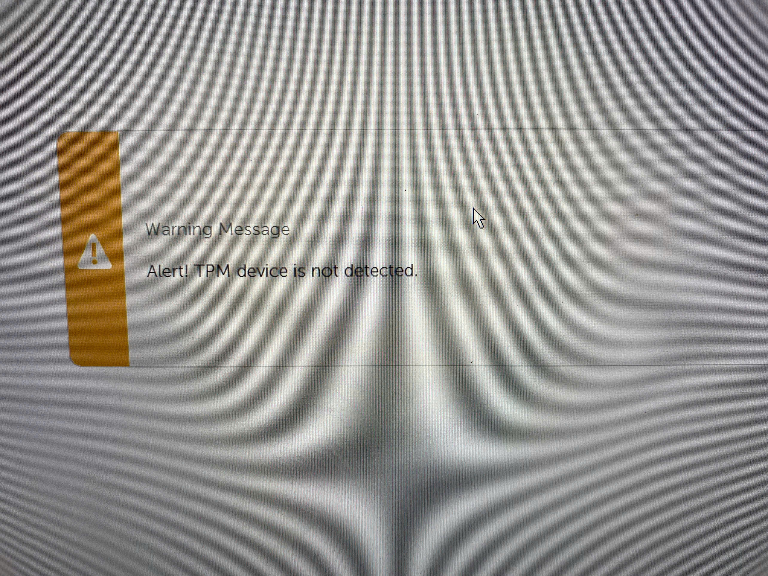

                          thanks bro! bios working but not ssd (nvme)
                          alert tpm device is not detected

                              Hi bro, same old , alert tpm device is not detected
                              • nguyentrieubang
                                • Jul 2024
                                • 13
                                • VIETNAM
                                #156
                                Thanks so much everyone, my ssd died, I replaced it with a new one and it was ok
