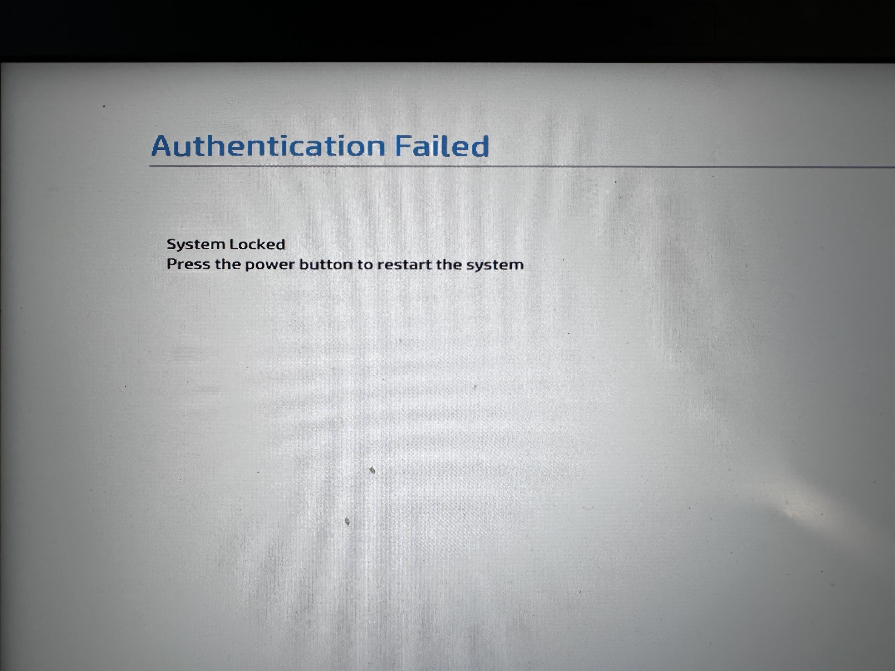

                    #1389
                    Re: HP BIOS unlock tool
                    You should program the 2 Unlocked files together and follow the steps that I said before.
                    i did this procedure. now, when i'm trying to enter bios setup, i have a message "system locked".
                    • hardware1
                      • Sep 2021
                      • 2948
                      • N/A
                      #1390
                      You have used the both files together? Post an image for the message.
                      all donations are welcome,

                              #1394
                              ok. just managed to get to this unit. here's pic in attachment. I've flashed both chips: 16mb modified with the tool, and 32mb modified by you.
