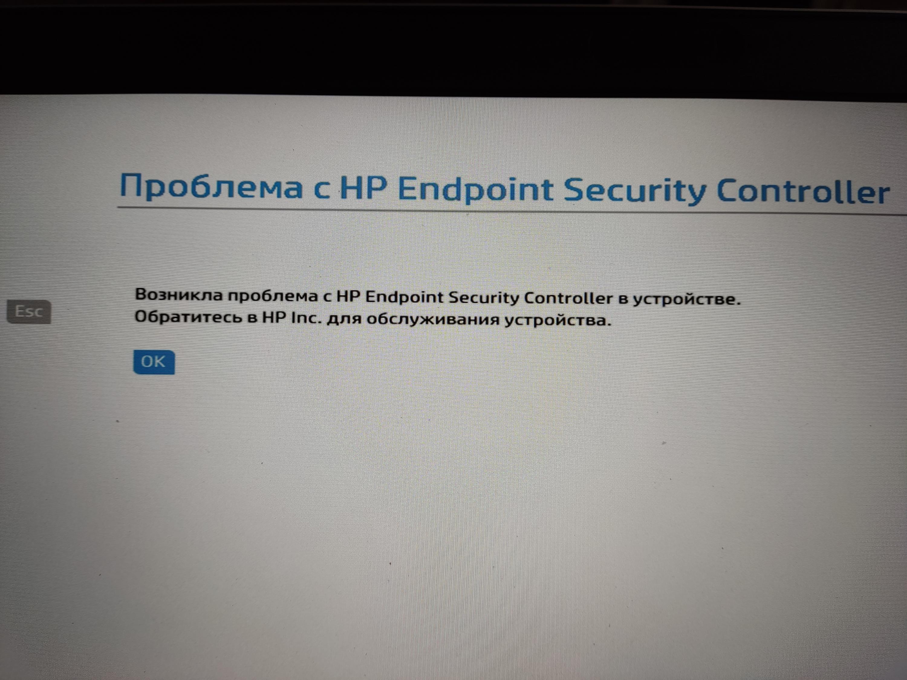

                          thanks i found it but when using issi chip unlock not working and get always hp endpoint security error

                            #1073
                            Re: HP BIOS unlock tool
                            do u have any solution for that
                              Hello!
                              hp endpoint security controller problem.
                              You can fix it. Thanks!
