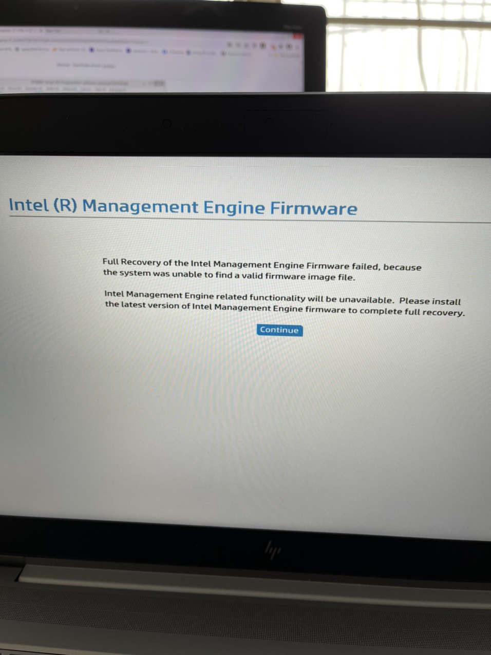

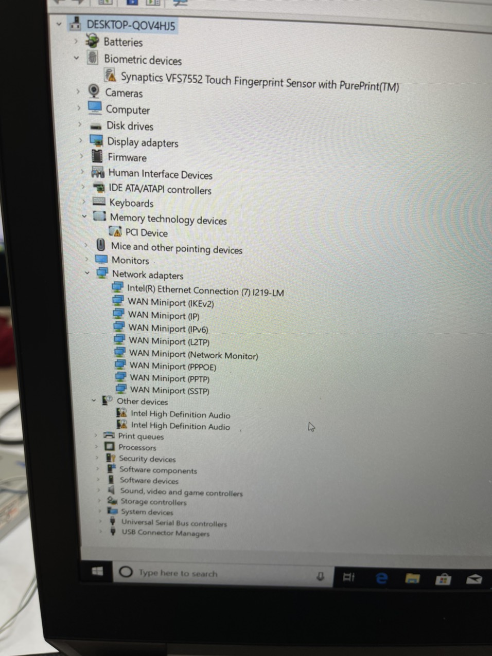

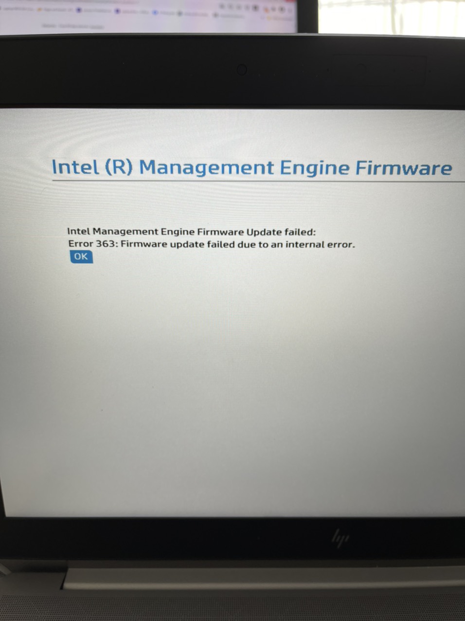

              #706
              Re: HP BIOS unlock tool
              Originally posted by peste
              try..
              password is remove now!
              but have some problem on post (see picture)
              and wifi not detechted!
              • tiamoface
                • Jan 2019
                • 7
                • United Kingdom
                #707
                Hi Gents,
                Can you help please with HP EliteBook 840 G6 bios password removal?
                Tried to remove and soldered chips back on the motherboard but now just caps lock always on and blank screen.
                Attached 2 original dumps 16mb wson-8 and 32mb.
                Thanks in advance!

                    #709
                    omg that was quick. Thank you mate. is it service bios and it works on each 840 g6 or my original dumps needs to be changed?
