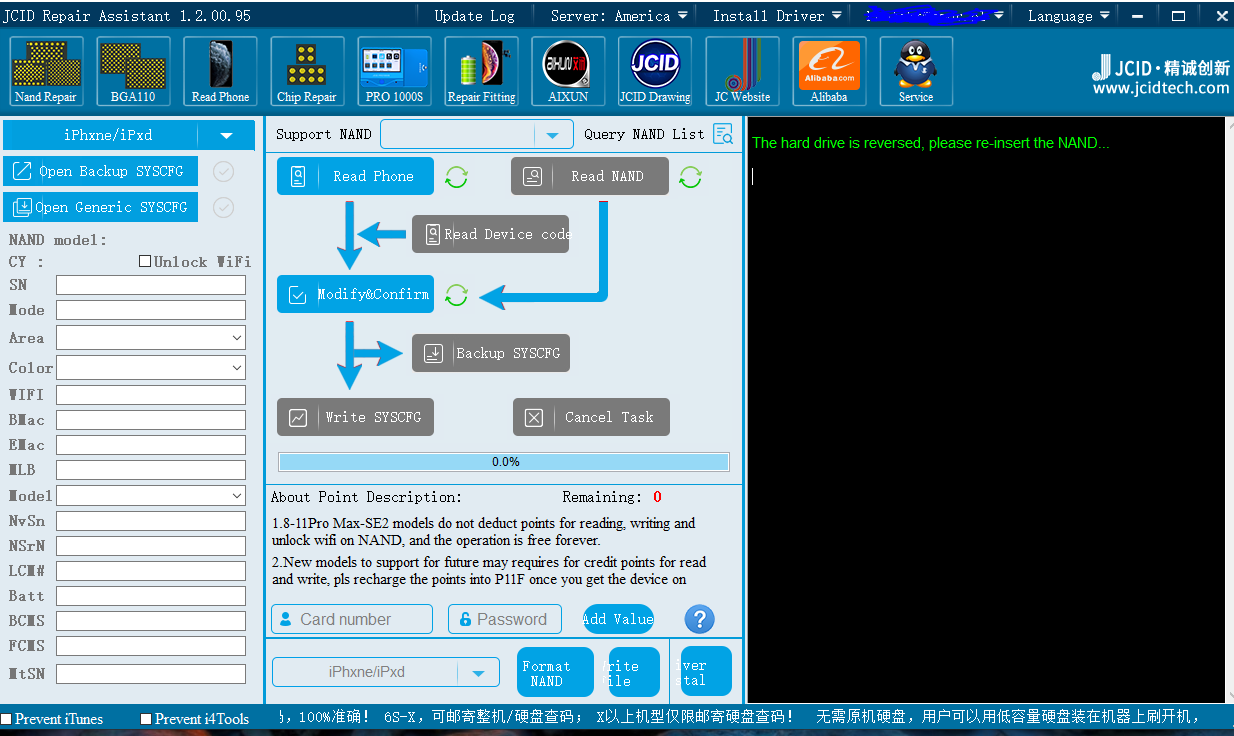

Macbook M1 bypass FMM / EFI Unlock
This topic is closed.
  • ebaymonster
    • Dec 2021
    • 0
    • Ukraine
    #61
    Re: Macbook M1 bypass FMM / EFI Unlock
    I found here interesting information about the structure of files and where theoretically can be what we need.
    • .::iRizwan::.
      Banned
      • Apr 2016
      • 63
      • Pakistan
      #62
      Re: Macbook M1 bypass FMM / EFI Unlock
      Originally posted by bluestone
      How do you get the info from the mac itself? I have A1932. with EFI and Icloud locked but its not erased
      did you manage to jailbreak it?
      • betonel
        • Nov 2015
        • 32
        • romania
        #63
        Re: Macbook M1 bypass FMM / EFI Unlock
        But idea might be good.. On the activation screen I have managed to open log window ( COMMAND + L and other random keys while in startup disk screen.. then I have saved boot log on external usb drive -> attached here)
        Last edited by SMDFlea; 02-15-2022, 01:32 PM.
        • bluestone
          • Jun 2011
          • 343
          • Ghana
          #64
          Re: Macbook M1 bypass FMM / EFI Unlock
          Originally posted by .::iRizwan::.
          did you manage to jailbreak it?
          Mine can jailbreak alright but it's having an EFI password which I can remove with AC2 but that will also update the bridge os which will make activation lock impossible to remove.
          • betonel
            • Nov 2015
            • 32
            • romania
            #65
            Re: Macbook M1 bypass FMM / EFI Unlock
            Originally posted by betonel
            But idea might be good.. On the activation screen I have managed to open log window ( COMMAND + L and other random keys while in startup disk screen.. then I have saved boot log on external usb drive -> attached here)
            There is some guy on youtube showing how he open terminal inside activation window on M1/T2 mac.
            keywords: M1 terminal inside Internet recovery MacOS Monterey
            How is this possible? We need to find key combination, for the moment found way to open log window / save logs to usb.
            • betonel
              • Nov 2015
              • 32
              • romania
              #66
              Re: Macbook M1 bypass FMM / EFI Unlock
              One way for bypass M1 will be patching ipsw file, eg. UniversalMac_11.0.1_20B29_Restore.ipsw\022-10604-034\3_Apple_APFS
              KRAActivationAuthViewController
              Similar work has been successfully performed for iphone:
              1. Download the iPSW file you need from the official website: IPSW.
              2. Secondly, convert the iPSW file into a ZIP file by changing the extension and extract it.
              3. Now open the extracted file folder, and you will see 3 different .dmg files in there.
              4. Look for the biggest file and drag it to your desktop. You will notice that the .dmg files will not be able to open in one click. It’s because these files are encrypted.
              5. You would need a firmware key to open this file. For this purpose, direct to “The iPhone WiKi” and find your firmware key.
              6. Once you have the key, it’s time to use ???iDecrypt that is already on your Mac. Simply launch the software and open your .dmg file with it.
              7. You will see a warning message on your screen. Simply click on the “OK” button and select your output folder and paste your key for “RootFilesystem."
              8. Now, you need to click on “Decrypt DMG," and when the process is finished, you will see a success message.
              9. Open the iPSW file that is decrypted and go to the Applications folder. Here, you need to delete the “Setup” file.
              10. Then, exit this folder and right-click on your decrypted file and click on “Eject."
              11. When the file is successfully saved, delete the original file and rename the new decrypted file matching the original file. Then, paste this file into the extracted folder again.
              12. The last step is to compress the folder back to the IPSW format.
              • mazoot
                iFixit
                • Jan 2019
                • 41
                • Moldova
                #67
                Re: Macbook M1 bypass FMM / EFI Unlock
                good idea bro! do you manage to bypass on ios 15? On what device did you test that trick?Do you have that FW files for test?
                Last edited by mazoot; 02-17-2022, 02:11 AM.
                Kill the state in yourself and you will be free like a wind...
                • bluestone
                  • Jun 2011
                  • 343
                  • Ghana
                  #68
                  Re: Macbook M1 bypass FMM / EFI Unlock
                  Originally posted by betonel
                  One way for bypass M1 will be patching ipsw file, eg. UniversalMac_11.0.1_20B29_Restore.ipsw\022-10604-034\3_Apple_APFS
                  KRAActivationAuthViewController
                  Do you think this could actually work?
                  Last edited by SMDFlea; 02-18-2022, 04:08 AM.
                  • qava
                    • Jun 2018
                    • 21
                    • Poland
                    #69
                    Re: Macbook M1 bypass FMM / EFI Unlock
                    Originally posted by ebaymonster
                    Steven, do you think it makes sense to solder ssd from a locked macbook to m1 and read it?
                    I take off nand and put to programmer P11 from JC but get only info about encryption date and can't do anything.
                    • qava
                      • Jun 2018
                      • 21
                      • Poland
                      #70
                      Re: Macbook M1 bypass FMM / EFI Unlock
                      Originally posted by qava
                      I take off nand and put to programmer P11 from JC but get only info about encryption date and can't do anything.
                      Originally posted by betonel
                      There is some guy on youtube showing how he open terminal inside activation window on M1/T2 mac.
                      keywords: M1 terminal inside Internet recovery MacOS Monterey
                      How is this possible? We need to find key combination, for the moment found way to open log window / save logs to usb.
                      It's A1706 intel MacBook.
                      • curiositymaster
                        • Apr 2021
                        • 45
                        • Nigeria
                        #71
                        Re: Macbook M1 bypass FMM / EFI Unlock
                        Originally posted by qava
                        It's A1706 intel MacBook.
                        We're not talking about A1706 Macbooks here, you don't need to take off NAND to unlock that one.
                        • qava
                          • Jun 2018
                          • 21
                          • Poland
                          #72
                          Re: Macbook M1 bypass FMM / EFI Unlock
                          Originally posted by curiositymaster
                          We're not talking about A1706 Macbooks here, you don't need to take off NAND to unlock that one.
                          I don't talk about Unlock A1706 m8.
                          Read my post again.
                          Betonel write:
                          Originally posted by betonel
                          There is some guy on youtube showing how he open terminal inside activation window on M1/T2 mac.
                          keywords: M1 terminal inside Internet recovery MacOS Monterey
                          How is this possible? We need to find key combination, for the moment found way to open log window / save logs to usb.
                          So I go to YouTube use keywords and video shows A1706 MacBook A1706 - not M1.
                          Also:
                          Originally posted by betonel
                          What if you remove nand and run diagnostic mode, I guess you will be able to see SN there. Funny will be that SN is generated from bt mac + wifi mac, and we're looking for something that doesn't exist.
                          Need to compare dumps from SOC rom of M1, @Stephen, can you share some? Will upload mine tomorrow.
                          Than I try to check this. So i put the NAND just to check what happend cuz I heve a programmer where can use to for example upgrade NAND in iPhones and iPads. That was only a test to see. After take off NAND from 820-02020-11 got this information:
                          This NAND model does not support generating and burning encrypted data for the time being!
                          T2 - that all Intel MacBook
                          M1 - that ARM MacBook
                          No solution for now.
                          Got one A2338 If someone know anything I can test.
                          • curiositymaster
                            • Apr 2021
                            • 45
                            • Nigeria
                            #73
                            Re: Macbook M1 bypass FMM / EFI Unlock
                            Originally posted by qava
                            I don't talk about Unlock A1706 m8.
                            Read my post again.
                            Can you share the info you got from reading the nand?
                            • qava
                              • Jun 2018
                              • 21
                              • Poland
                              #74
                              Re: Macbook M1 bypass FMM / EFI Unlock
                              Originally posted by curiositymaster
                              Can you share the info you got from reading the nand?
                              Originally posted by qava
                              I don't talk about Unlock A1706 m8.
                              Read my post again.
                              After take off NAND from 820-02020-11 got this information:
                              This NAND model does not support generating and burning encrypted data for the time being!
                              Already write this.
                              • betonel
                                • Nov 2015
                                • 32
                                • romania
                                #75
                                Re: Macbook M1 bypass FMM / EFI Unlock
                                Originally posted by qava
                                I don't talk about Unlock A1706 m8.
                                Read my post again.
                                You don't need to touch encrypted part of NAND. There is a plain clear partition containing SN/BT-MAC/WIFI-MAC. If we have valid pair it's possible to replace and get rid of activation lock. Can your programmer read raw data from NAND chip? Upload it on mega and share it please.
                                Last edited by SMDFlea; 02-18-2022, 05:32 AM.
                                  • 21417
                                  #76
                                  Re: Macbook M1 bypass FMM / EFI Unlock
                                  Originally posted by betonel
                                  You don't need to touch encrypted part of NAND. There is a plain clear partition containing SN/BT-MAC/WIFI-MAC. If we have valid pair it's possible to replace and get rid of activation lock. Can your programmer read raw data from NAND chip? Upload it on mega and share it please.
                                  Files should be posted here,not offsite
                                  • qava
                                    • Jun 2018
                                    • 21
                                    • Poland
                                    #77
                                    Re: Macbook M1 bypass FMM / EFI Unlock
                                    Originally posted by betonel
                                    You don't need to touch encrypted part of NAND. There is a plain clear partition containing SN/BT-MAC/WIFI-MAC. If we have valid pair it's possible to replace and get rid of activation lock. Can your programmer read raw data from NAND chip? Upload it on mega and share it please.
                                    I can't take anything from this NAND. I use P11 programmer from JC and is for iPhone and iPad. But the NAND structure from M1 2020 is same like iPhone 11 pro or iPad Pro 11" that's why i try to read by JC programmer but was fail.
                                    • qava
                                      • Jun 2018
                                      • 21
                                      • Poland
                                      #78
                                      Re: Macbook M1 bypass FMM / EFI Unlock
                                      Ther's 2 NAND and I try only one of them. Today im gonna take off 2nd and put here screenshot.
                                      • curiositymaster
                                        • Apr 2021
                                        • 45
                                        • Nigeria
                                        #79
                                        Re: Macbook M1 bypass FMM / EFI Unlock
                                        Originally posted by qava
                                        Ther's 2 NAND and I try only one of them. Today im gonna take off 2nd and put here screenshot.
                                        That means we don't have a programmer that can read M1 NAND yet?
                                        • qava
                                          • Jun 2018
                                          • 21
                                          • Poland
                                          #80
                                          Re: Macbook M1 bypass FMM / EFI Unlock
                                          2nd NAND says
                                          The hard drive is reversed, please re-insert the NAND...
                                          • tobeend
                                            Bypass mdm macbook m2 ventura
                                            by tobeend
                                            1. RESET MACOS WITH IPSW
                                            a. Power off MacBook, press and hold the power button to enter Recovery
                                            b. Open Disk Utility, remove Macintosh HD
                                            c. Reboot, connect to the network to Activate Mac.
                                            d. Plug the C cord in the first port of the MacBook into the other Mac, then power off the MacBook
                                            d. Hold down the Control (L) + Option (L) + Shift (R) + Power key combination for 10 seconds
                                            e. Release the other keys, but keep holding the Power key for another 10 seconds
                                            f. MacBook is returned to DFU, open Apple Configurator 2 on the other Mac, right-click...
                                            05-26-2023, 07:18 AM
                                          • oxonater
                                            Apple MacBook Pro A2141 16" IC BYPASS
                                            by oxonater
                                            Hi everyone hope all are well
                                            I need a little expert advice on a issue I have and seeing as this forum is full of clever people I thought ask here as you never know.
                                            I recently repaired a logic board 820-01700 which belongs to a 16" 2019 Macbook Pro, however I seem to be missing a component near the T2 Rom chip and is U4730.
                                            The schematics say this chip is (M34128-FCS6_P/T) and it also says there is a bypass for it wondered if anyone come across either the IC or the bypass method.
                                            I suppose it's worth noting googling the part package brings up various...
                                            10-23-2024, 11:21 PM
                                          • keats11
                                            T2 Macbook MDM Unlock by S/N change.
                                            by keats11
                                            I was hoping someone could point me to a tutorial on MDM unlock. Basically, I picked up a Macbook (A1989) from someone which did not have OS installed. The guy said it started software update and but did not finish. Long story short, the touchbar on this device has some kind of a short, so after unplugging it, I was able to install the OS on it, when I found out that it is also MDM locked by his company. I tried changing the serial number on the ROM by only changing a couple of digits of the original serial number. Now after installing the ROM back, the Macbook appears dead = DFU mode. When I...
                                            05-15-2023, 06:46 AM
                                          • envym
                                            MacBook Pro 2018 with Activation Lock
                                            by envym
                                            Hi everyone!
                                            I have a 2018 MacBook Pro (with Sequoia OS) that I've been using for years with no problem. I recently received an M2 MacBook Pro so I'm mostly using it and not the 2018 one, but since a friend of mine needs a computer, I thought I could restore my 2018 and give it brand-new-like to my friend.
                                            I tried using the built-in tool to restore the MacBook (Settings > General > Transfer or restore > Delete) but it got stuck when trying to remove the Find Device configuration (it asked me for the password for my old Apple ID -now I use the same account but...
                                            06-27-2025, 08:54 AM
                                          • Flasman90
                                            Macbook Pro DFU Restore Issues
                                            by Flasman90
                                            I have a 2020 Macbook Pro A2289 and after many attempts managed to get it into DFU mode, using my older 2017 A1706 Macbook Pro (Running Ventura 13.7.8). However, when attempting 'Restore', it fails at step 4 of 4, showing the following error:
                                            - "The operation couldn’t be completed. (AMRestoreErrorDomain error -1 - Failed to handle message type StatusMsg (Generic error)) [AMRestoreErrorDomain – 0xA (10)]
                                            - "The system cannot be restored on this device. Failed to create new state machine for restore [com.apple.MobileDevice.MobileRestore - 0xFB1 (4017)]
                                            08-30-2025, 10:27 AM
