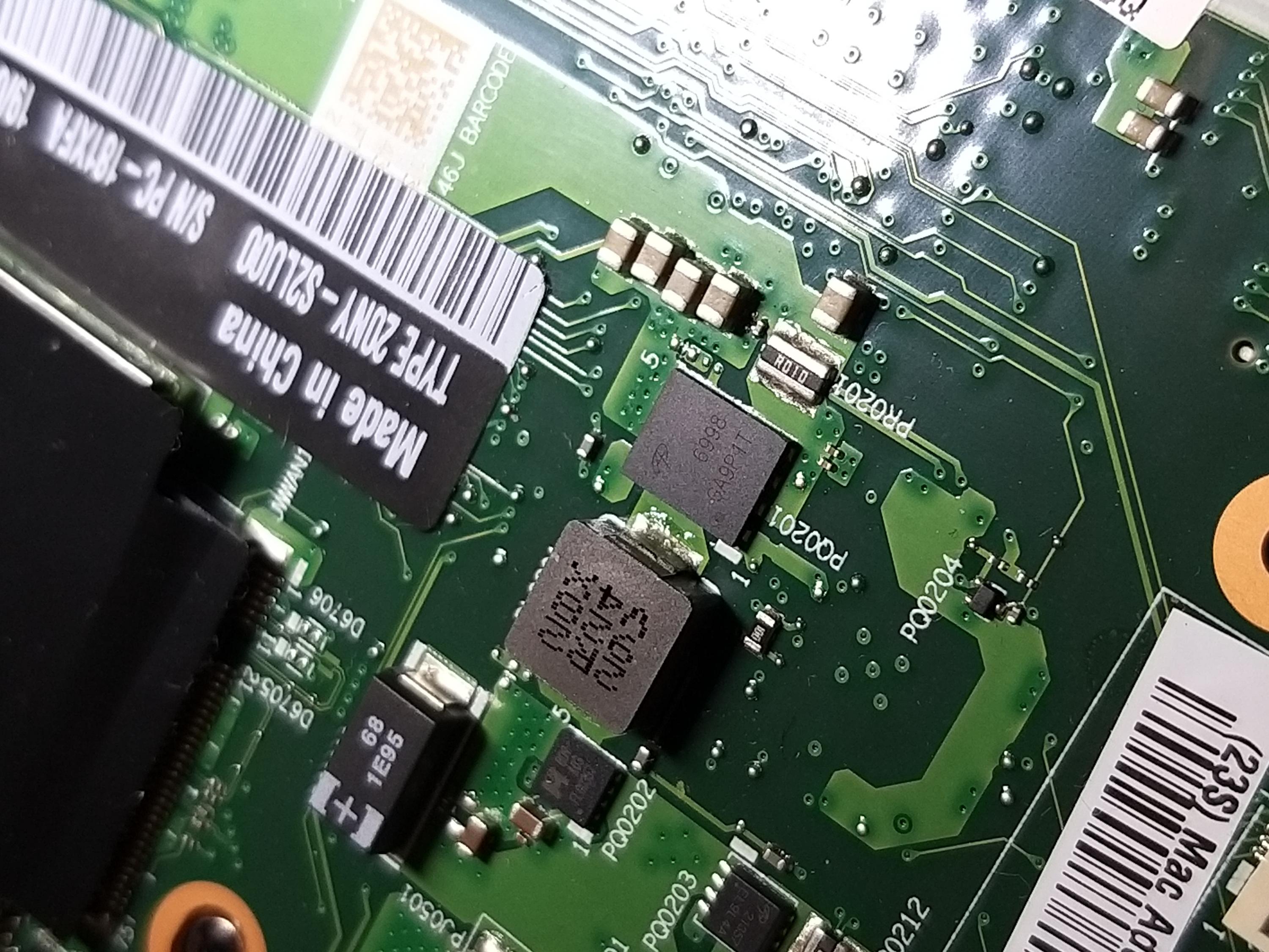

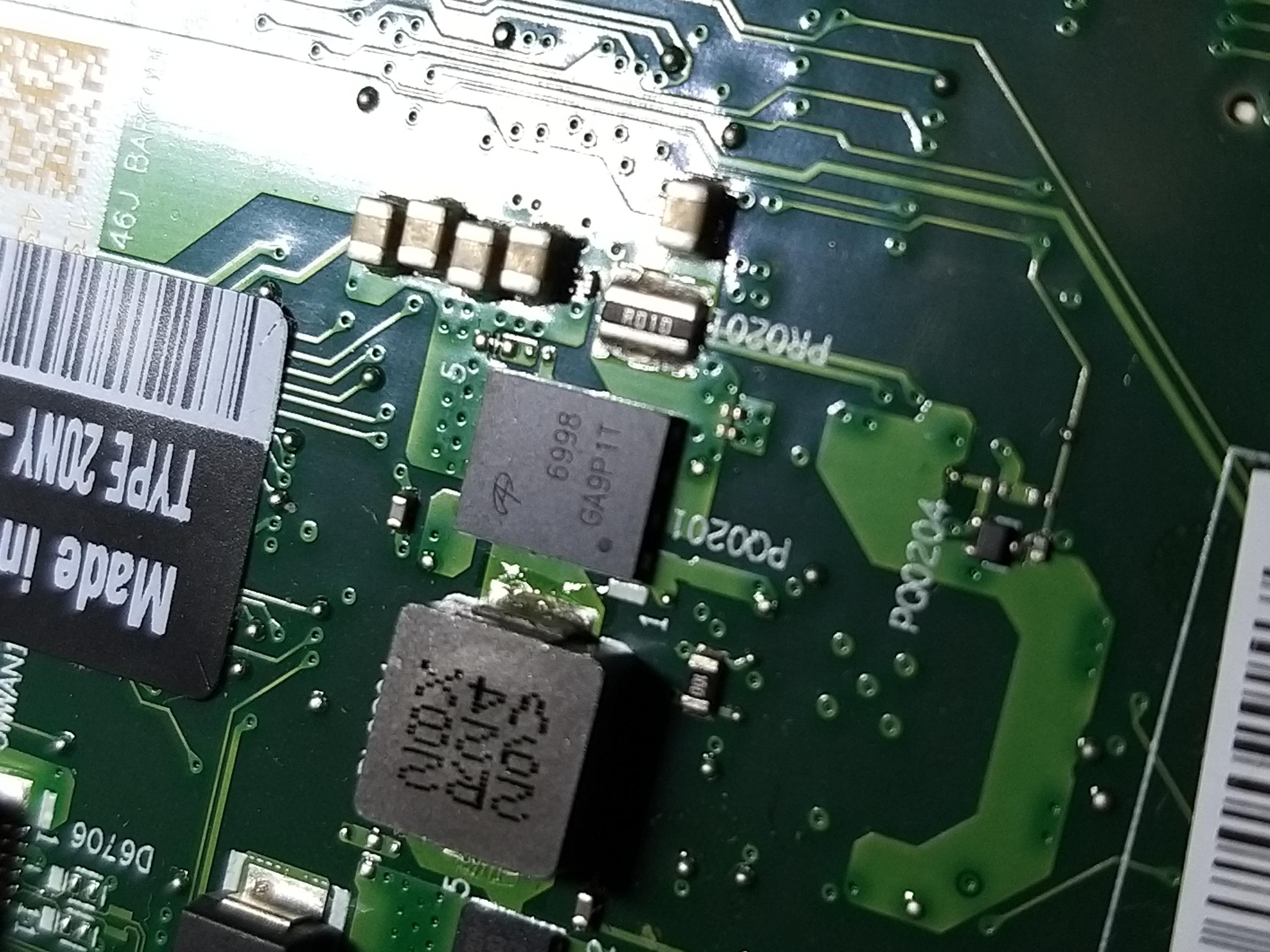

                                Re: Lenovo 490 bios request.
                                Originally posted by vikivng
                                could someone show me where this bios chip is located on this board.?
                                ThinkPad FT491/ FX390 NM-B891 Rev2.0
                                Is this the right chip?
                                  • 21376
                                  No,thats a mosfet. See here https://www.allservice.ro/forum/images/T490s_bios.jpg ,post the part number on top of the chip thats arrowed
