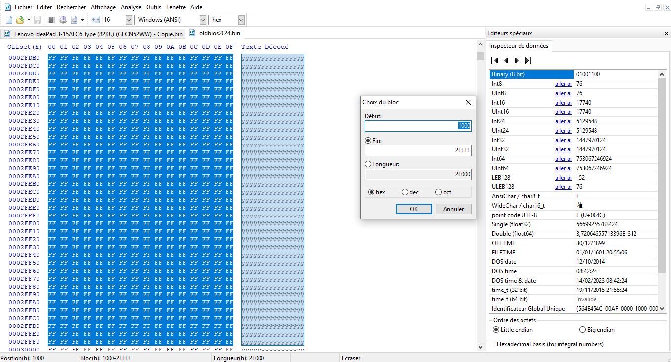

                        Good morning,
                        With hxD, I opened the glcn52 file provided on this site and my oldbios file.
                        I then copied the range from 1000 to 2FFF from my oldbios which I copied and pasted by overwriting on the glcn52 file.
                        I haven't written about the chip yet, but is this the right procedure?
                        THANKS​ Click image for larger version
                          SMDFlea commented
                          Editing a comment
                          In your picture there are 4 F`s in the end-offset , it should be 3 . 1000 to 2FFF
                      • leno2021
                        • Mar 2024
                        • 9
                        • France
                        #78
                        Oops !!!
                        it's a capture that I made after modifying the files, in reality I put 2FFF!!
                        Bravo for the observation!!​
