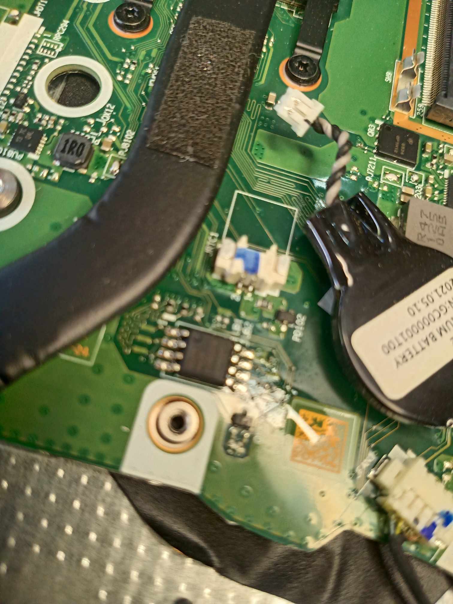

                              SORRY, I COULD NOT FIND MY DMI IN MY ORIGINAL FILE CAN YOU HELP ME PLEASE
                              • hoaca388
                                Badcaps
                                • Jan 2022
                                • 11733
                                #95
                                DMI : 1000h --> 2FFFh

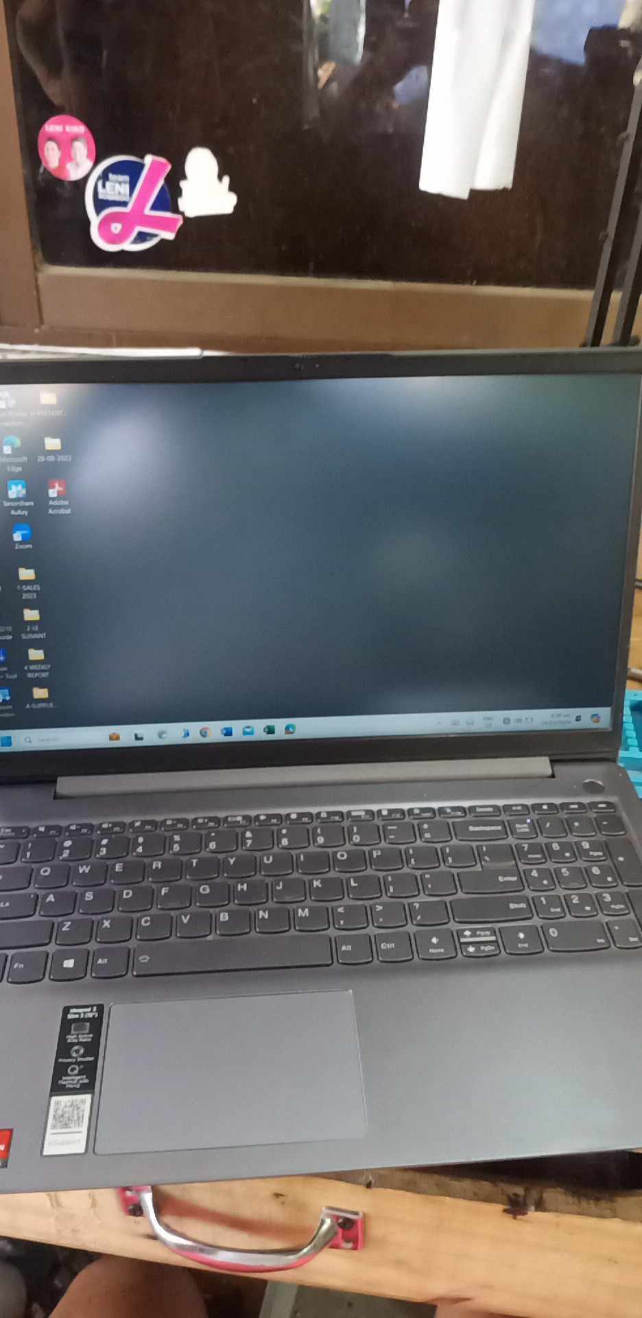

                                  I DID IT, THANK YOU, I HAD TO SEE SOME TUTORIALS I AM NEW TO THE HEXADECIMAL EDITOR​
