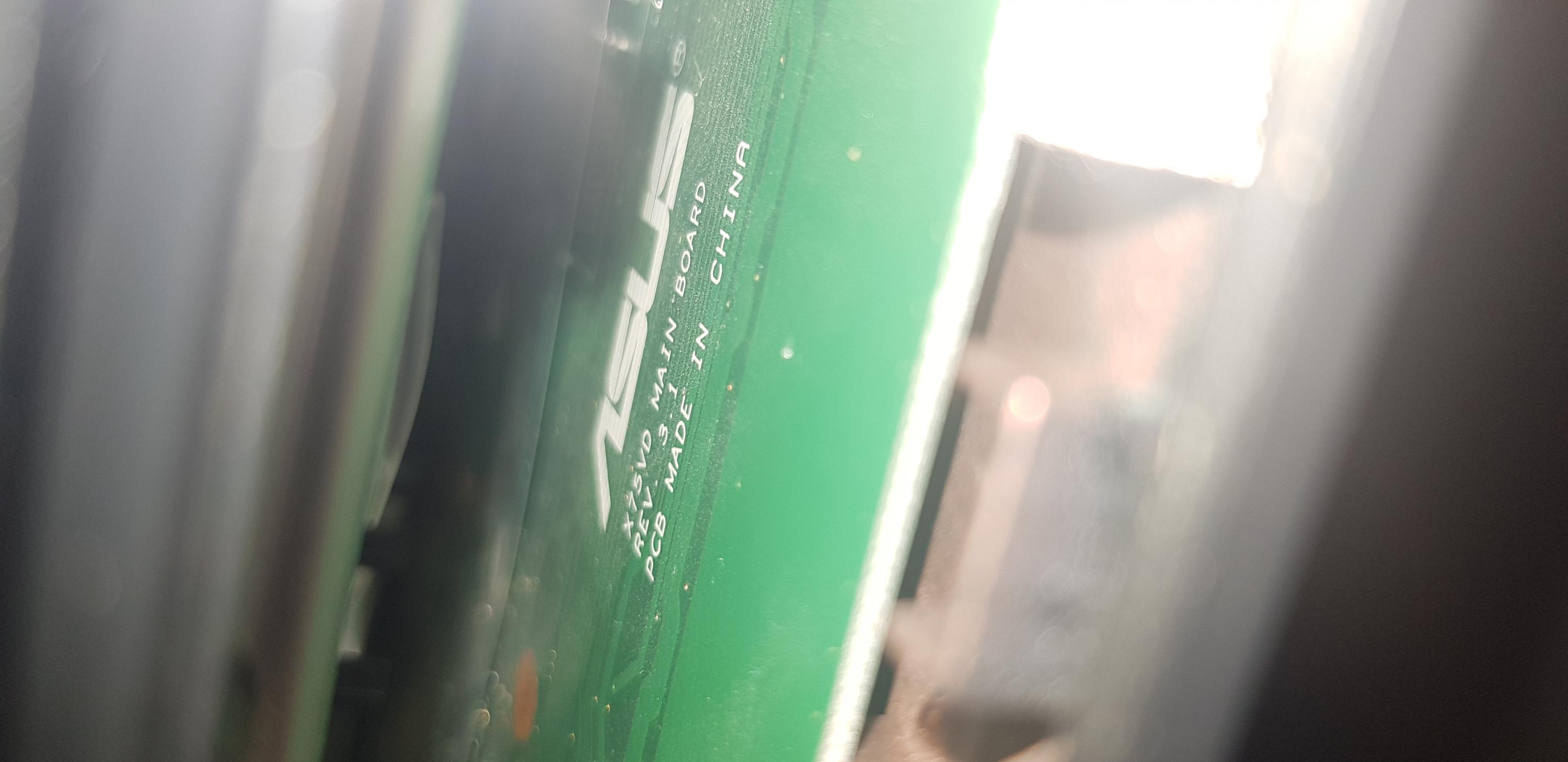

    As the title says. I have a X75VD here, MB revision X75VD Rev3.1, on which I need a BIOS that has a clean ME region.
    I have no access to a SOP8 reader so the best I can totally do is attach two photos. One is the PCB revision, and the other is the barcode sticker on the RAM slots that I was told is needed.
    Hope they are useful for you. If needed, I can also provide the latest BIOS update I could find on ASUS' website, which is X75VDAS.409 - the laptop also had 409 already installed when I got it.
    Any help is much appreciated.

    the bios update is 6,146KB ,it has a capsule header that needs deleting using UEFITool or a hex editor, after that you`re left with a 6MB 6,144KB update,it isn`t the full bios,it doesn`t have the ME firmware.There are some full X75VD dumps here but to write them you will need an SPI programmer.
