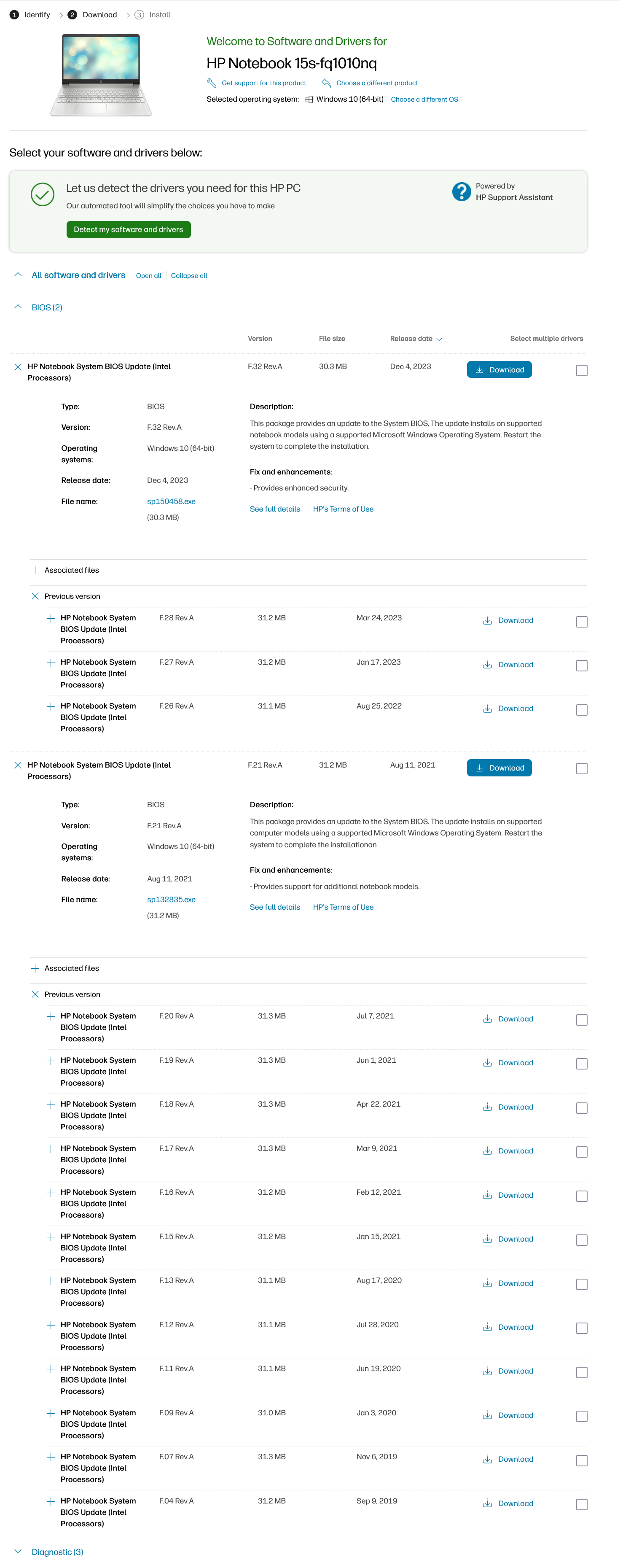

                        hy, please can you help me with a working bios
                        DA0P5DMB8C0 REV C
                        5cd011b614
                        15s-fq1010nq
                        • peste
                          DA0P5DMB8C0 REV C
                          5cd011b614
                          15s-fq1010nq
                          you have everything you need at post #5 and #7...

                            I try , no image on screen . only hdmi . On laptop screen only give few attempts for image

                            That is why i upload the file above, maybe i did something wrong. i put the correct version of BID
                            • Vesko356
                              VIP Moderator
                              • Aug 2018
                              • 4386
                              • Bulgaria 🇧🇬
                              #37
                              First you didn't posted what the problem is with your laptop as per the rules!
                              Second we don't know if you made the new file following the above guides, or just find it here or somewhere else. because you didn't mention it!
                              Third this bios is v. F32, your backup is v. F30 - try to use same (or earlier) version to be sure about the result.
                              Fourth your problem may not be a bios related.
                              Fifth you may programmed or soldered back in place the chip incorrectly, or moved/knocked some surrounding component(s).

                                on hp web site for my model is only F.32 Rev.A and F.21 Rev.A . the F.30 not
                                - the problem i say no image on screen
                                Thanks again. Please delete my posts, i dont want to spam the topic.
                                  Click image for larger version  Name:	Screenshot 2024-01-30 at 16-13-57 HP Notebook 15s-fq1010nq Software and Driver Downloads HP® Support.png Views:	0 Size:	533.4 KB ID:	3207384
                                  It's not clear if this is your initial issue, or after you tried to program the new dump.
                                  Because there's nothing in your first post:
                                  DA0P5DMB8C0 REV C
                                  5cd011b614
                                  15s-fq1010nq
                                  Additionally if you have an image via HDMI, but not on the laptop screen it is NOT a bios but hardware issue.
