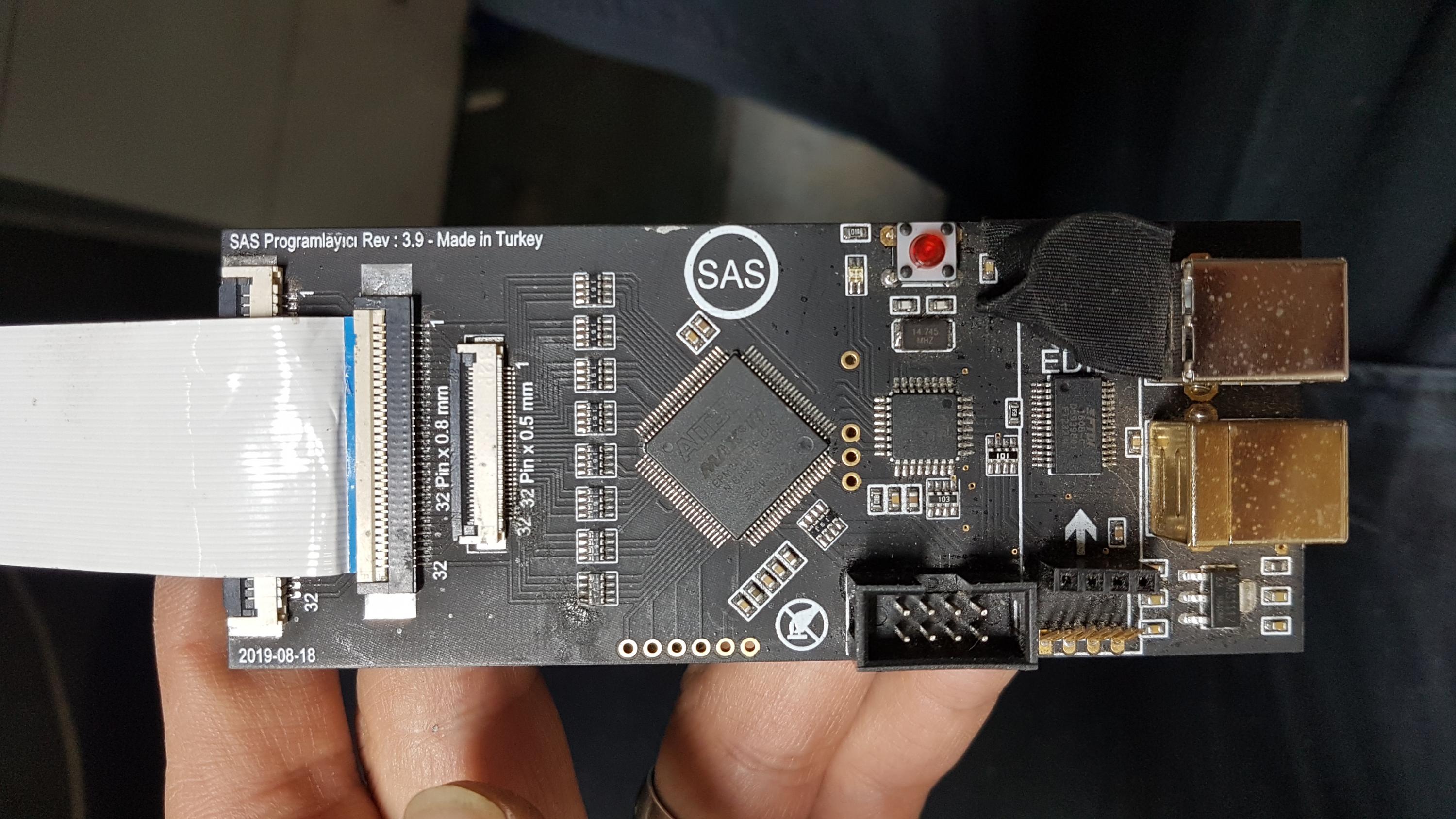

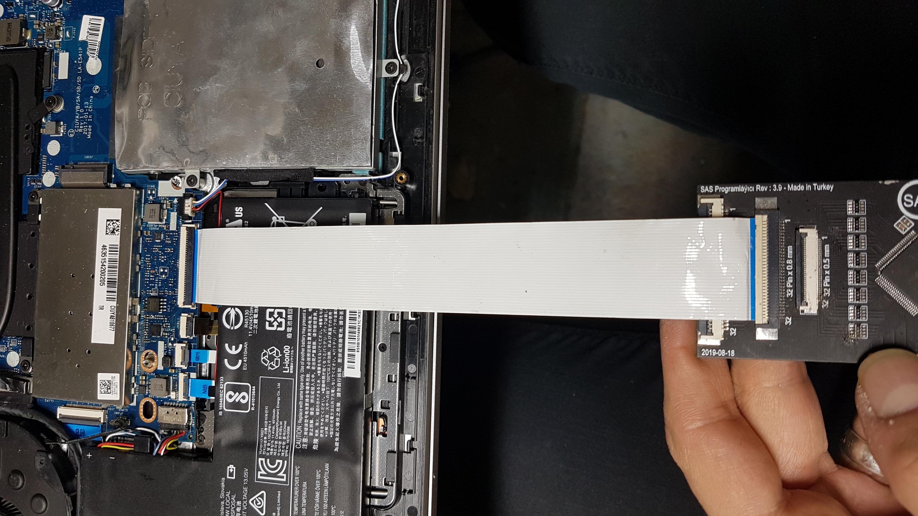

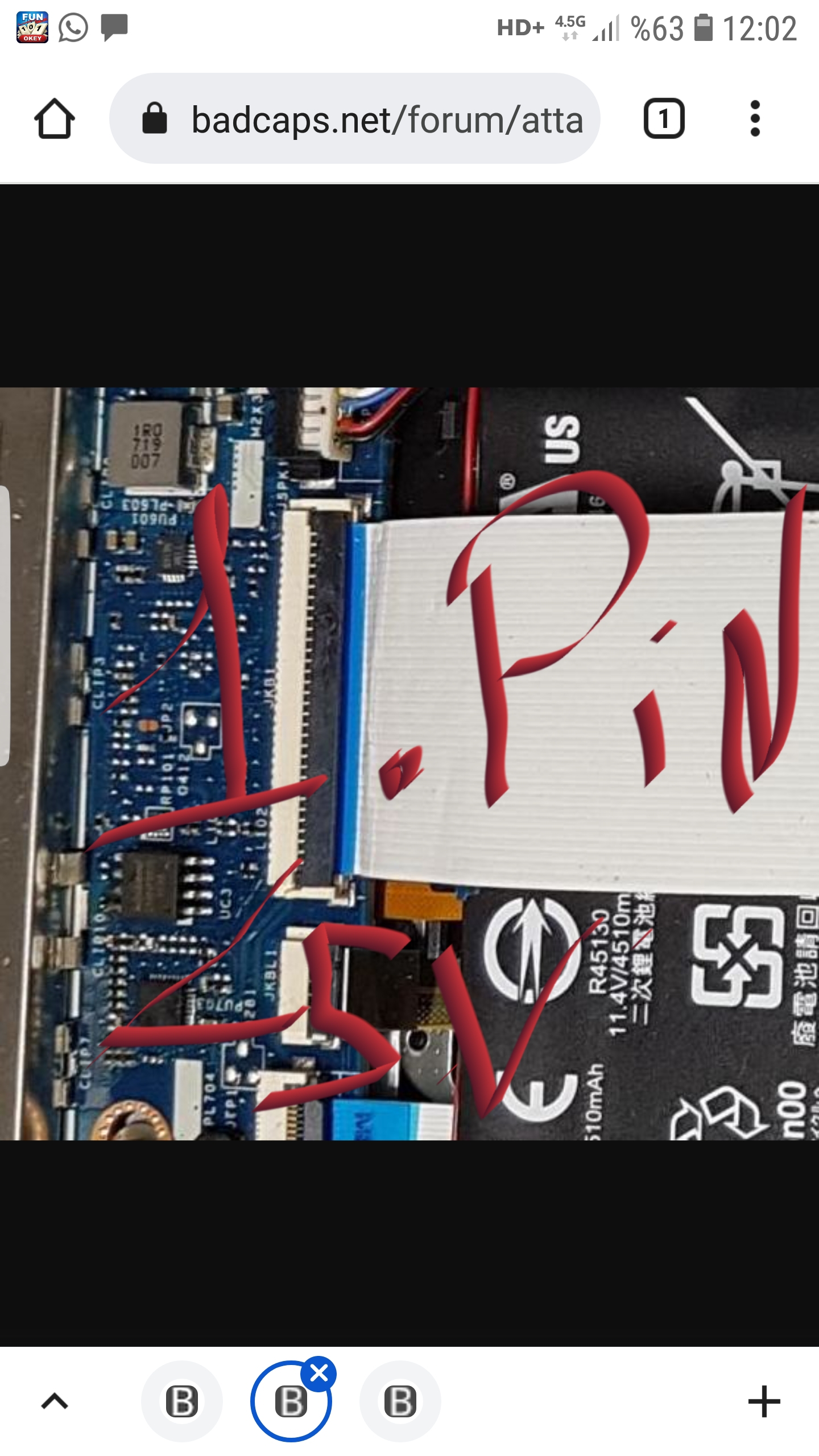

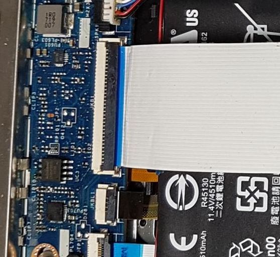

          What model is your programmer, is it a vertyanov clone, is pin 1 of the keyboard connector on the left or right side,are the pins up or down

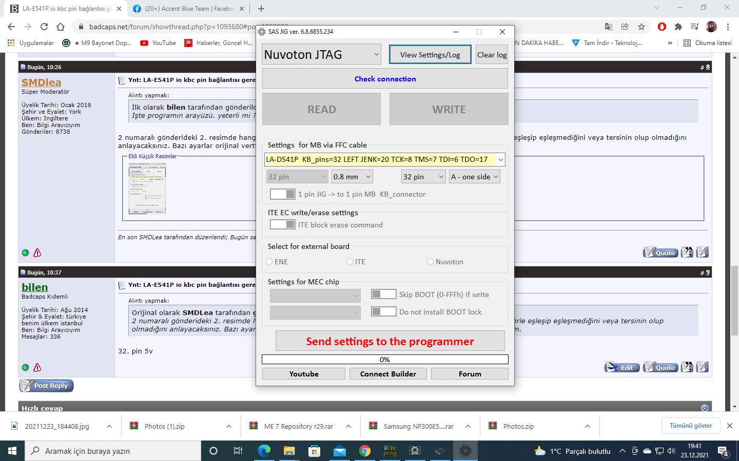

              Here is the program interface. is it enough ?
                • 22278
                Re: Need LA-E541P io kbc pin connection

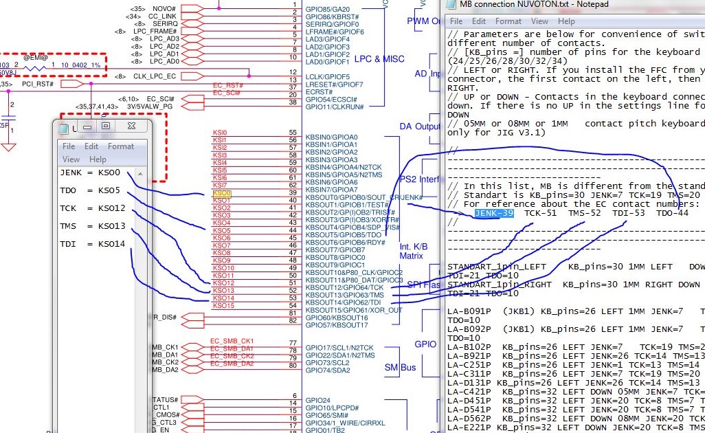

                Check which pin has +5VALW in the 2nd picture at post #2 then you will know if pin 1 matches with both connectors or if its reversed. I can`t help you with the software if some settings are different to the genuine vertyanov .
                  32. pin 5v
                    our device is the same.
                    I just couldn't write the pin connection line properly.

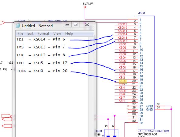

                      • 22278
                      The pictures at post #2 are taken from the LA-E541P schematic.Mark on your picture which pin you have +5VALW on

                          • 22278
                          Try the LA-D451P setting.
                          LA-D451P KB_pins=32 LEFT JENK=20 TCK=8 TMS=7 TDI=6 TDO=17

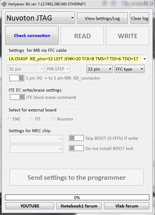

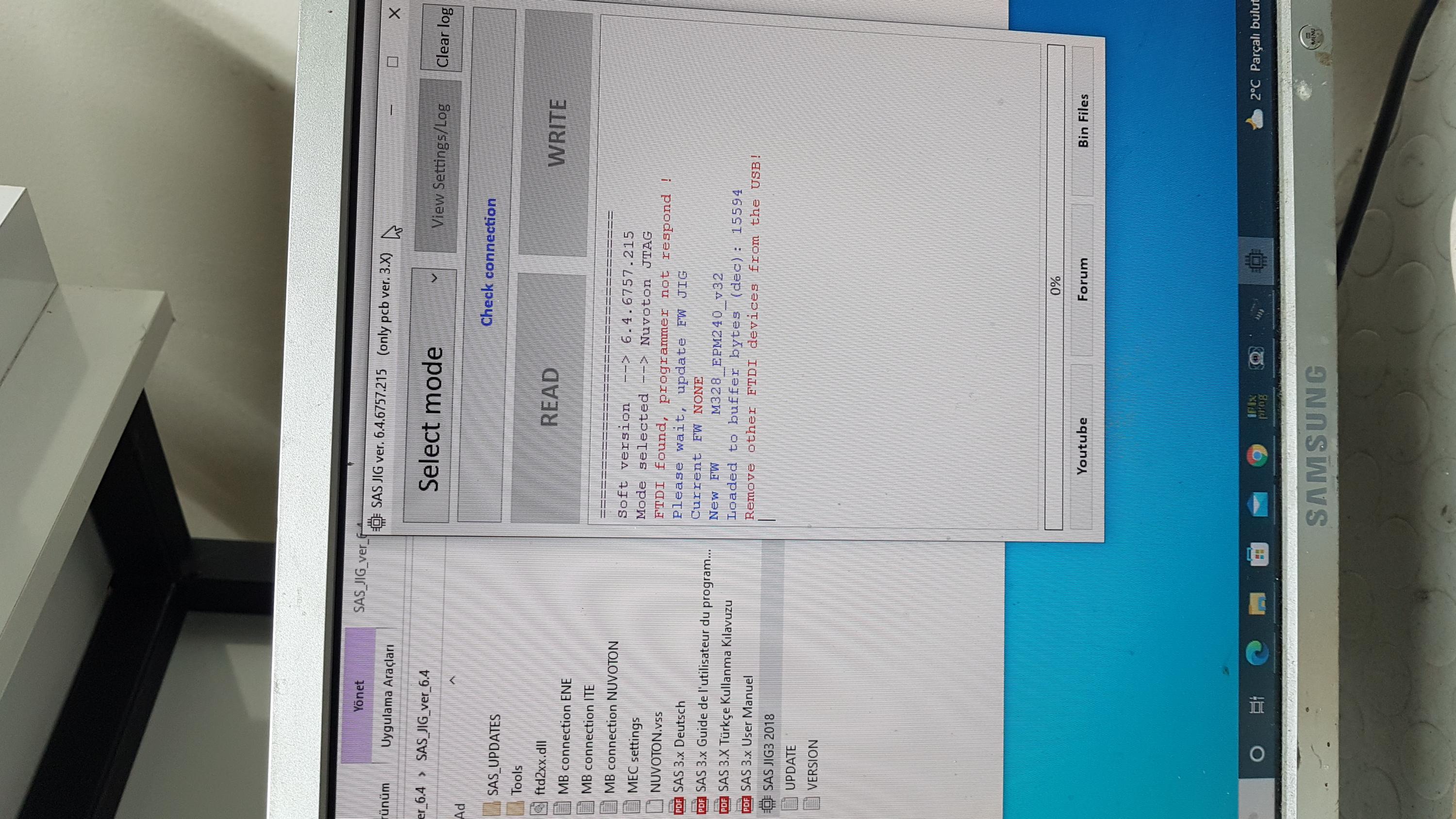

                            LA-E541P
                            NPCE388NA1DX
                            Tried this combination of code:
                            (with 30 pin, one side)
                            LA-E541P KB_pins=32 LEFT 08MM JENK=39 TCK=51 TMS=52 TDI=53 TDO=44
                            But it says:
                            "Invalid settings for Nuvoton MB!"
                            (with Read and Write buttons inactive)
                            But when I push "Check connection" it is likely has a connection with MB:
                            (No any error msg)
                            "FTDI driver version 21236
                            Version FW JIG M328_EPM240_v34
                            2F2F7B916B2DBDF165C3C665"
                            With the given configuration, for example:
                            LA-E451P (JKB1) KB_pins=32 LEFT 08MM JENK=20 TCK=8 TMS=7 TDI=6 TDO=17
                            as you offered above, it gives error:
                            (after connection check)
                            4/12/2023 4:23:19 PM
                            2F2F7B91632DBDF165C3C665
                            Read NUVOTON ID FFFFFFFF
                            Wrong ID. Break.
                            Possible reasons:
                            1 No power is connected to the MB
                            2 No power on a chip EC
                            3 Defective chip EC
                            4 Invalid defined first contact
                            5 Invalid settings for MB
                            How to make active Read and Write buttons with non standart configuration, please advice!
