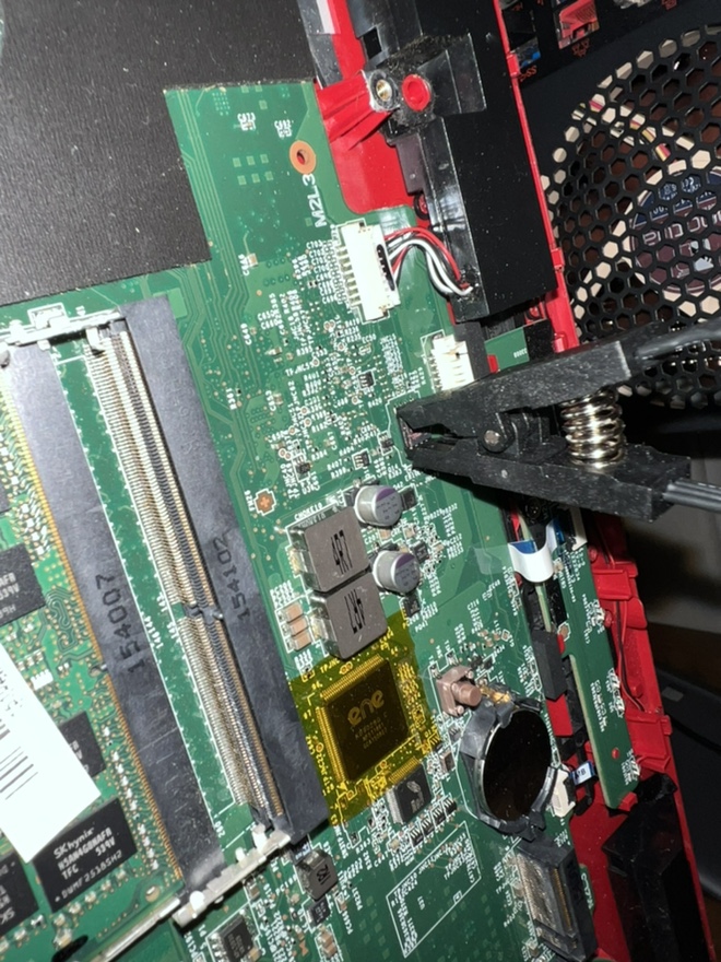

    Hello everyone, I need a dump file for MSI gaming laptop GE72 6QD
    MSI GE72 6QD APACHE PRO ( Skylake)
    MB: MS-1795
    BIOS Version 106
    ec 101
    What I have done: Tried to update BIOS from HDD from inside the BIOS built-in tool, it went succesfull the laptop restarted and had blank black screen no backlight. CPU fan spins after a minute, cpu-gpu warm, keyboard lit.
    Currently waiting for the CH341A programmer to arrive.
    I updated a 2015??? bios to 2018E1795IMS.11D /dont know the old version precisely./

        is the bios on the MSI site, you won't find a better one, what programmer do you have? did you remove the bios chip from the board before writing?

          Exactly: KeeYees SOP8 SOIC8 Test Clip for EEPROM 25CXX / 24CXX + CH341A 24 25 Series EEPROM Flash BIOS USB Programmer. ////from amazon
          No, I didnt remove it. I`m planning to use the clip what comes with.

            with the clip you may have errors..it would be better to remove the chip from the board, or to glue wires between the programmer and the chip ..

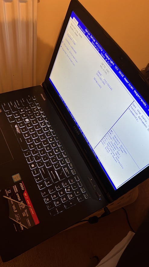

                I received today the programmer, i did use the file as you linked from the manufacturer website. I was able to write it for the first time, had no issue.
                I was worried about EC chip (Don`t know what is that for yet) but that was fine.
