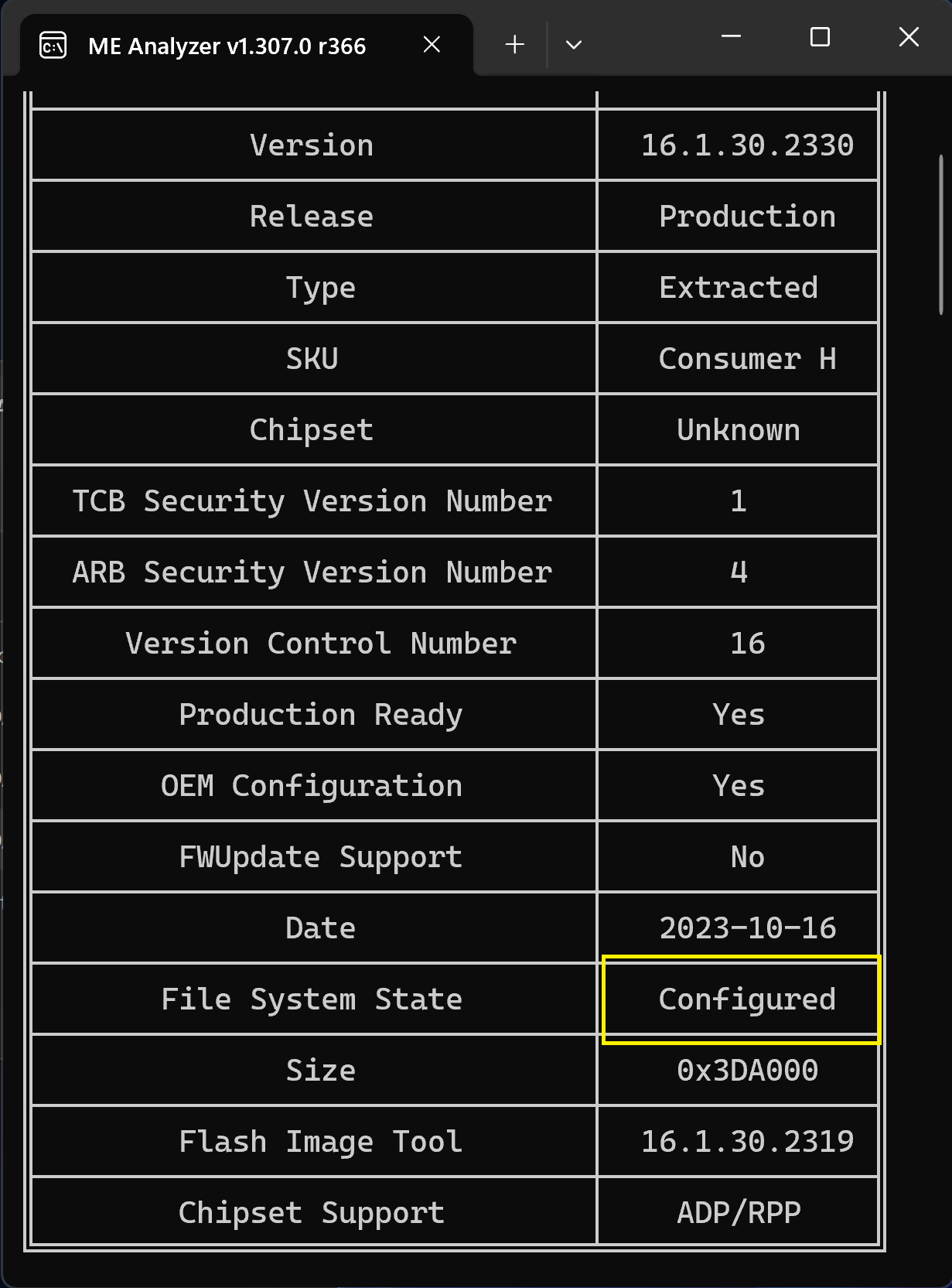

    I have OriginPC EON 15SL, however, my laptop starts and shutsdown after 1-2 second. Keyboard leds are coming on then fans spinning then it shutsdown and not turning back on unless I plug out the power cable and plug it in. I had issues with bricked BIOS then I flashed BIOS I got from the vendor to the SPI chip and still it didn’t worked because my EC firmware was newer than the BIOS I have flashed. So I wanted to try flashing the EC chip with the correct firmware that matches with the BIOS also from the vendor and it worked everything was well, and then stupid me wanted to unlock some locked bios options and edited bios file and flashed again, it worked (it didn’t unlocked anything tho) but display and right side USB port was not working. I also updated my ME driver in windows thinking it might fix the right side usb port but it didn’t so afterwards, I opened back of my laptop to check whethet I didn’t plugged cables well or did a mistake etc. and closed the back after checking and this time it started to launch yet no display (even no external display image) and fans were spinning on full speed with keyboard led on and afterwards I tried to flash to stock BIOS again (thought it might fix it again somehow) and it was still the same issue then I reflashed EC firmware again and this time after trying so many things it justs opens and shuts down after 2 second. I really do not know what caused this issue.
    However, I thought requesting help here might help if its related to BIOS maybe I am not sure.
    CPU is 14900HX
    Motherboard says its GM6IX7A-XN11 v1.1 (although some parts its written GM5IX7A)
    EC firmware version: 1.16.00
    BIOS: N.1.07OPC01
    I have attached the BIOS from the Vendor and their notes. I would be happy if anyone can help regarding what to do. I do not know if its caused by EC, BIOS or because I updated the ME firmware otherthan some version than provided by the vendor’s driver files.
    Thank you in advance and waiting for your responses

        I think I need to clean the ME but I cannot find 16.1.30.2330 Consumer H RGN anywhere. Does anyone has it and can help me with this BIOS?
          Your bios has clean ME area.
Name:	2025-07-06 06_04_59-Settings.png
          • legendkray
            • Jul 2025
            • 7
            thank you for taking a look at it, I appreciate it. My laptop shuts down after 1-2 second, I still can’t figure out why exactly. What can you suggest?
