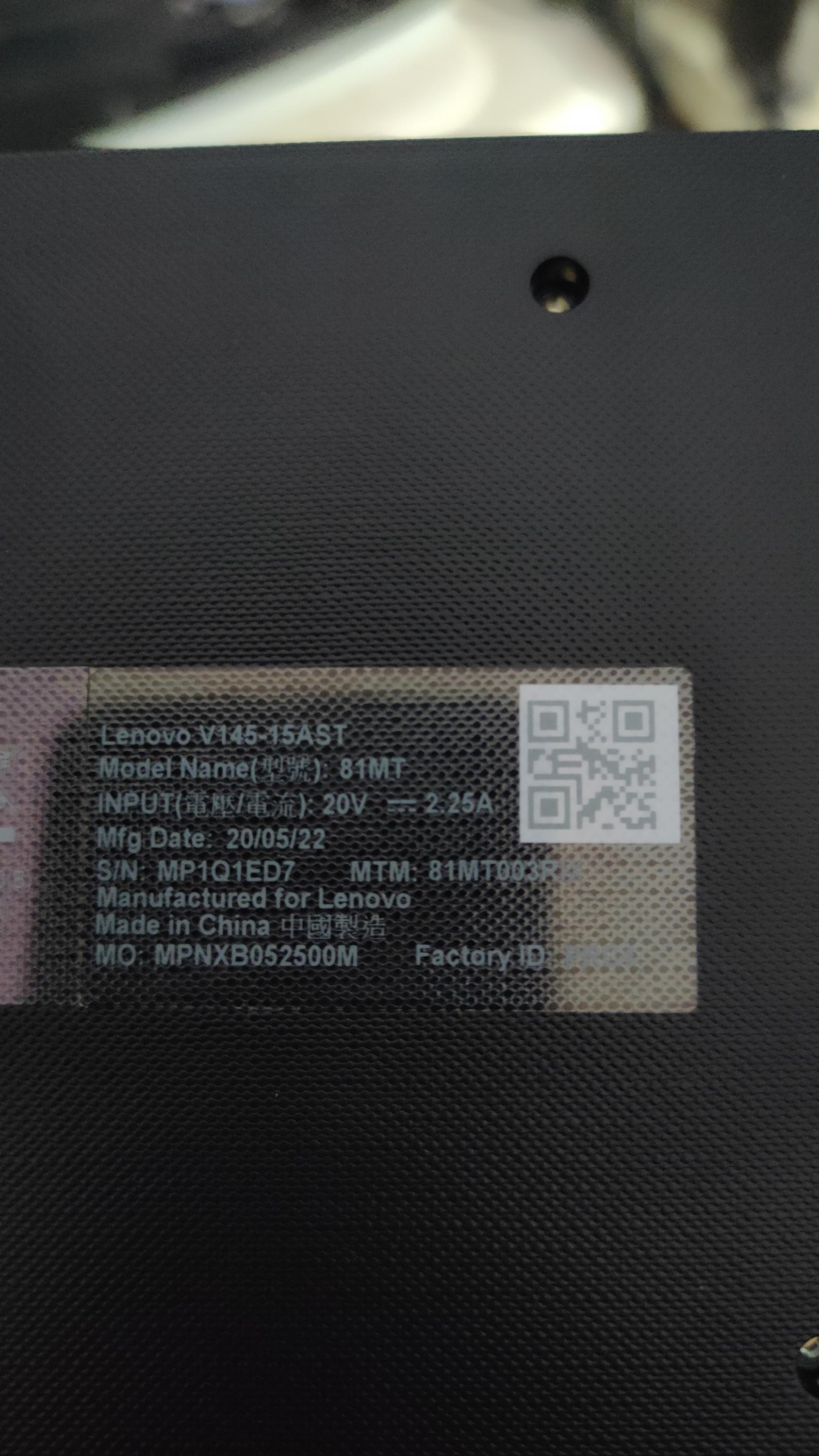

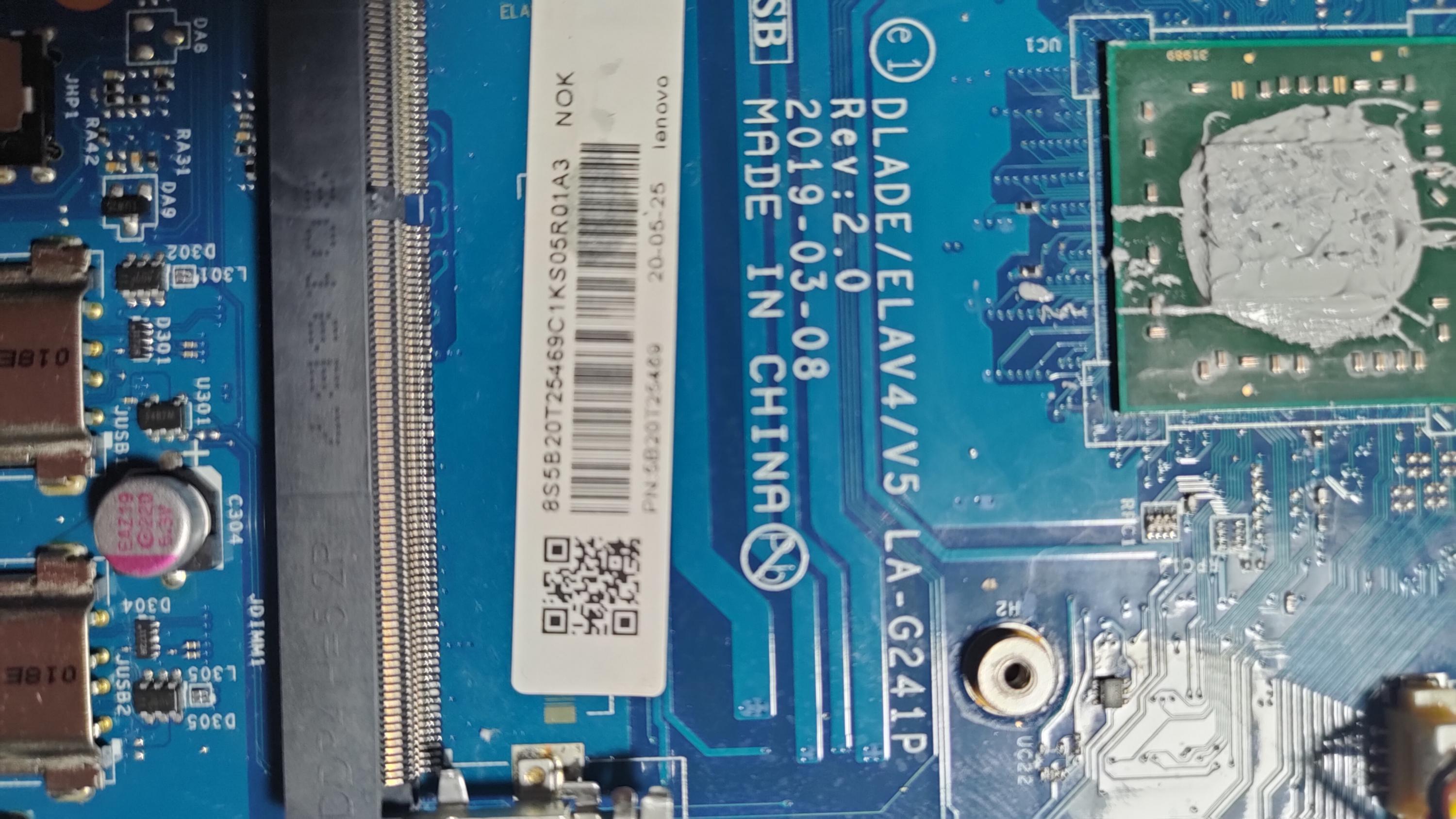

    hello everyone, I have this lenovo that turns on,
    la-241p motherboard with A4 cpu
    the voltages are there, the fan is spinning but a black screen appears, it rarely starts up correctly,
    I wrote a bios file found from the network but the situation does not change do you have a dump? or what can i check?

    Re: lenovo v145 LA-G241p black screen
    Write your S /N and Type
      Originally posted by reset1986
      hello everyone, i have this lenovo that turns on,
      la-241p motherboard with a4 cpu
      i wrote a bios file found from the network but the situation does not change do you have a dump? Or what can i check?
      rev ?
        Originally posted by ghandisolutionlaptop
        rev ?
        Dlade/elav4/v5 la-g241p rev 2.0
          try
              try
              i compared the dump posted with HxD with my dump, the files are identical, i don't think i solved with this file, are there any other files? thank you
                • 22293
                V145-15AST Laptop (Lenovo) - Type 81MT
                8ZCN27WW(V2.06)
