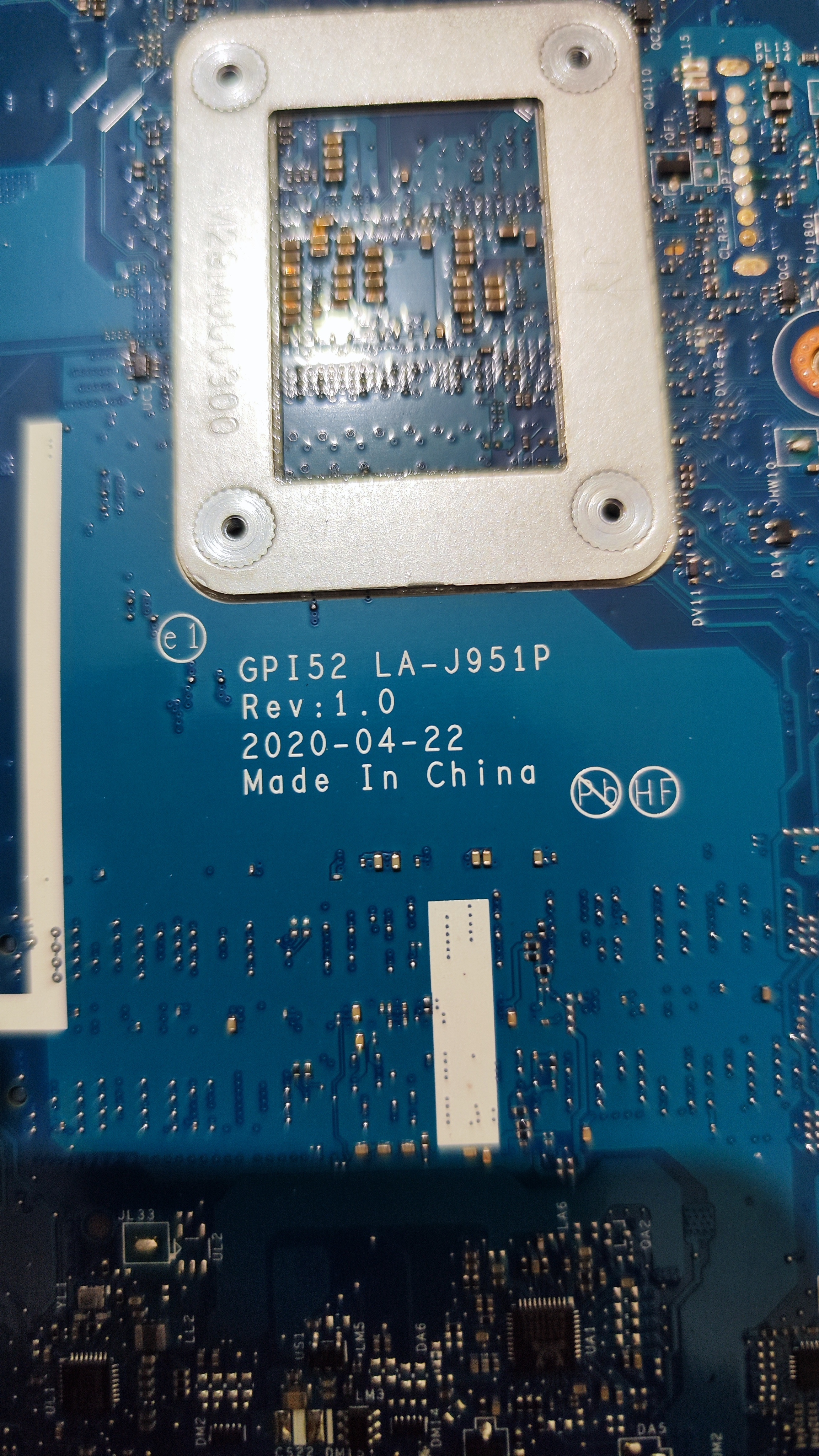

GP152 LA-J951P Rev: 1.0 bios request
  • peste
    • Dec 2016
    • 12593
    • ROMANIA
    merged post..
    • Yacine007
      • May 2024
      • 63
      • Maroc
      Originally posted by hoaca388
      Do you know that in the old bios file (original bios) there is the device's DMI and Windows key ? Don't request without the original bios included.
      Im sorry my friend I'm new to this, I didn't know that.
      Original bios Attached
      serial number : CNDO245HXC
      Mother board ID : GPI52 LA-J951P Rev:1.0
      Thank you in advance

      HP 250 G7 Notebook PC (15S43ES)
      Serial : CND0245HXC ( Zero )
      Since your BID cannot be determined, you must try all three of these files.

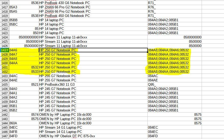

        • 20643
        Its none of those. The 15S43ES has an Ice Lake CPU
        084A6 SPT/KBP-LP ME 11 firmware
        084A8 BSW/CHT TXE 2 firmware
        084AA GLK (Gemini Lake) TXE 4 firmware

                It wasn`t 08532 either

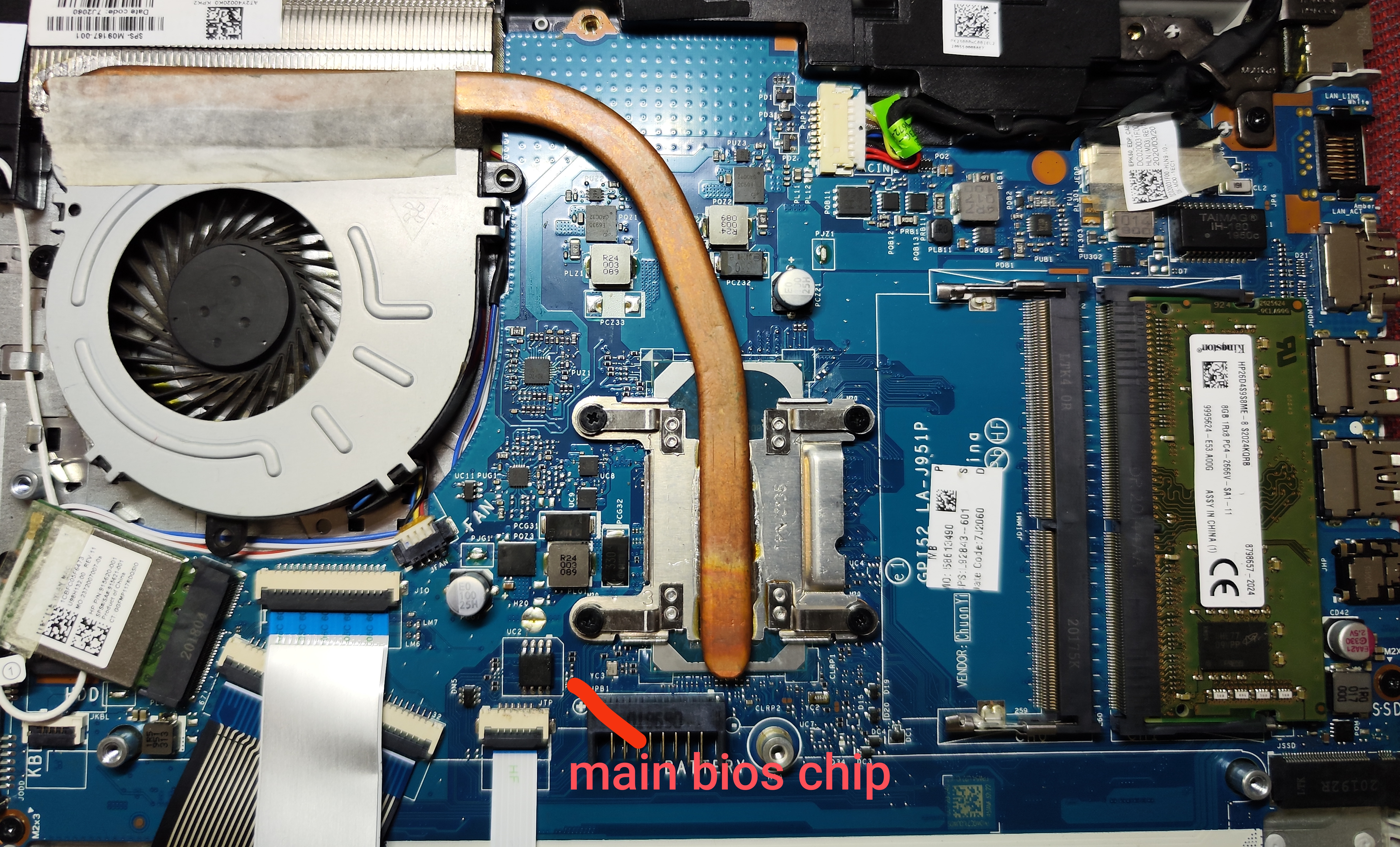

                            • Yacine007
                              • May 2024
                              • 63
                              • Maroc
                              #36
                              he uploaded a 8,4Mb bios image, so I supposed there are 2 chipsets.
                              Thanks to all
                              I am Beginner My knowledge is superficial in this area. I have a small CH341A programmer and plugged it into the bios chip, read it, saved it and transferred it to you.
                              Yeah I inquired with a friend, there are two chipsets, I don't know how to extract from the second chip. I'm going to come back to the station when I manage to extract the second bin.
                              thank you so much
                              • Yacine007
                                • May 2024
                                • 63
                                • Maroc
                                #37
                                I extracted the 8mb file from this main bios chip.
                                Where is the second chip ? Can i extract the file with ch341a programmer ?
                                Mother board image attached
                                • hoaca388
                                  Badcaps
                                  • Jan 2022
                                  • 11614
                                  #38
                                  You don't need to look for the second chip, your chip shows signs of being removed.

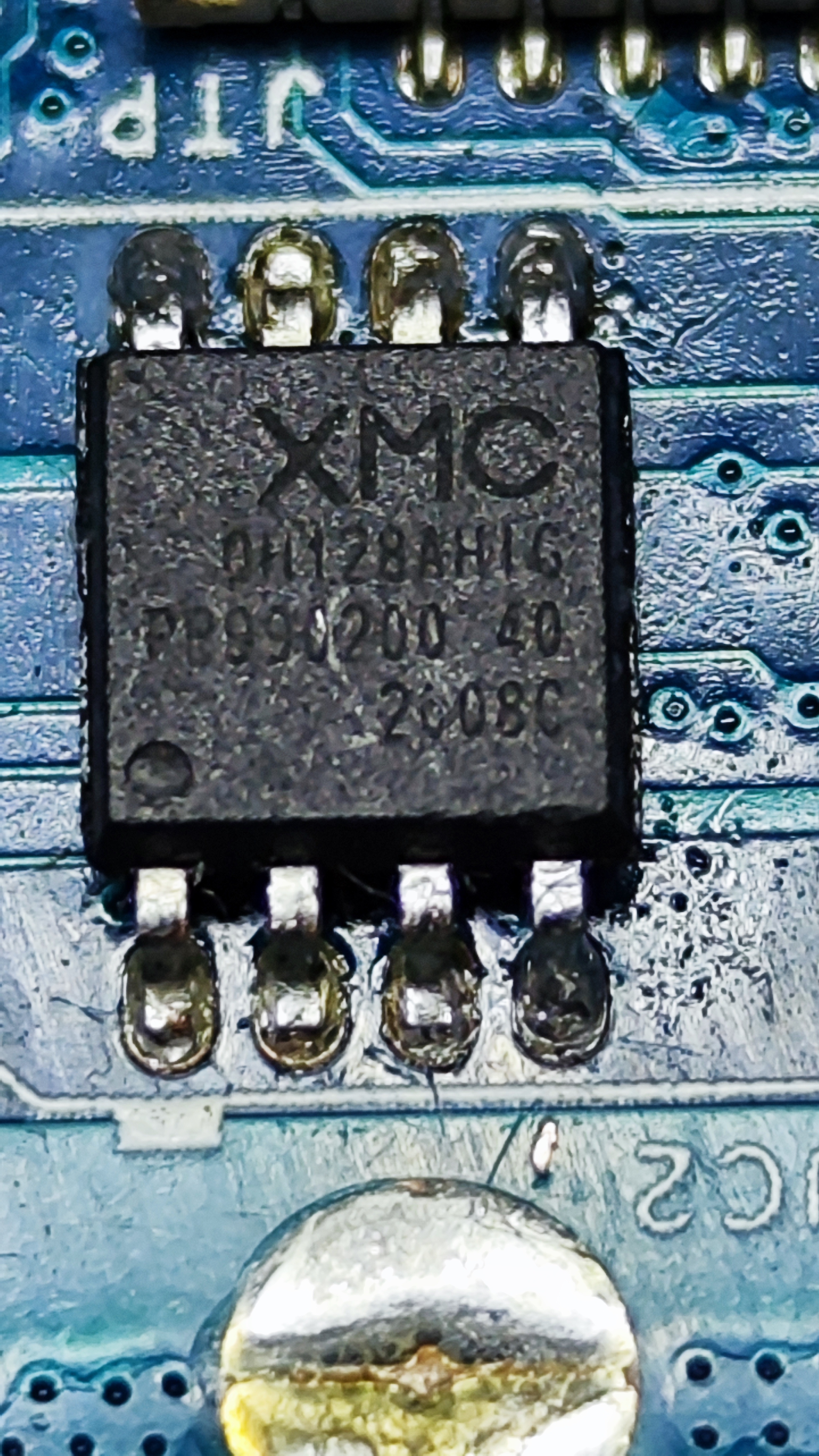

                                  • volinakis
                                    • Jan 2021
                                    • 2700
                                    • N/A
                                    #39
                                    what code is written to bios chipset? Image is not clear.
                                    • Yacine007
                                      • May 2024
                                      • 63
                                      • Maroc
                                      #40
                                      XMC
                                      QH128AHIG
                                      PP990200 40
                                      2008C
