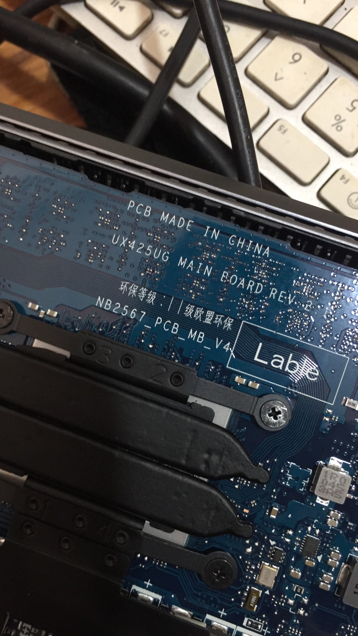

please help me bios ASUS Q408UG
  • hunglaptop1102
    • Dec 2018
    • 79
    • viet nam
    I was updating the new version when the power went out, can anyone help me to fix it?
  • peste
    • Dec 2016
    • 12811
    • ROMANIA
    Re: please help me bios ASUS Q408UG
    try this..
    bios extracted from the Asus website ...
    • hunglaptop1102
      • Dec 2018
      • 79
      • viet nam
      thanks you

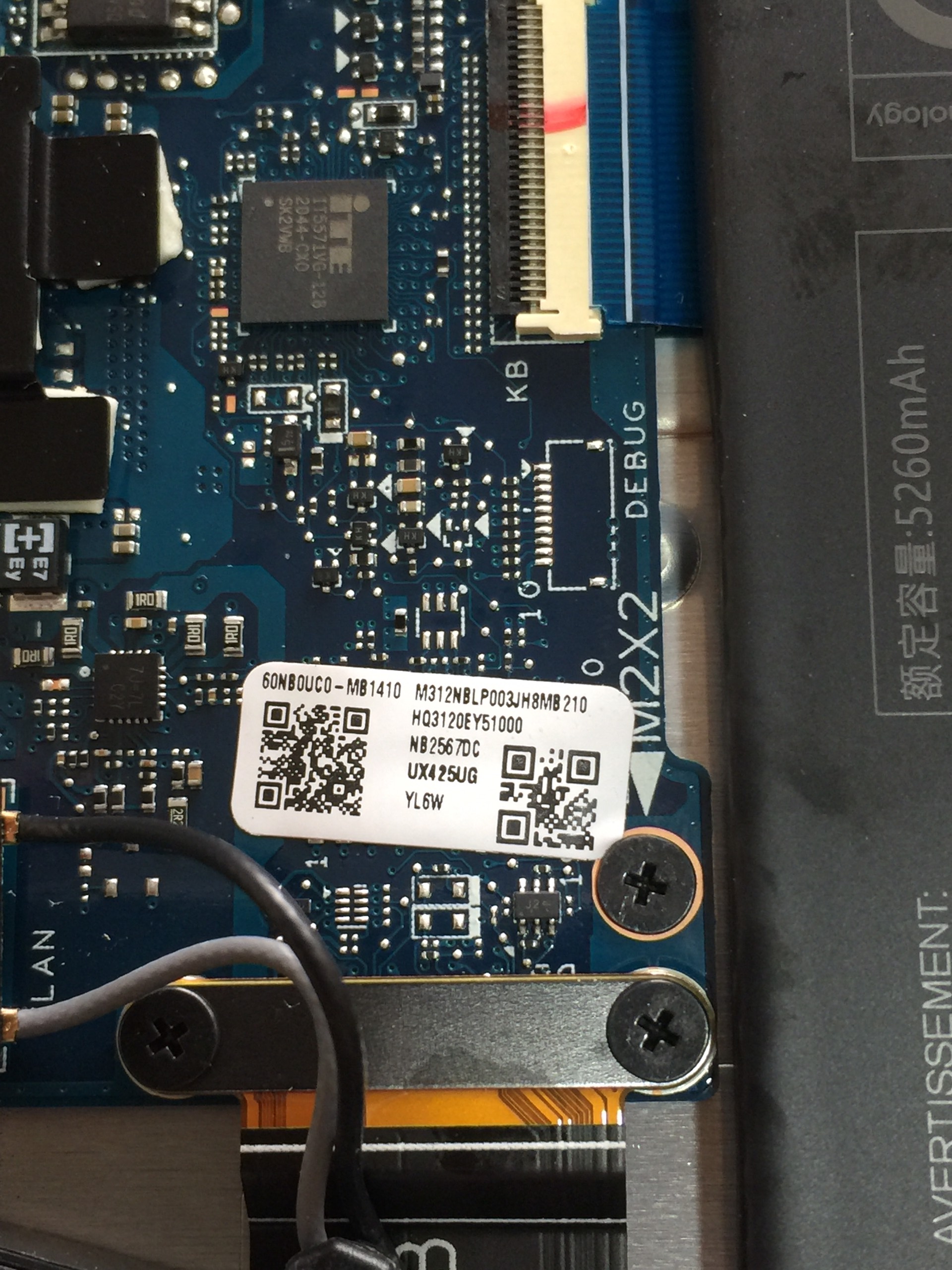

            Post a picture of the QR code sticker on the motherboard,and post your backup
            • black0hackers
              • Jul 2020
              • 367
              i can't read the bios chip. it name XMC 25qu128bh
              i use rt809H but show error like picture.
              Can you check ad. thank you!

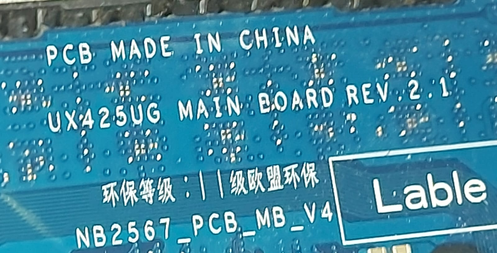

                              • chinh
                                • Mar 2020
                                • 89
                                • viet nam
                                I need ASUS Zenbook 14 model : Q408UG
                                Status: My bios has power but no display
                                Bios motherboard is
                                Motherboard model number :UX425UG main board rev 2.1
                                NB2567_PCB_MB_V4
                                SN: 12MN3N0LP005757093​
                                • minhdigital
                                  • Nov 2022
                                  • 753
                                  • Vietnam
                                  Bios motherboard is
                                  NB2567_PCB_MB_V4
                                  Send to you
                                  • chinh
                                    • Mar 2020
                                    • 89
                                    • viet nam
                                    Originally posted by minhdigital
                                    Send to you
                                    thanks it worked.

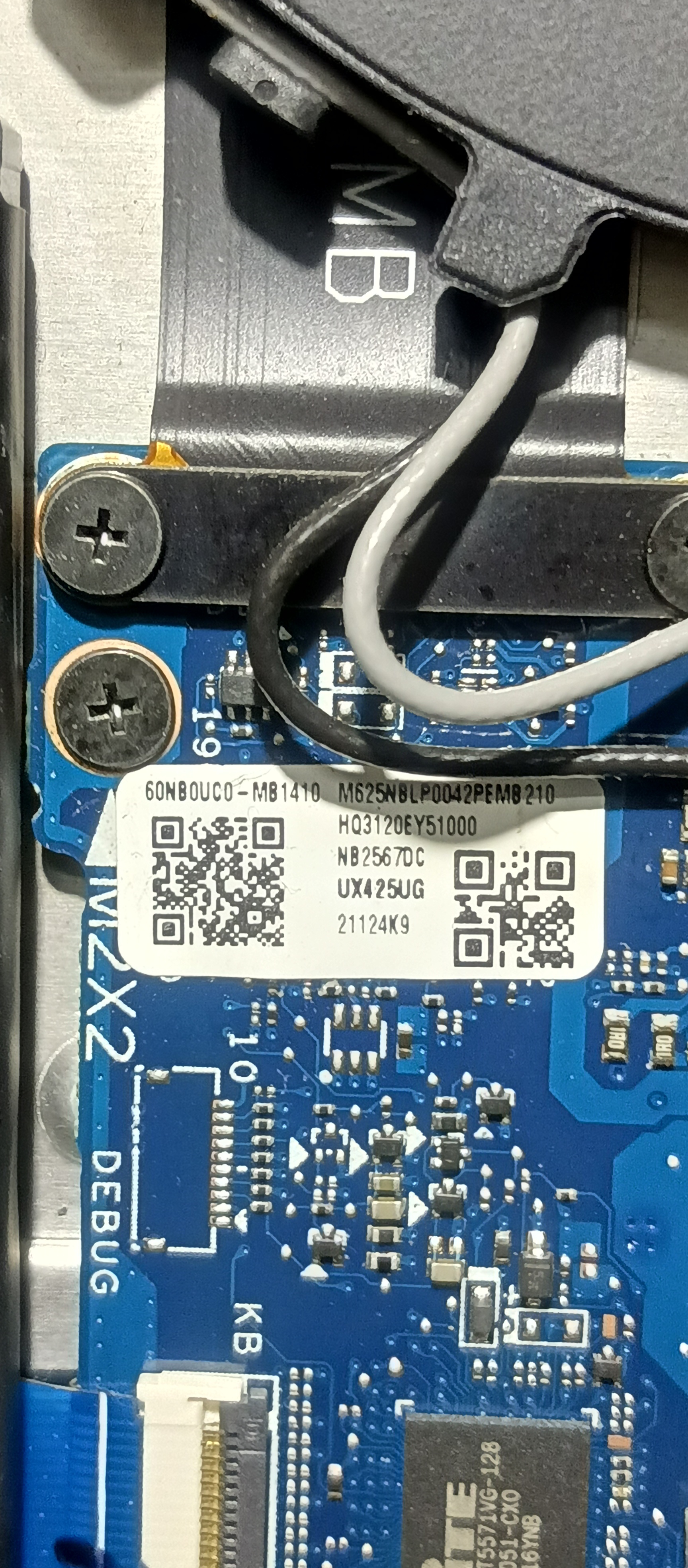

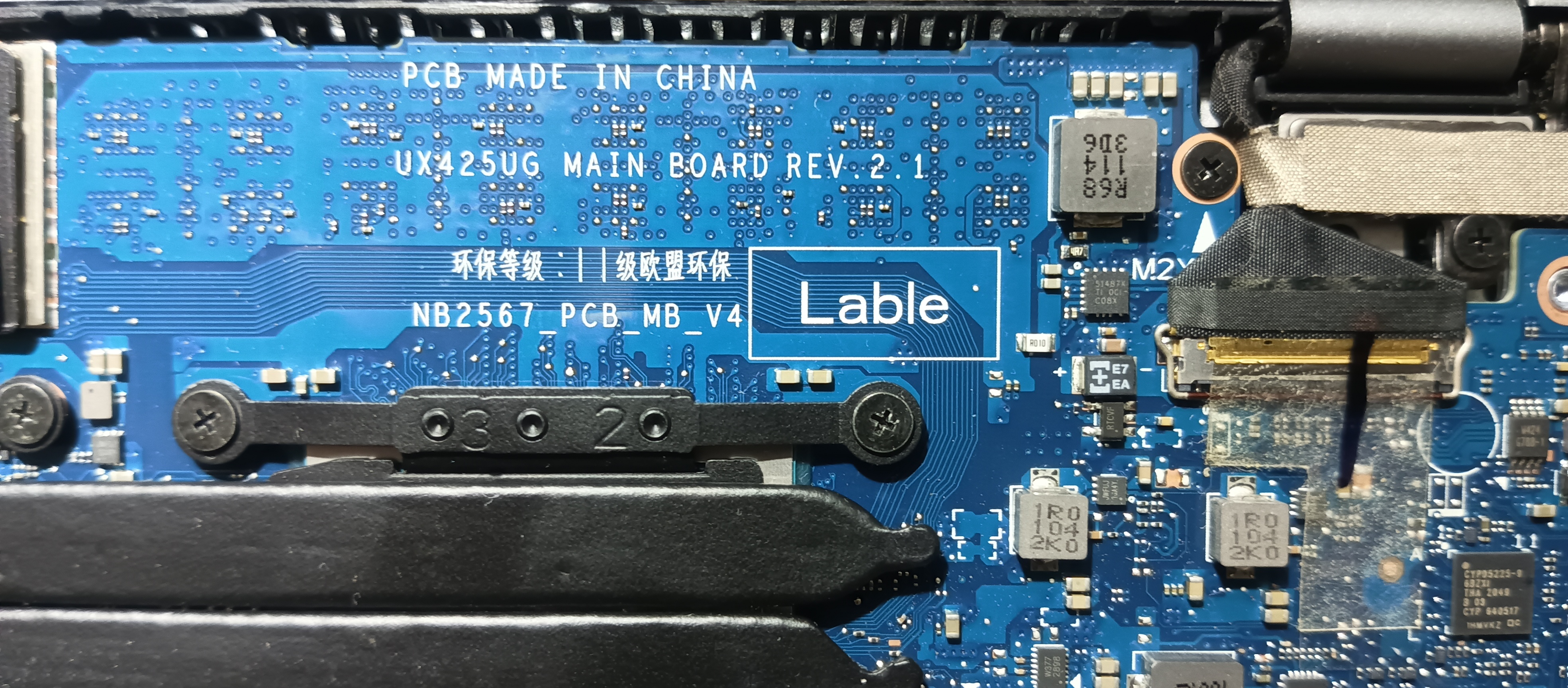

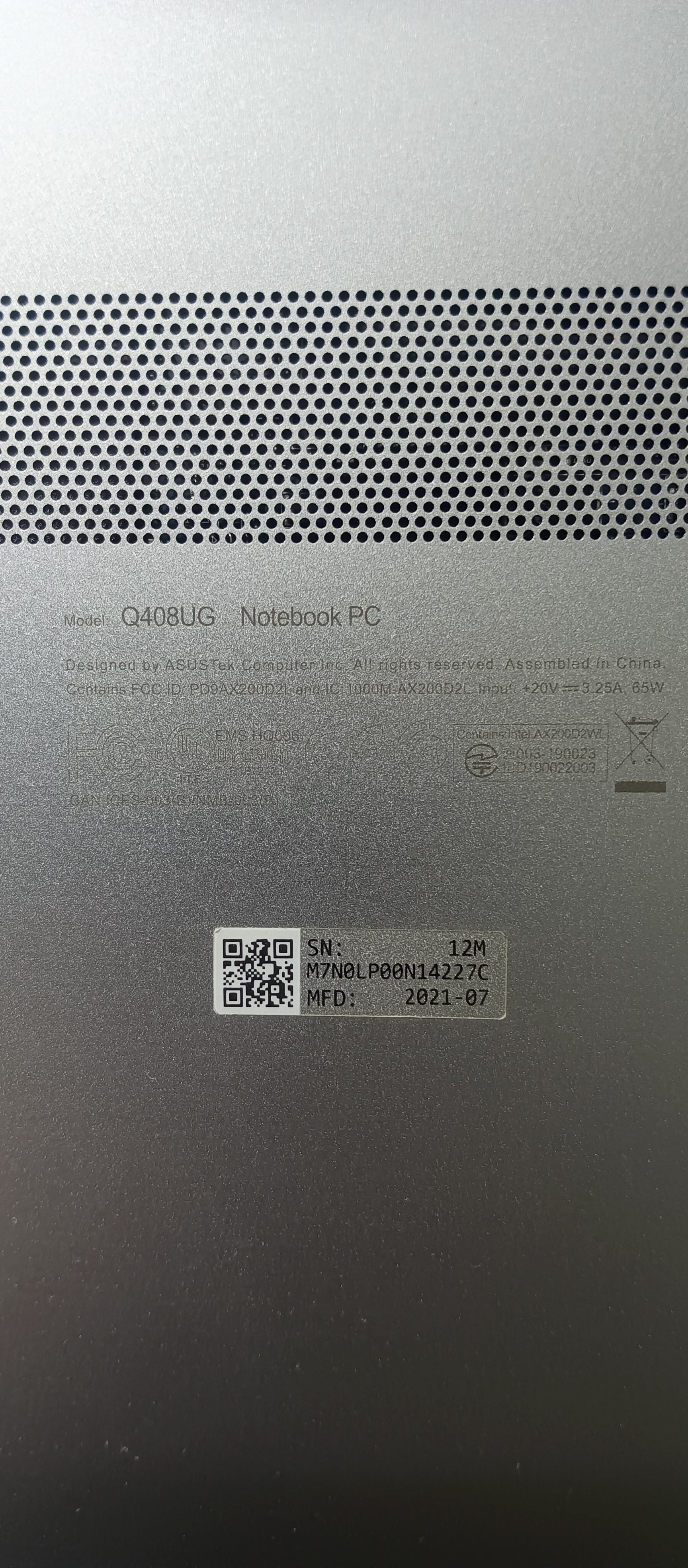

                                      Guys help me, because faulty battery (no voltage, protect mode) when I'm trying update bios via Asus EZ Flash 3 suddenly laptop is power out in the middle update, now stuck in recovery bios. try bios from Asus website somehow cannot update because file is not proper bios. I make bios dump, trying to flash using external programming.
                                      Asus Q408UG
                                      SN: M7N0LP00N14227C
                                      UX425UG REV.2.1
                                      NB2567_PCB_MB_V4
