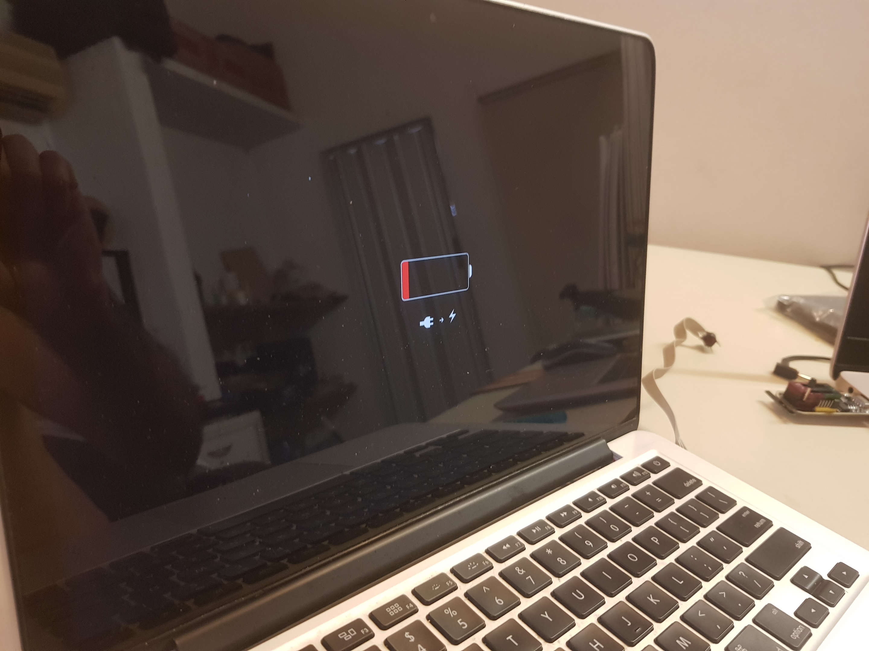

thks a lot peste but did not seem to work. the screen is backlight on as expected, DID NOT hear a chime (will try edit and another serial) but nothing goes on, no drive option no folder blinking.... the screen as i have said is ok because when battery goes down it shows this:

post 13 chimes ok, but no image at all... only backlight ...at least that sound is fine.. if i wouldnt have seen the low battery indicator in full screen, i would asume a bad screen but i know is a good macbook unit besides this EFI issue... if i had time enough i would try alternate efi like coreboot for example , but unless i find a redy to use BIN file I cant deal with compile and all that nightmare...Marcelo JComment
