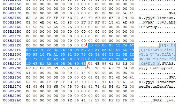

            • 21853
            Originally posted by Marcin49wp
            Hello plese help rest password bios
            CF 53
            MODEL NO: CF-53AAC34ZG
            SERIAL 2DTCA84247
            I`ll give you a clue so you can unlock them yourself. Search the forum for AMITSE and read the posts , or open a locked/unlocked bios with a hex editor and compare the differences.
            • Marcin49wp
              • Jul 2024
              • 28
              • POLAND
              So I should reset everything after AMITSE. ???
                • 21853
                Fill with zeros ,leave the 01 alone at the end. There are 2 areas to fill with zeros
