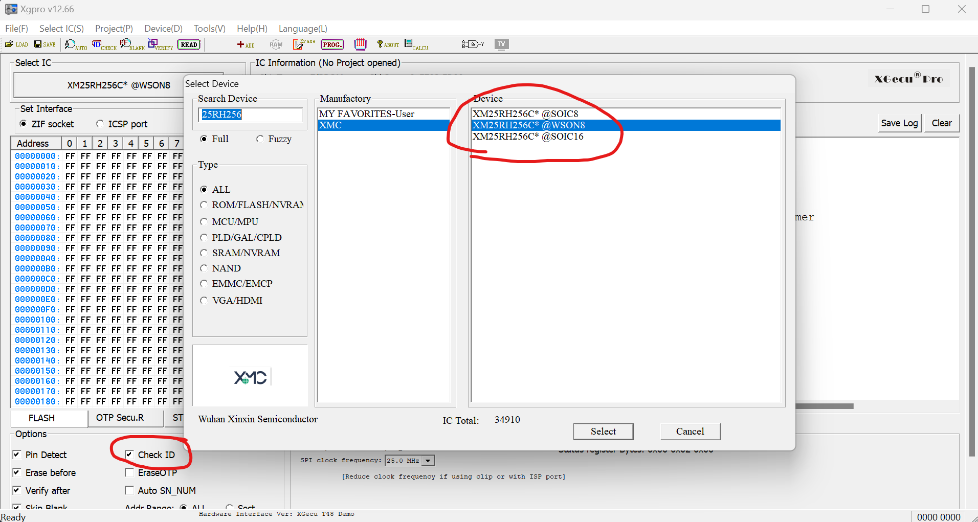

                                I have dell latitude 5420 11th no alumage
                                There is a problem in the eeprom 25rh256cx
                                I Change it by 25q256jve and flaching
                                the laptop is allume but affichage white,red and green
                                MB: GDF40 LA-K491P Rev:2 (A01)
                                Asset : LT121705
                                Serial : BR7LXD9
                                • Oliver111
                                  • Jul 2018
                                  • 52
                                  • Kiev
                                  #637
                                  Asset : LT121705
                                  Serial : BR7LXD9
                                  Try your old bios chip. Manually select 25rh256 (or winbond 25q256jve) in your soft for programmer and unbox checkid. If don't work - try bios in post 521 (second file) with old bios chip.
