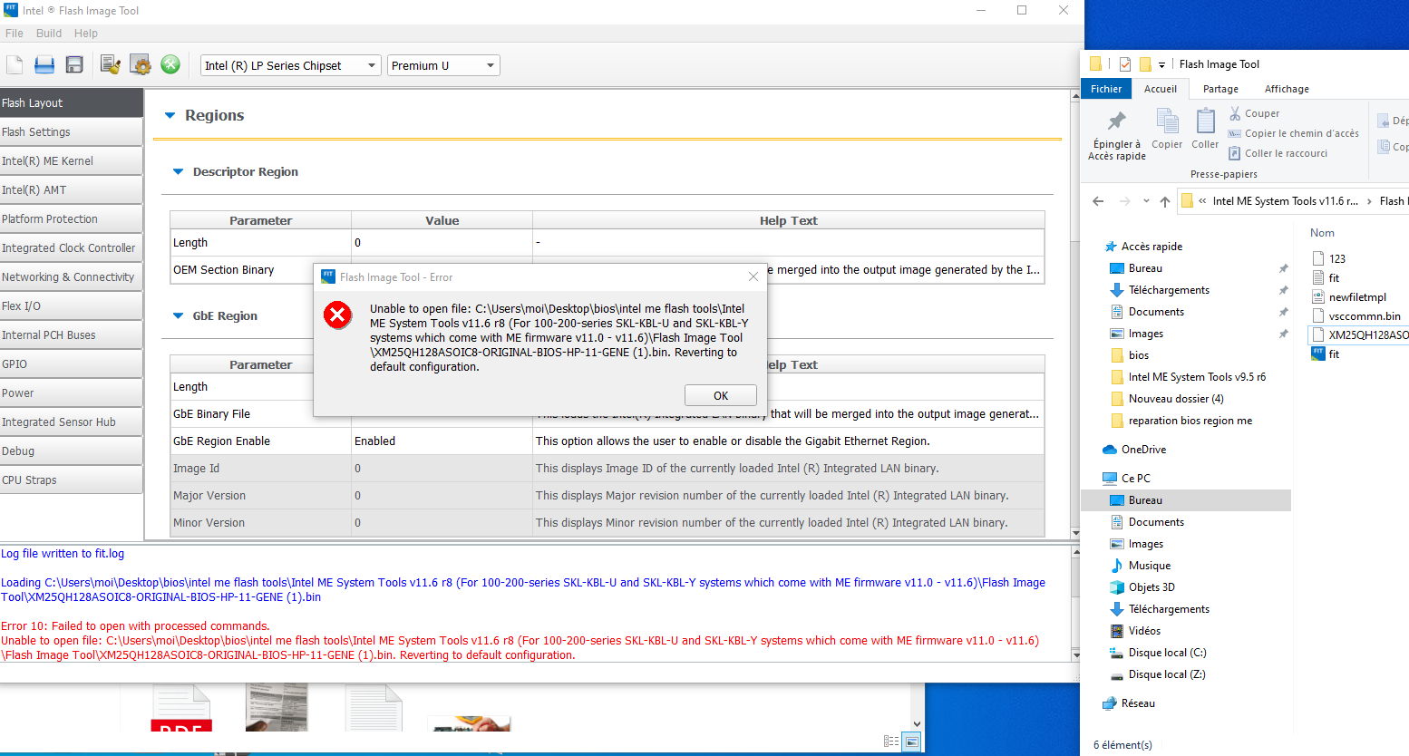

                            hp 15-dw3015cl bios
                            hi, i have a laptop hp 15-dw3015cl motherboard GPT52 LA-K201P, SERIAL CND10674V3 which cannot find the ssd when formatting windows. The SSD is however well recognized in the bios, I deactivated all the bios options but impossible to find it for training in W10.
                            I wanted to clean the original bios region but the software says it is corrupt or there is no region so I can't do it, can someone do it to me please?
                            searching here I found several bios but none work the pc does not turn on with the bios from this link: https://www.badcaps.net/forum/showth...ighlight=K201P
                            can you fix this original bios for me? THANKS

                              If the virgin bios doesn`t work youve got other hardware problems,or you should install the intel RST drivers during installation.If the bios does work then the next job is to transfer the DMI
                              from your backup and copy it to the new one using a hex editor, a 2 minute job. The offsets are 500000 - 501FFF .

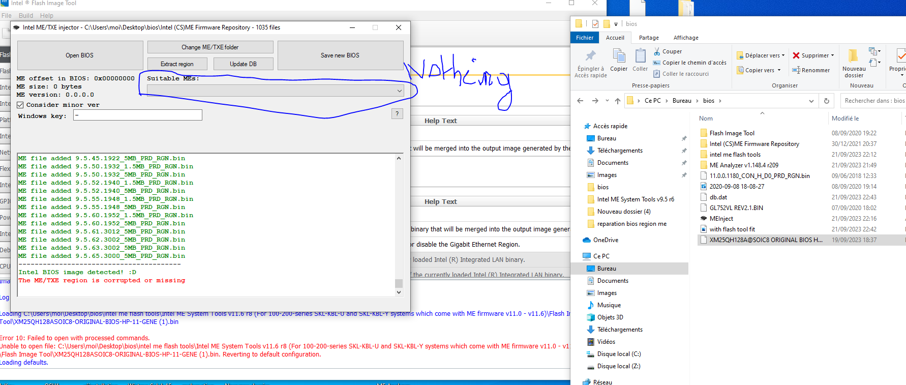

                              By the way,i looked at the picture you posted,you`re using intel ME/TXE injector, i wouldn`t recommend using that -
                              How to clean ME/TXE region
                              https://www.badcaps.net/forum/showpo...41&postcount=3
                              Quote:
                              Do not use use Intel ME/TXE Injector/Easy Clean ME or similar tools: they do not retain the manufacturer's configuration and can cause subsequent problems.

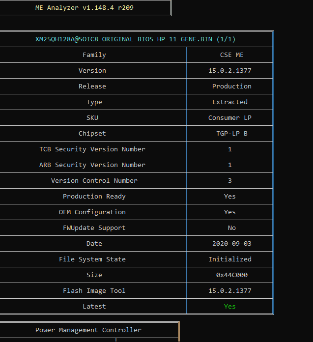

                                Sorry, I can't get any results, I can't find the firmware 15.0.2.1377 to clean the me region of my bios, can you help me?

                                  I tried with both methods (intel me txe and flash tool fit), I can't get any results, can you help me?

                                    Why waste your time.The virgin bios has fully configured clean ME firmware, all you have to do is copy your DMI to it from your backup, job done.If it doesn`t boot with the virgin bios you got bigger problems.
