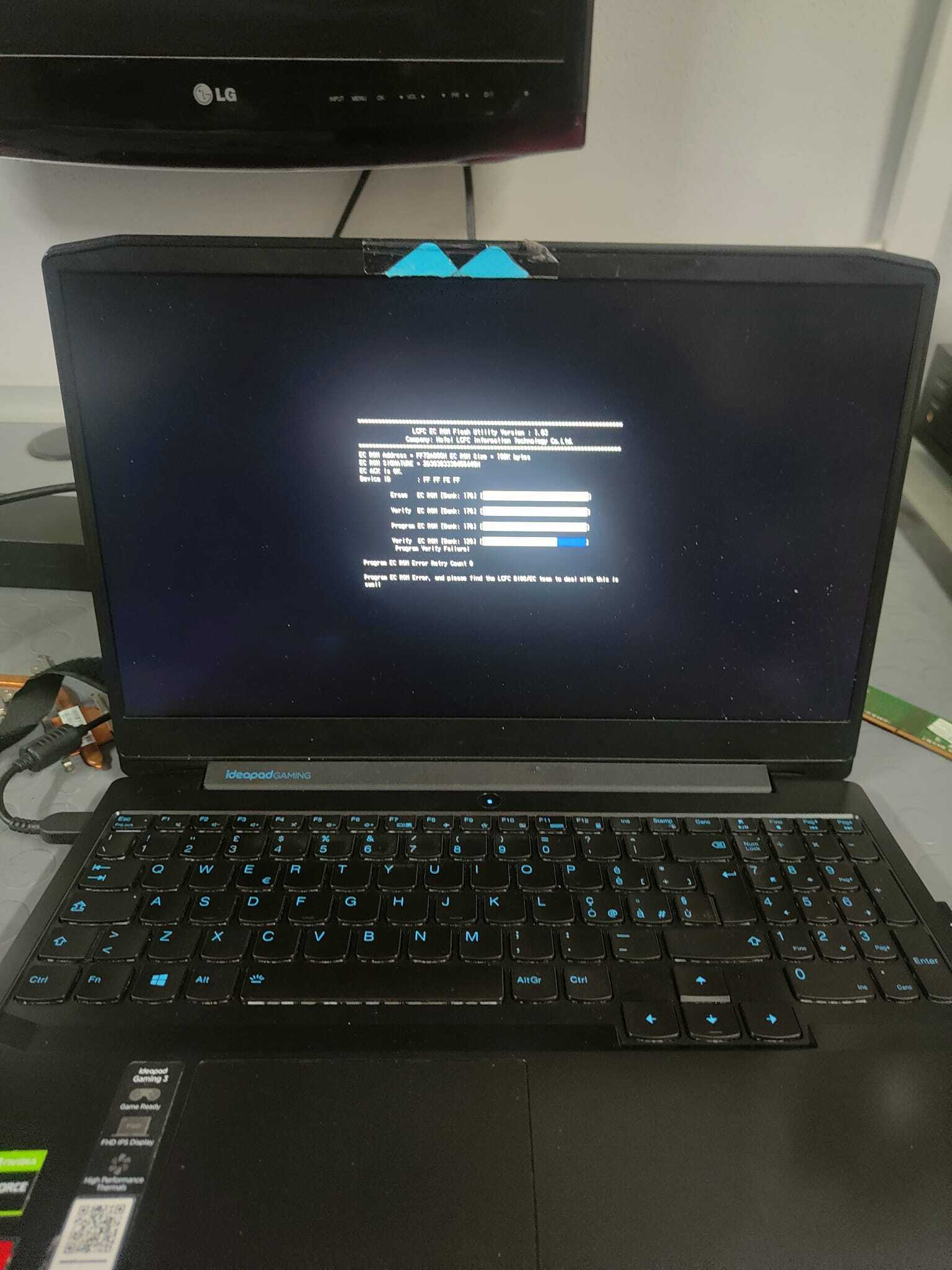

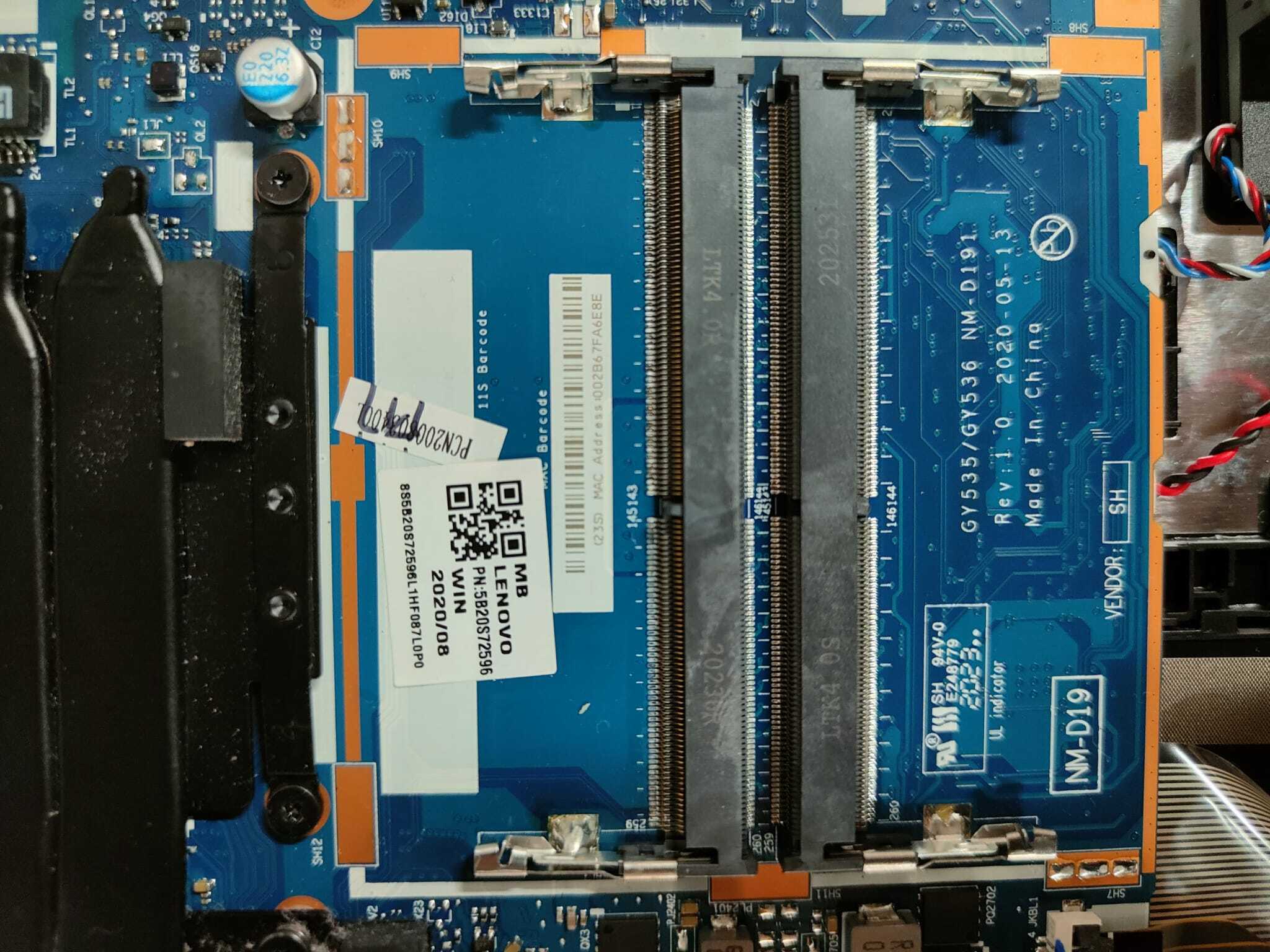

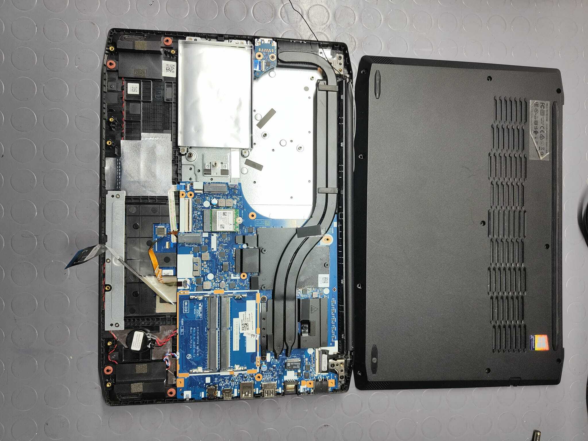

    good morning! i have a problem with a this lenovo : GY535/GY536 NM-D191 Rev 1.0......this lenovo power on but don't have a signal to video ....
    then I'll try​ to programming bios with attach 1 ...the notebook power on but have only external signal on hdmi and when i selected on bios switchable graphics notebook working properly ....after this i decide to upgrade bios from lenovo package but when programming EC i have the error....at this step the notebook can't power on properly...now i can't find the correct EC but my ite is IT8227E-128.... i try to program EC from POST#19 (i have a SVOD PROGRAMMER) but with this EC notebook not work properly ...notebook power on when I connect the power supply and have only external signal with ac adapter error and can't power off notebook.....where can I find the correct EC rom???

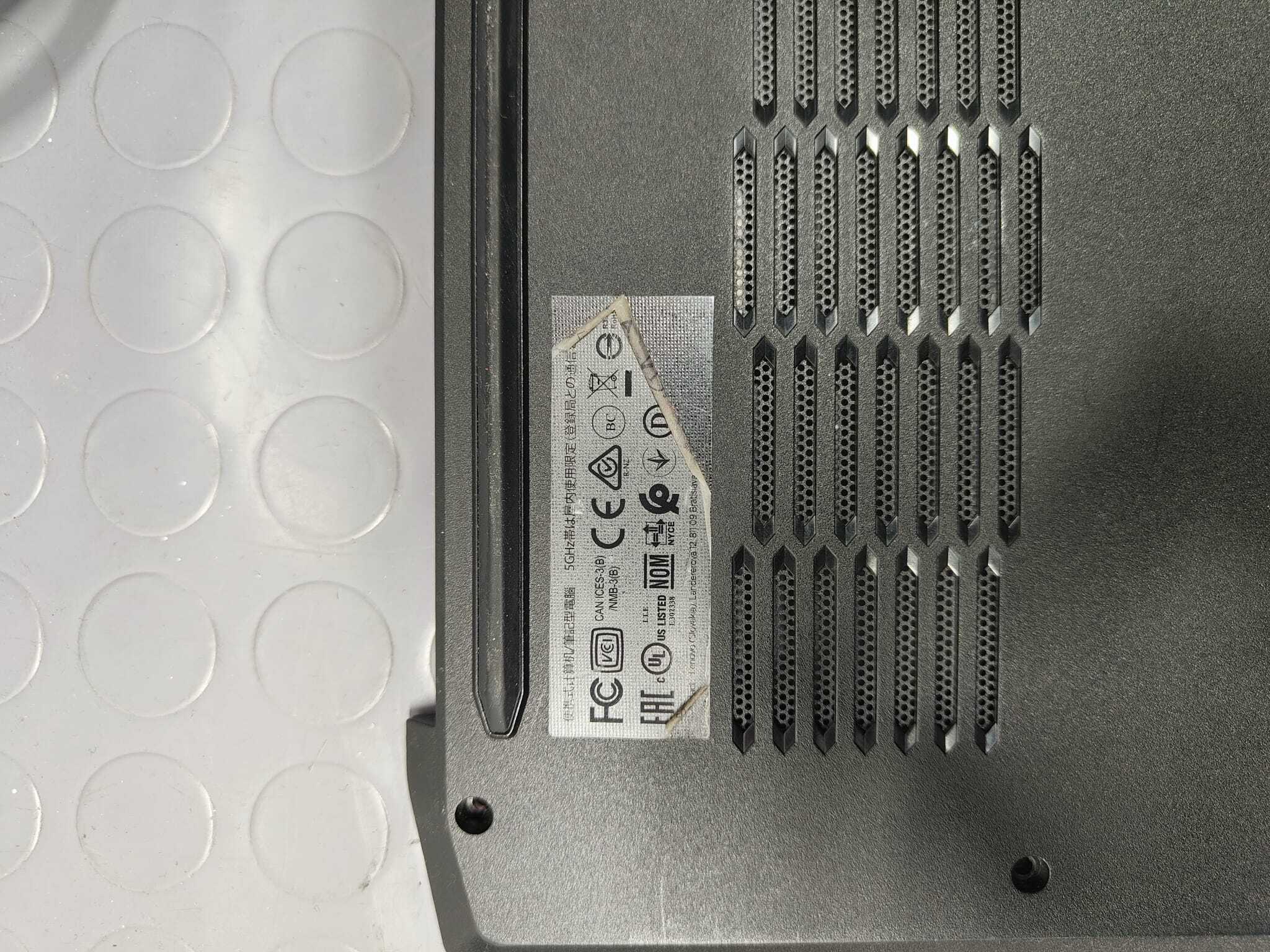

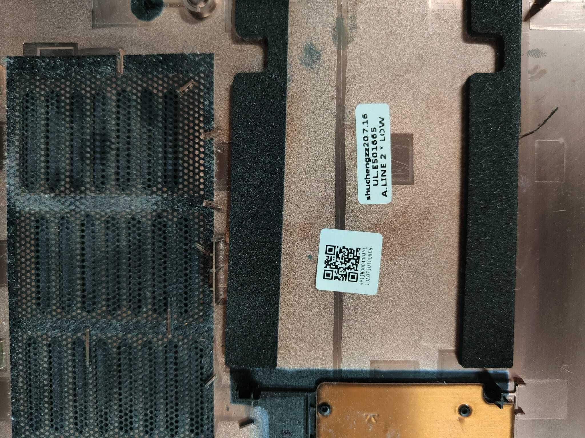

    i have only this serial
    • peste
      • Dec 2016
      • 13333
      • ROMANIA
      Usually on a label stuck on the laptop case, there is the full name and model, (TYPE) and the S/N...post them...if you don't find the S/N, look for (TYPE)..
      • pallino8888
        • May 2015
        • 7
        • Italia

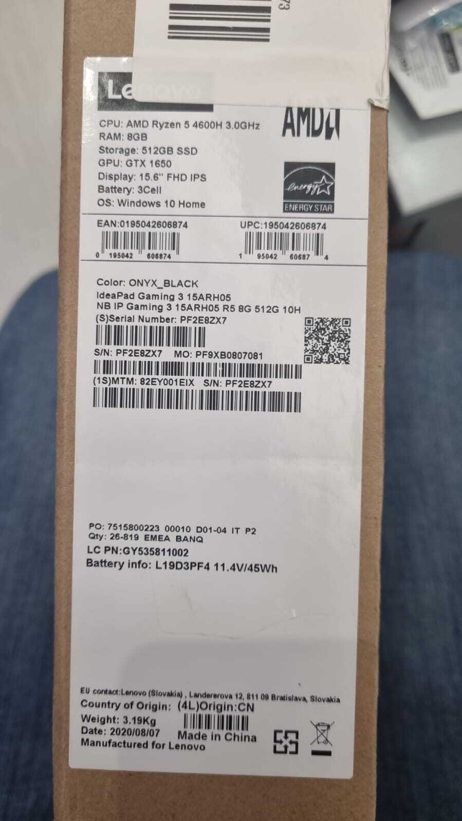

        i didn't find any other label on the laptop,i took a photo of the original box

            unfortunately the operating system doesn't start, it's not possible to access the BIOS and when I try to press the power button the keyboard backlight turns off but the notebook stays on...I hope someone has an early version of the BIOS with 128k EC

              bios and EC bios extracted from Lenovo site update
              DMI 75C000 - 75DFFF​

                Thank you ! today I tried your bios and your EC but the problem remains the same... I would like to find an older version of bios and EC... I attach the video of the problem

                  #29
                  I forgot to say that as you can see the notebook if I try to turn it off the keyboard turns off but the power button turns on and the side lights also stay on
                  do you have a guide on how to extract EC ROM from bios???
                  from the lenovo site I find this bios and I think the one you sent me is different you can extract this bios and EC

                    Good morning! I wanted to be correct and tell you that I solved it with this latest bios version I posted FCCN21WW... I managed to extract the EC and now everything works correctly. thanks for everything​
