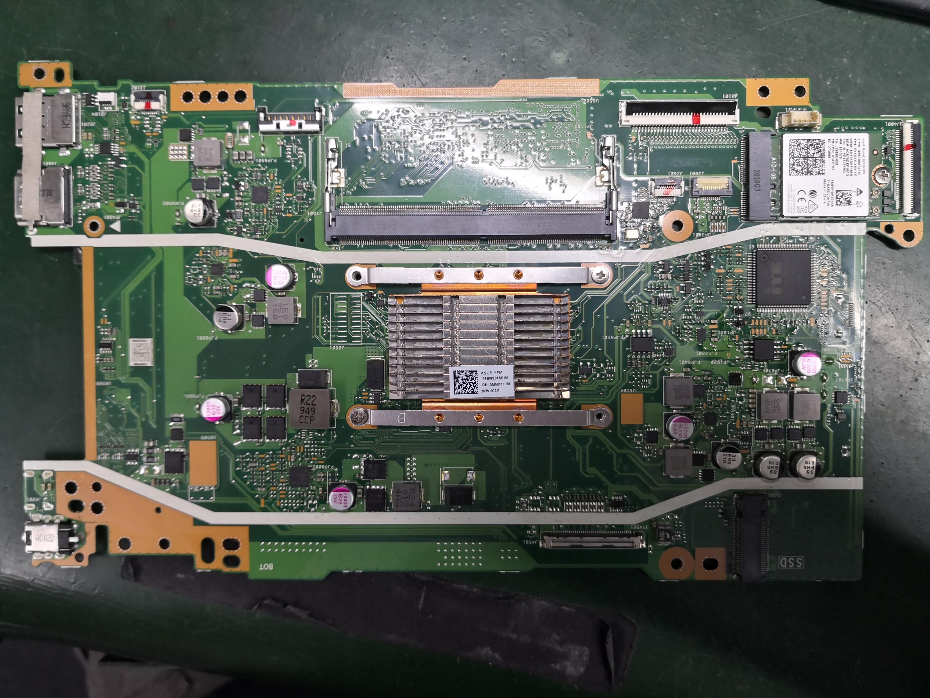

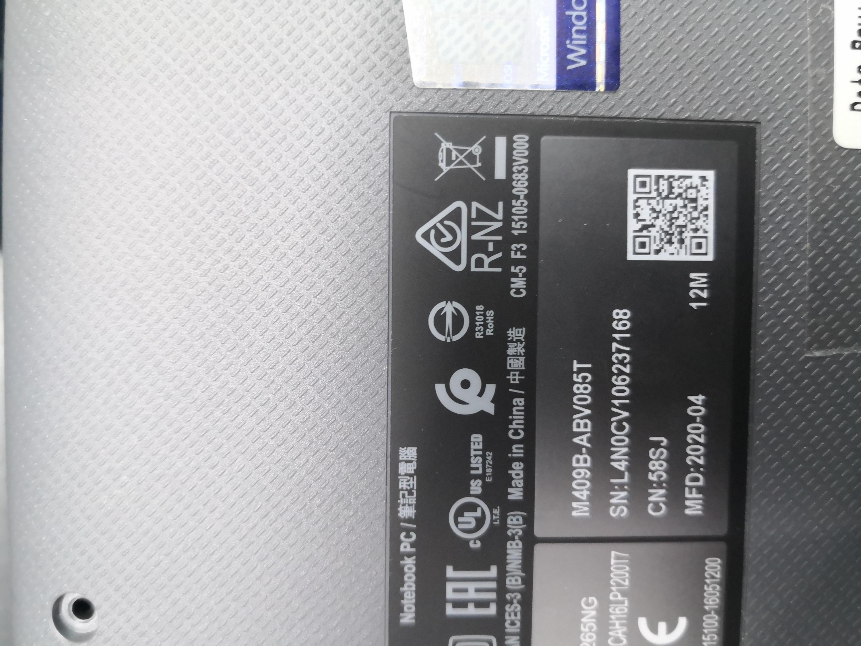

    Hi All, i need bios for M409B-ABV085T
    MAIN BOARD X409BA R2.0
    Problem is no display.Old bios as attached

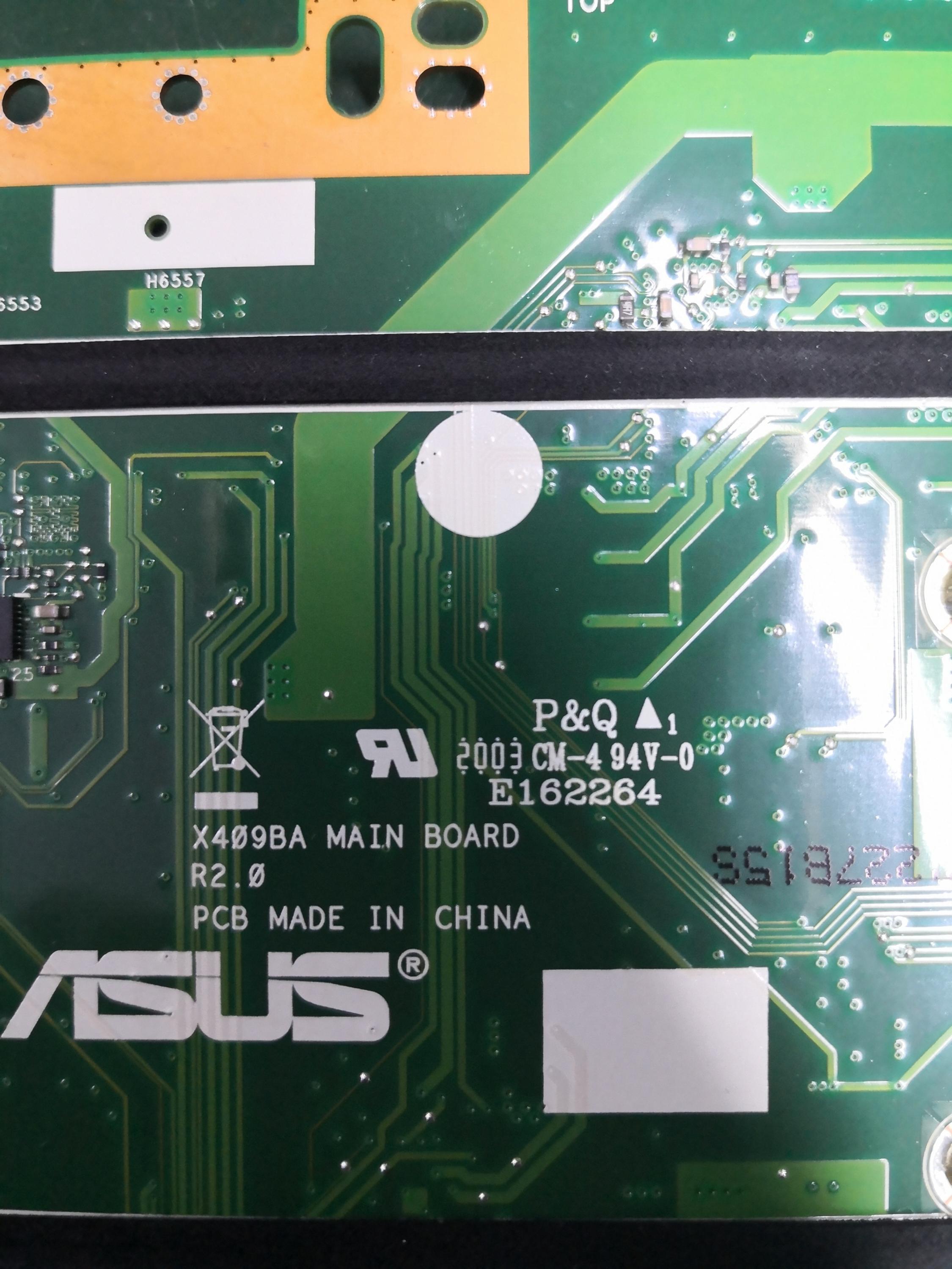

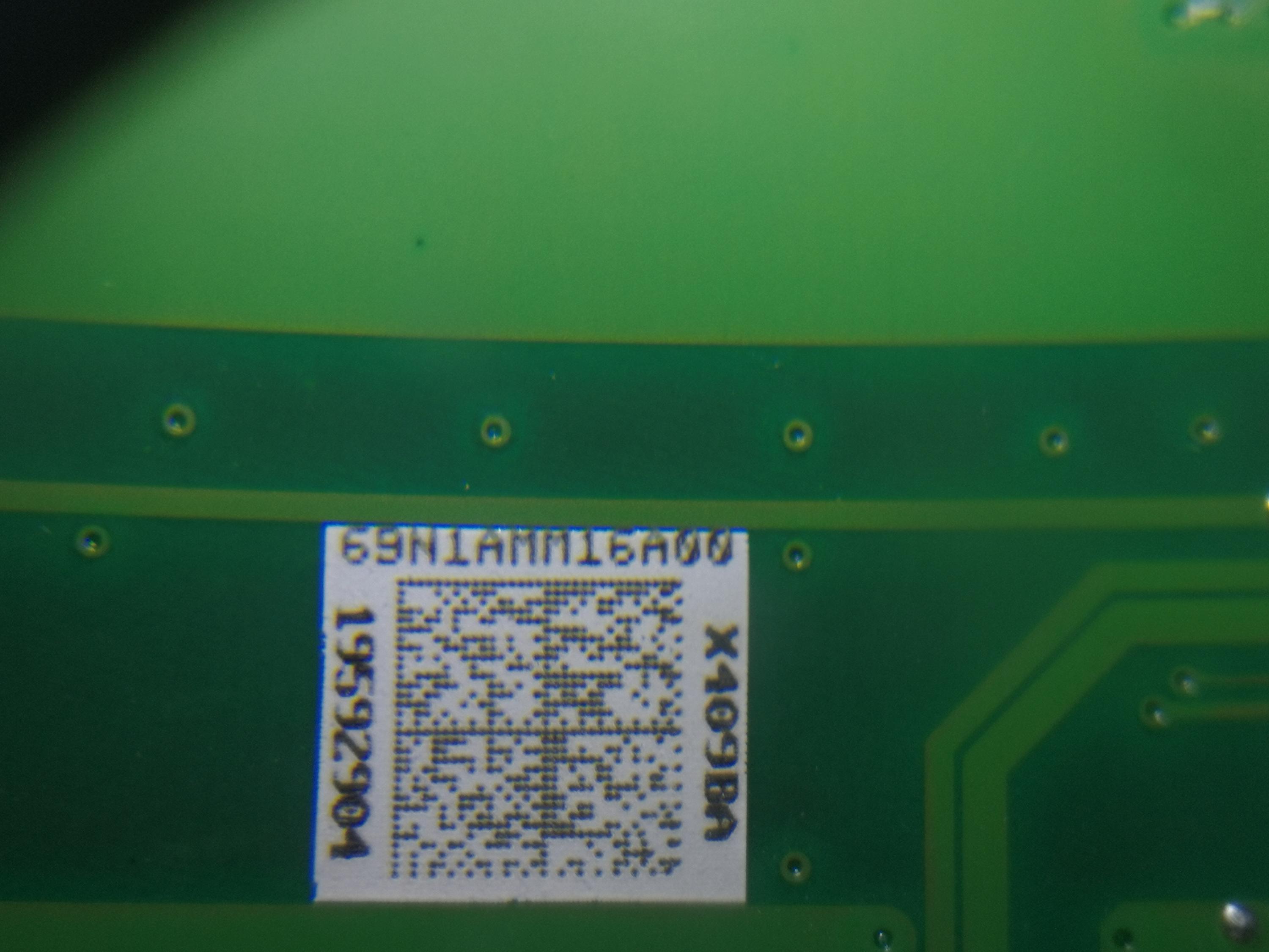

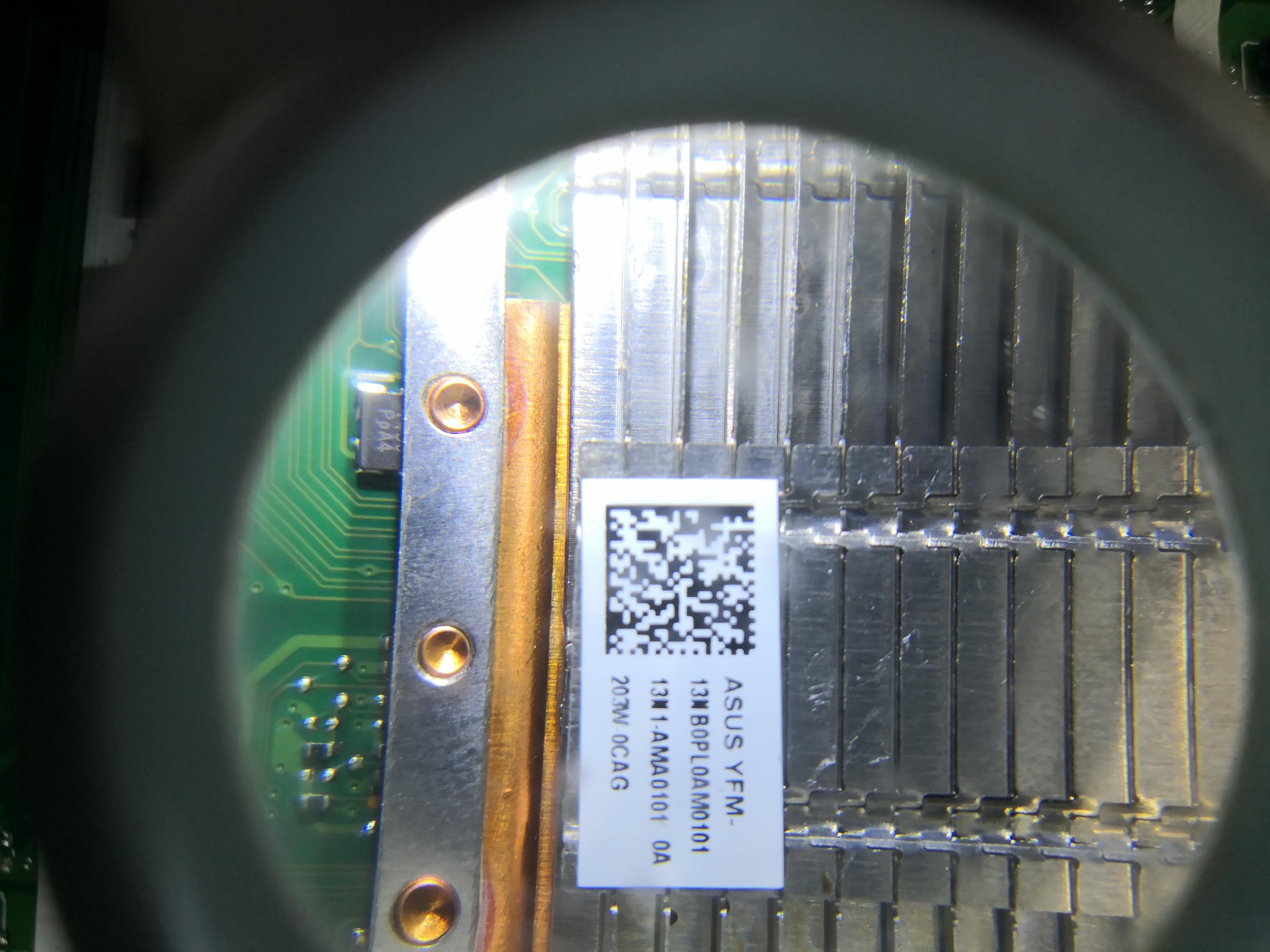

              Post a good readable picture of the white square QR code on the board, both sides
              • vampy999
                • Sep 2019
                • 110
                • malaysia
                Re: Asus x409ba bios
                Is it this?
                  try...bios extracted from the Asus site update
                  • vampy999
                    • Sep 2019
                    • 110
                    • malaysia
                    This one can power on but still no display,
                    i measured the bios chip (gd25lb64csig) pin 2 no voltage.What can be the problem?
                    • peste
                      • Dec 2016
                      • 12880
                      • ROMANIA
                      I don't think the problem is the bios, move the discussion to the main forum.
