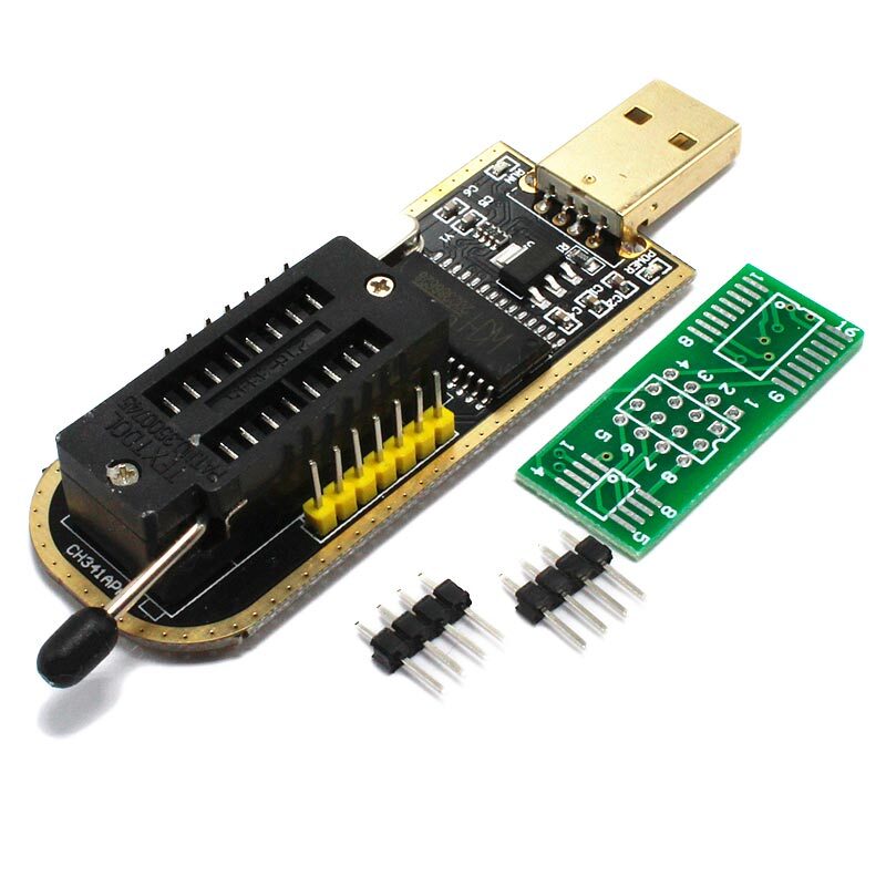

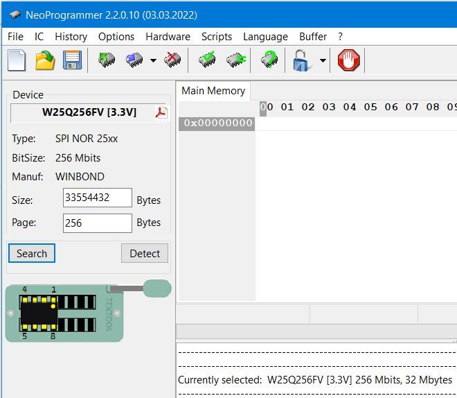

    I was able to read/write chip 25rh256cxiq the Dell 5420. I used:
    1. Ch341A programmer;
    2. Software NeoProgrammer V2.2.0.10 (select chip W25Q256FV).

      Thanks for this trick/tweak. It works, I have confirmed it following your method

        nice it worked

              kubat thanks a lot for the tip - I was able to successfully read my xmc25rh256cxin
