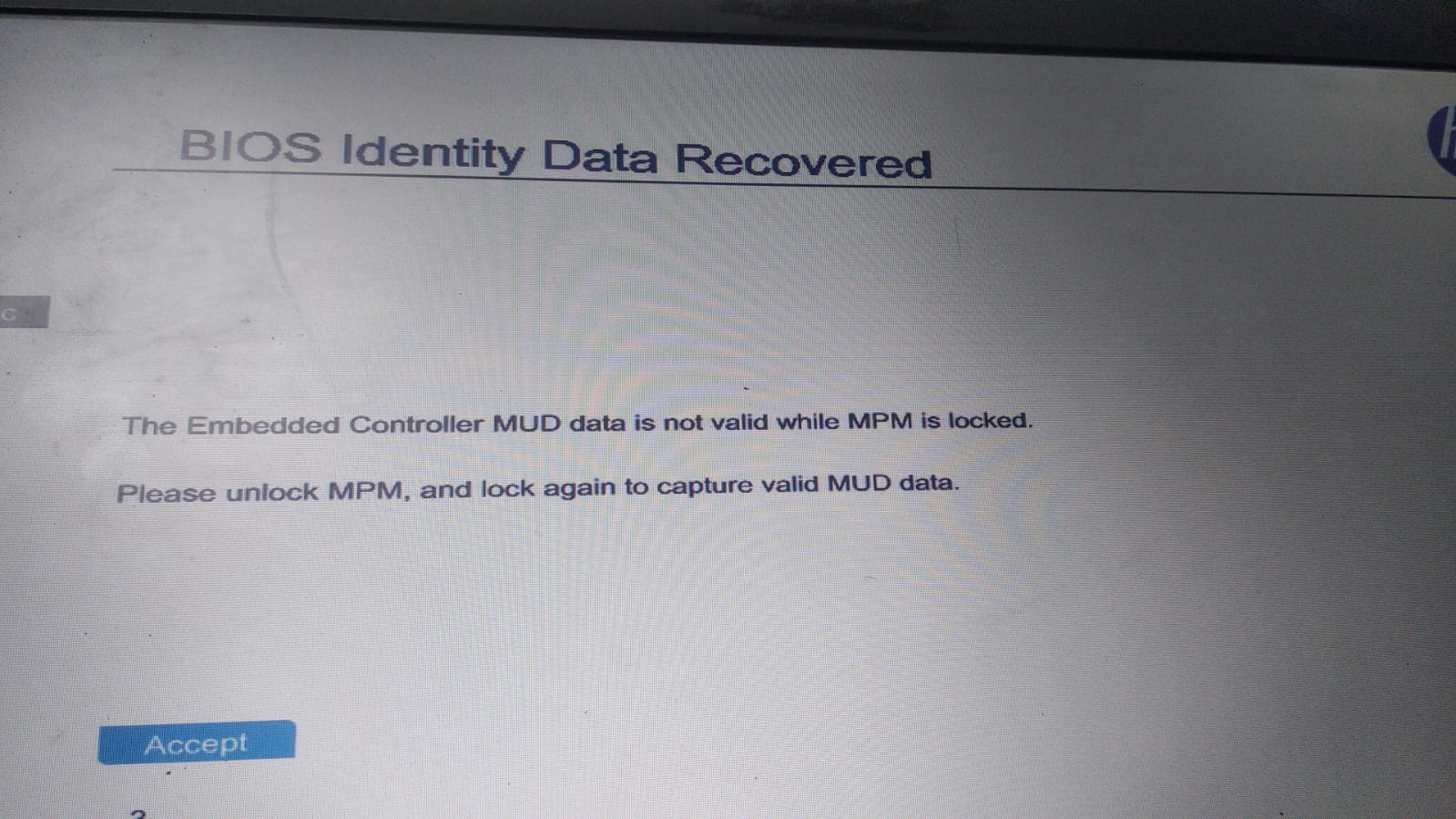

    hp probook 640 g1
    need to remove password

    Re: hp probook 640 g1
    Try.
    I don't provide help for people using CH341A and a clip.

      • alihomee
        • Dec 2012
        • 1593
        • malaysia
        Originally posted by DanielDacko
        Try.
        totally no display with this file .....i tried some other dumps but they gives some issues
        • alihomee
          • Dec 2012
          • 1593
          • malaysia
          Try.
          tried this file with different notebook but same model and it works but display is so late
          • RethoricalCheese
            • Mar 2013
            • 1519
            • Estonia
            Try again with the file he sent. It should work just fine. Maybe a bad solder or bad programming first time.
            And you should not use it on another machine because ME and DMI is different. You will have problems. Always modifiy original file.
            • alihomee
              • Dec 2012
              • 1593
              • malaysia
              tried again with different flasher it works ...only a bit late display ....thanks for responce and file
