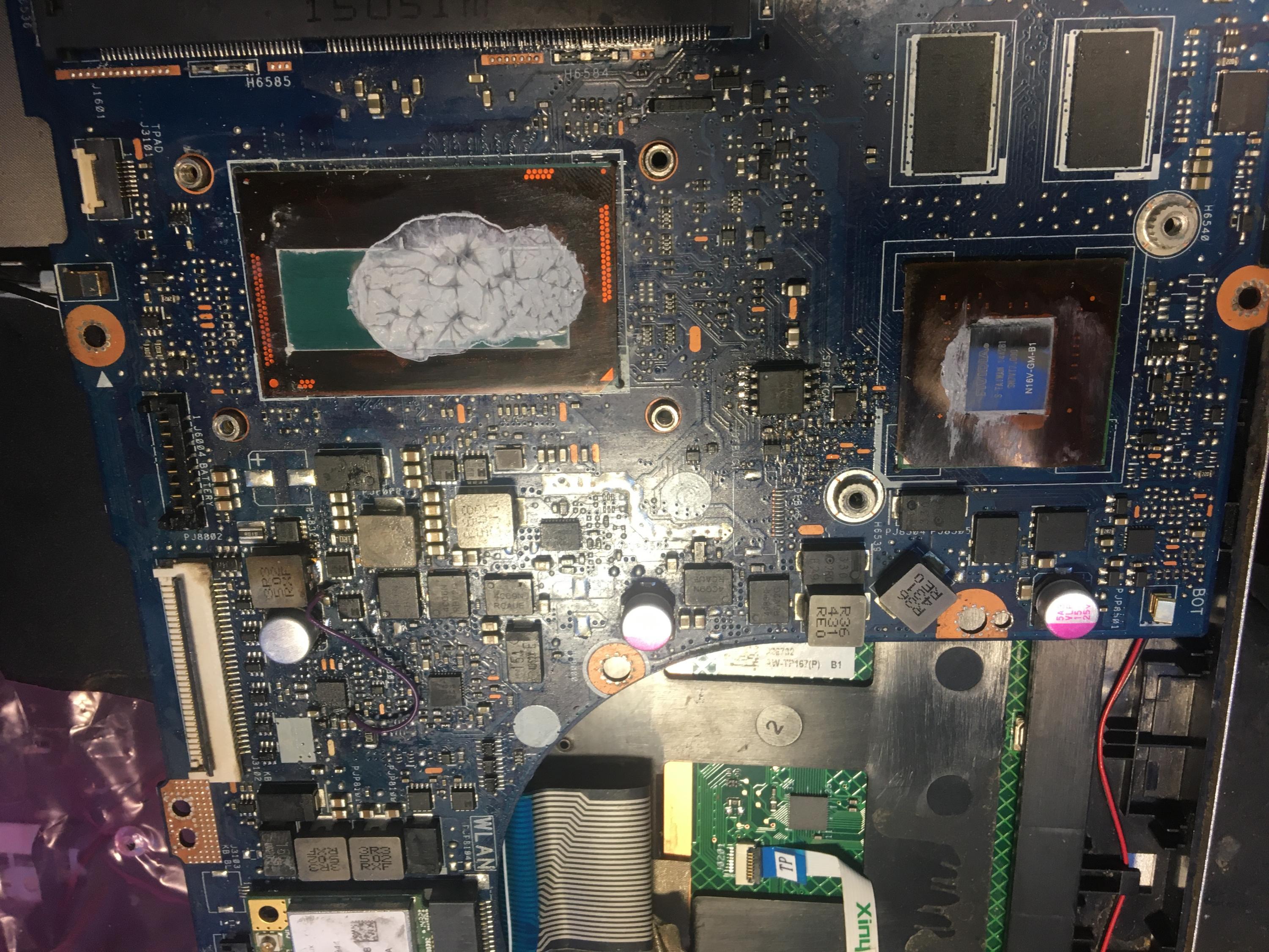

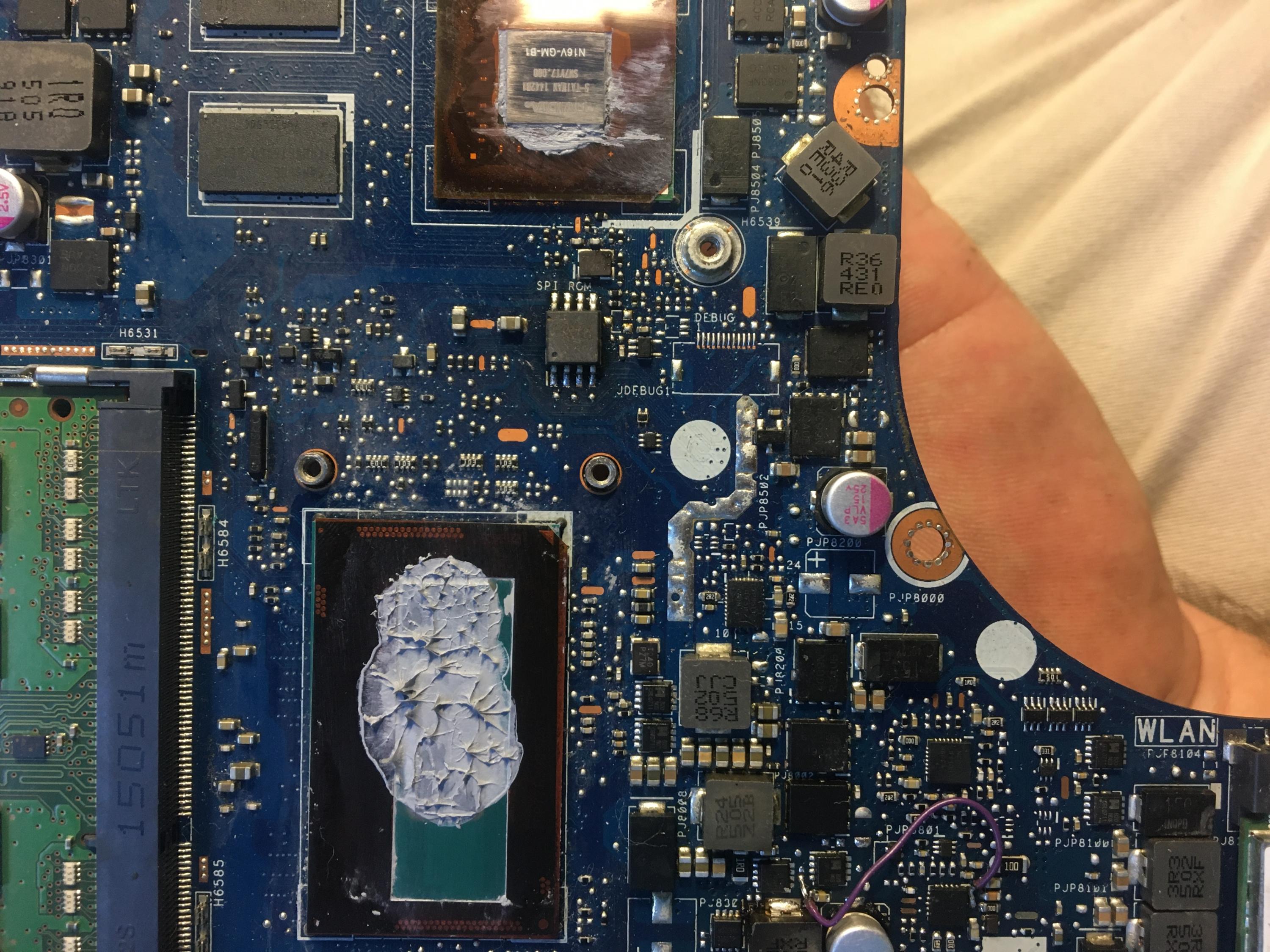

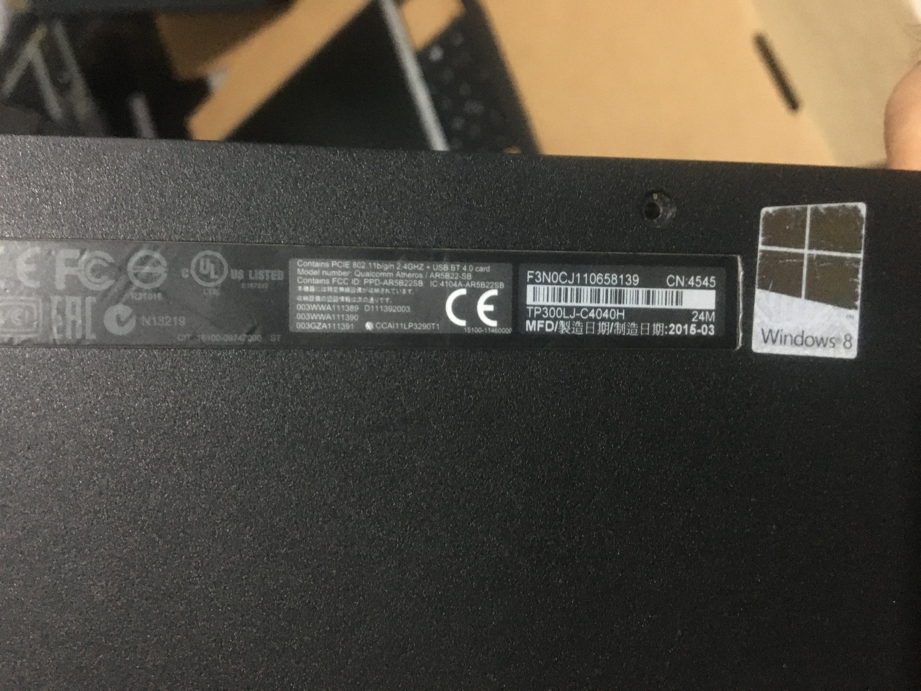

    hi
    A problem caused by the BIOS update to the machine,how can we find a solution to the problem, I would be very grateful if you help, vesko356 sent 3 bios, but the result is negative, I ask for help from our valuable Masters, I add my own BIOS that I read through

    Re: ASUS TP300LJ-C4040H fan running full performance after BIOS update
    Originally posted by gungor1981tr

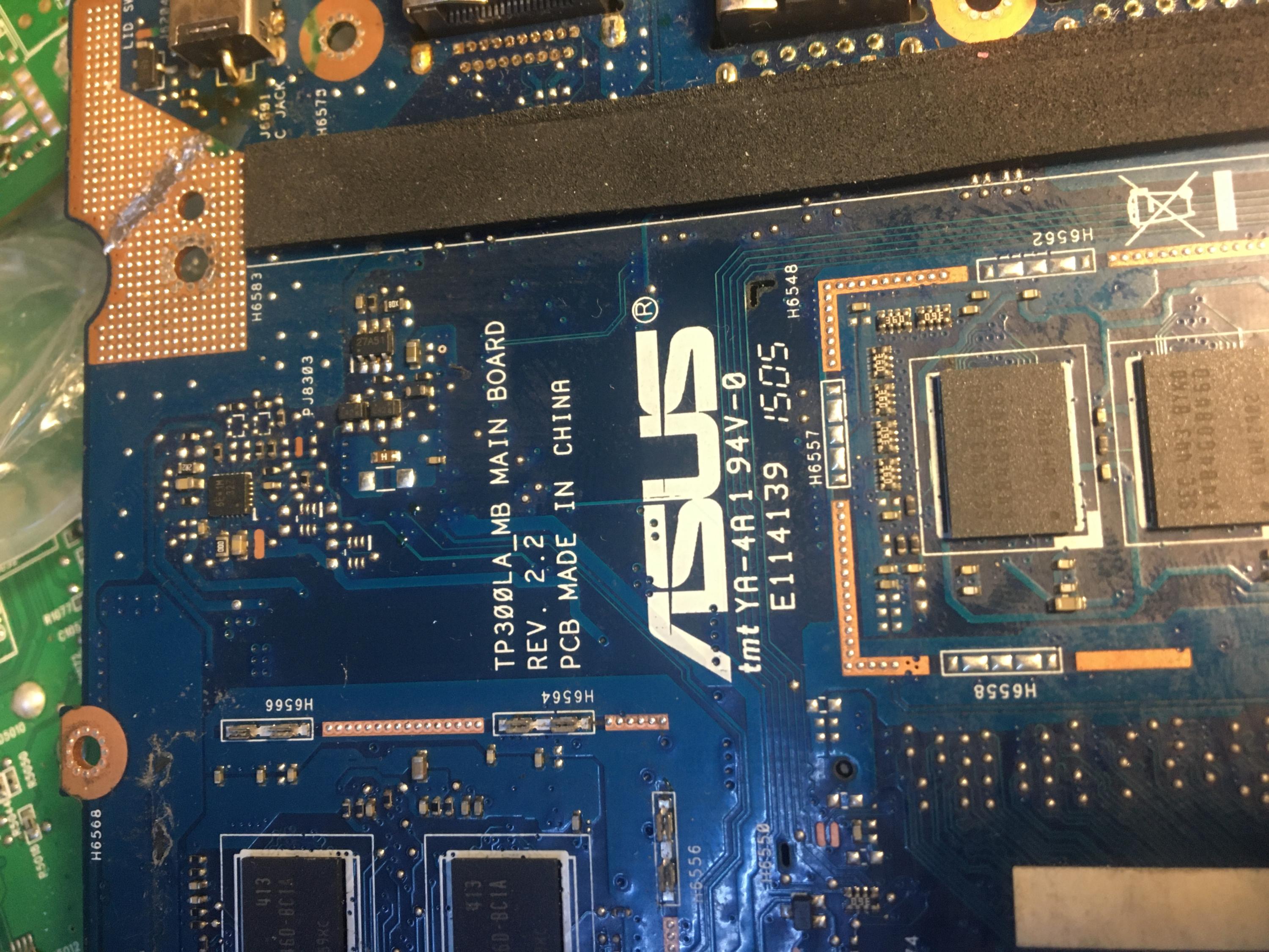

    TP300LA_MB REV2.2 board number
    model:tp300lj-c4040h

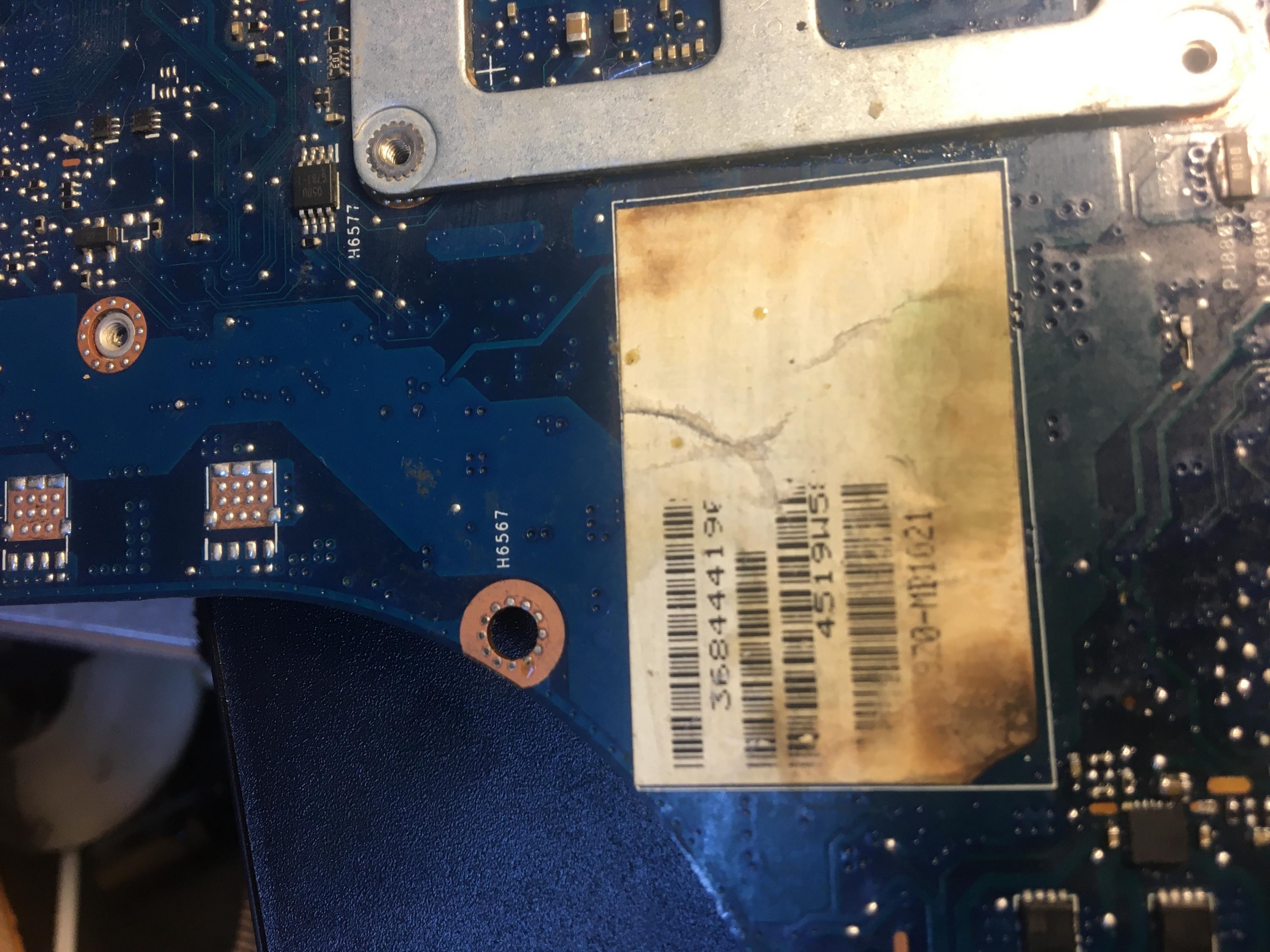

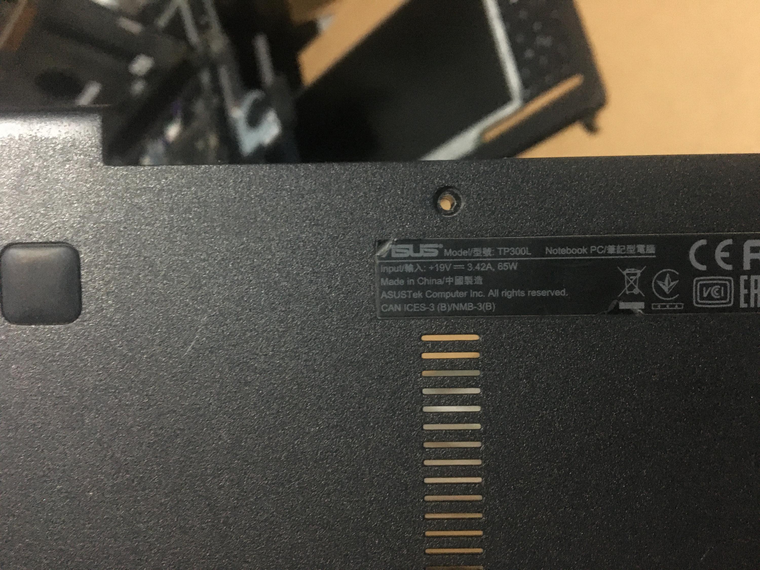

    Your original bios is TP300LJ, you said the board is TP300LA?
    The sticker is unreadable, or at least I can't read nothing to give me a clue in the right direction.
    I've sent you the file to test based on your bios and cleaned ME firmware (v.10.0.30.1072).
    Edit: And the latest update from the Asus support page TP300LJ-AS.208 + Clean 10.0.30.1072 ME firmware.

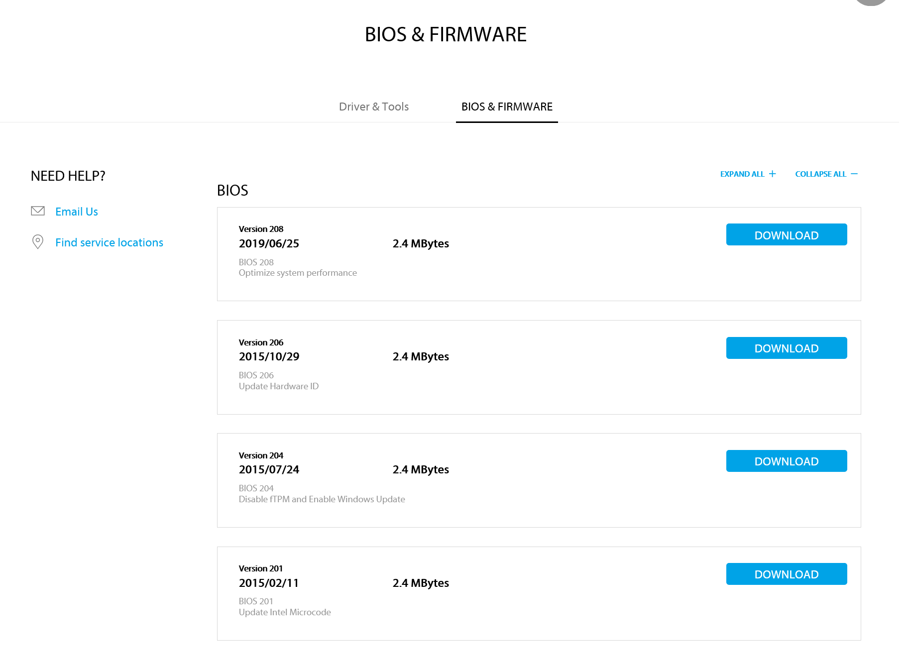

        could you please make me a 2015 bios update and add it ?
        • Vesko356
          VIP Moderator
          • Aug 2018
          • 4386
          • Bulgaria 🇧🇬
          Which version - 201;204;206?
            201 please
              201 please
              Here you are TP300LJ-AS.201:
                Thank you very much, get what you want in life on the understanding of patience, the device is currently running as a fan 2700-2900rpm OK
