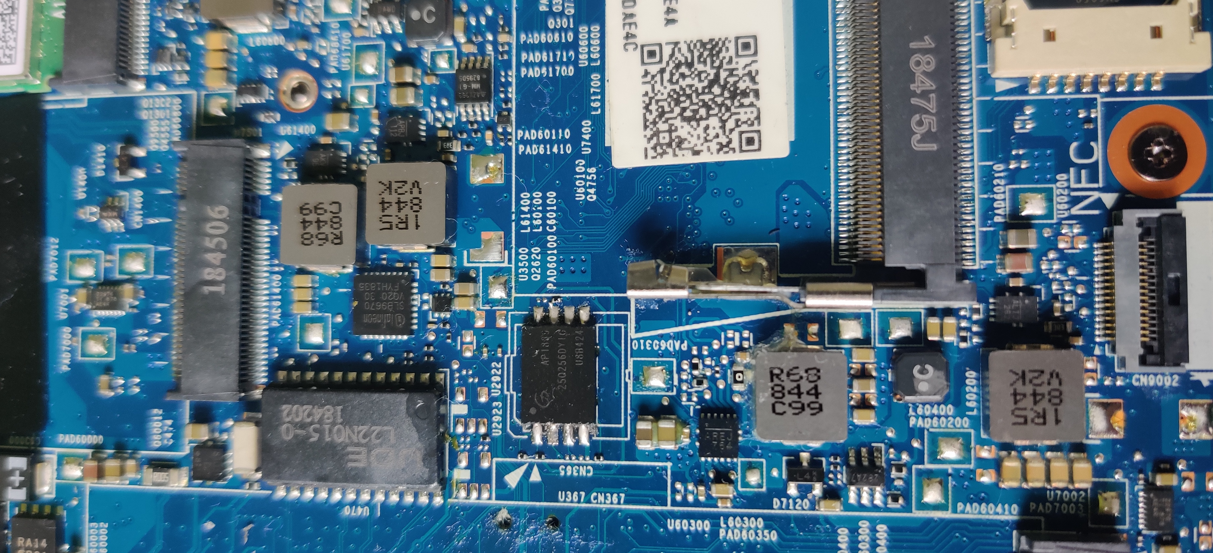

              Hello guys!
              I've read a lot here, but unfortunately I can't get any further. Actually I only had one problem with my BIOS, then unfortunately I destroyed two contacts when unsoldering the main chip, so I haven't found a way to read it yet.
              For this reason I bought two new chips. These also work and the notebook is running again, but I have no idea how to activate MPM. Because the DMI information is incorrect and I cannot change it. When booting, the error always appears that there is a problem with the Security Device Unit.
              Since I can't get to the data from the main chip or don't know whether it's possible because of the broken contacts, I only have a backup of the original EC available. I have a backup of the new bios, but I don't know if that helps.
              I read something about this bin file that you copy onto a USB stick and boot from, but unfortunately this doesn't work. Then I read that you have to set the region to a valid one, but what exactly can I do to move forward?
              It's about an HP Elitebook 850 G5. Have already found all the data:
              Serial Number : 5CG85179YC
              Product Number : 3JX60EA
              Description : HP EliteBook 850 G5
              BID=17WWCSBT602#SABD#DABD
              3X476J6S6b7B7H7M7Q7W7m7saBaEapaqauawbUbhcAdUdpdqfAfXgdhKhkjh.ym

                Originally posted by Friend33
                Hello guys!
                try to write DMI data with this..

                      I flashed the file. Unfortunately now only the fan turns on and Power and F11 light up. Only black screen and no boot.
                      However, I have to admit that before I saw your post, I tried a bios update, but that didn't change anything. I uploaded your file immediately afterwards. Is it possible that the EC chip now also needs to be reloaded?

                              Fan rotates and F11 lights up. I don't understand that. The last thing I did when the laptop was still running was to update the bios to the latest version. Is it possible that some controllers aren't working with your files?
                              • hoaca388
                                Badcaps
                                • Jan 2022
                                • 11787
                                #1015
                                Carefully check the bios chip area, especially the small components around the bios chip pin.

                                  I think my motherboard is broken. I soldered all the pins again. The notebook no longer wants to start.

                                    No longer starting just look for an unsoldered pad or a short around the IC

                                      Okay, I'll check it out. Actually not much can have changed because I always read and write with a pogo probe. So at the moment the laptop starts up without a picture and only the fan is running and a lamp is on, even without RAM and SSD no beep code. I'll check it again and report back. I thank you all!
