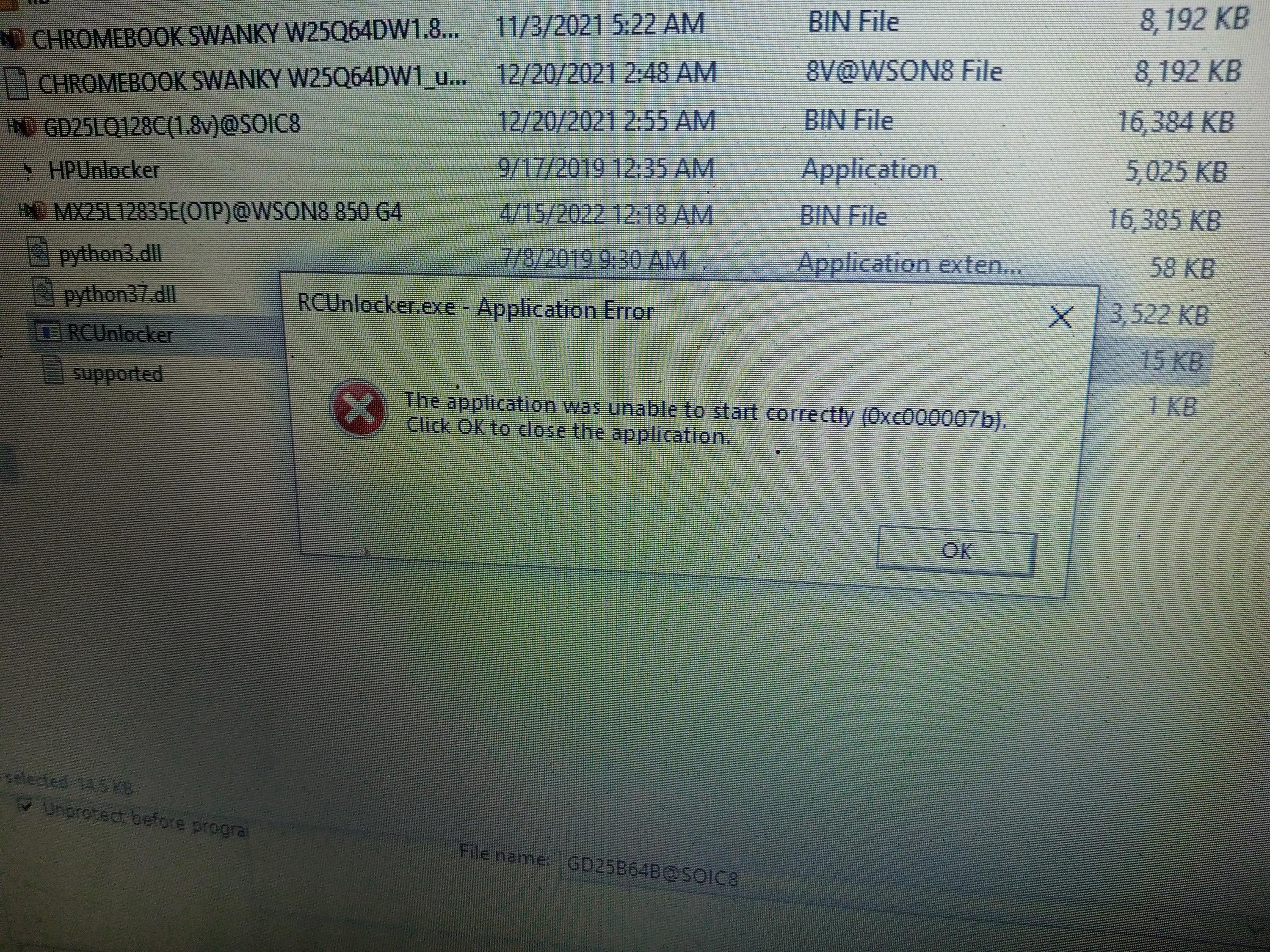

                      • dammysholove
                        • Jun 2017
                        • 59
                        • nigeria
                        #351
                        Re: RCUnlocker
                        Error
                        Rcunlocker showing error
                          • 20710
                          #352
                          Re: RCUnlocker
                          Originally posted by dammysholove
                          Error
                          The instructions how to use it are at post #1
                          Quote:
                          Usage: Drag and drop .bin file to .exe file.

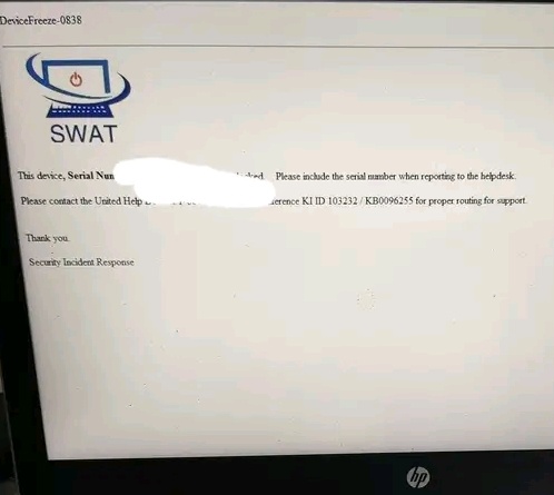

                            #353
                            Re: RCUnlocker
                            can i use tge tool to remove SWAT?
                            • RethoricalCheese
                              • Mar 2013
                              • 1517
                              • Estonia
                              #354
                              Re: RCUnlocker
                              Swat?
                              • juntmeako
                                NOOB
                                • Jul 2020
                                • 67
                                • na
                                #355
                                Re: RCUnlocker
                                Originally posted by RethoricalCheese
                                Swat?
                                yes, SWAT, mostly hp
                                • juntmeako
                                  NOOB
                                  • Jul 2020
                                  • 67
                                  • na
                                  #356
                                  Re: RCUnlocker
                                  SWAT security locked, anti teft enabled
                                  • RethoricalCheese
                                    • Mar 2013
                                    • 1517
                                    • Estonia
                                    #357
                                    Re: RCUnlocker
                                    Repeating the same word is of no help
                                    Give us a picture or something.
                                    • juntmeako
                                      NOOB
                                      • Jul 2020
                                      • 67
                                      • na
                                      #358
                                      Re: RCUnlocker
                                      here is rhe picture, image not mine.
                                      • deleted
                                        • Feb 2022
                                        • 10
                                        • Philippines
                                        #359
                                        Re: RCUnlocker
                                        in this case you need to clean the bios and second chip unlock that would be success to unlocked
