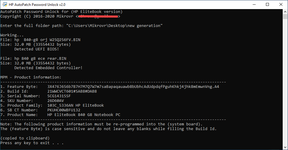

                  I don't have any issues with G6.
                  Originally posted by onizzbox
                  @RethoricalCheese
                  Perhaps this is the request, although the MPM data is not required, depending on the model.
                  That's indeed what I'm looking for. Is this something you made yourself?
                  It would be nice if there was a way to just export this into a clean bios file.
                  Kind regards

                    DonZott, just check out uefitool. It's way easier than manually entering anything. Open your file and search for your SN, then you will see which section it is in. Super simple.

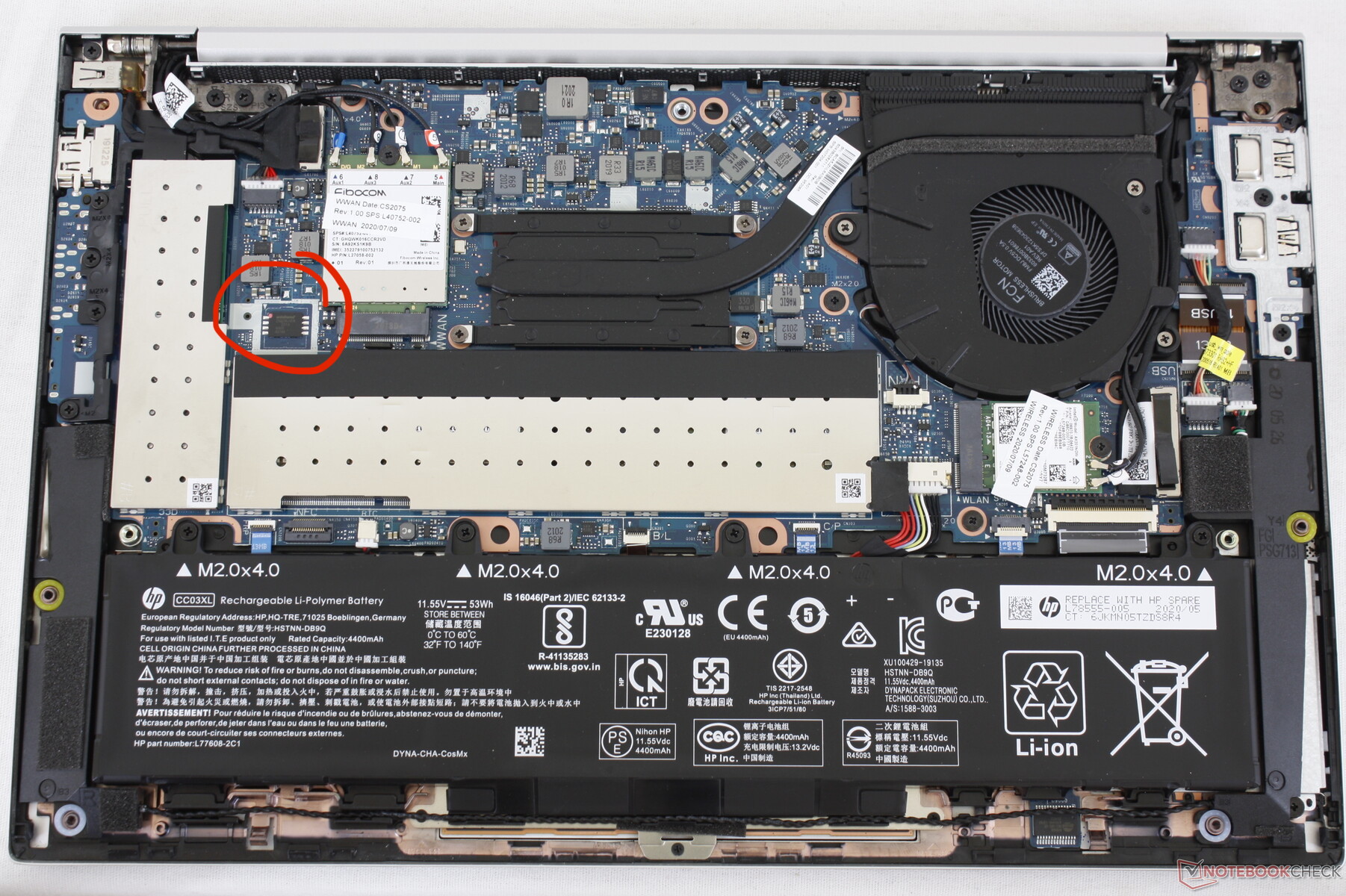

                                Hello Everyone. I have a 830G6 laptop with BIOS password locked.
                                I have tried the following:
                                1) Desoldered the 16MB Winbond flash (25Q128) on the underside of the motherboard
                                2) Extracted the BIOS content from that chip and put it into RCUnlocker
                                3) Erase and wrote in the output from RCUnlocker into that chip
                                4) Soldered that chip back onto the motherboard
                                Here's where things become weird. Once I've reassembled the laptop and connected the battery (I haven't even attempted to turn on the laptop), the LED beside the charging port starts flickering (white/orange) and the "Caps Lock" button is lit. When I tried to turn on the laptop, nothing happens.
                                5) I have also tried repeating steps 1-4 on the 32MB Winbond flash (25Q256), but to no avail.
                                I have uploaded the files in the attached.
                                Any suggestions?
                                Thanks.

                                  write the bios chips with the original content and see if it starts ..

                                    I've tried to write back the original contents into the BIOS chips, but the laptop still doesn't want to turn on =(
                                    Any other suggestions?
