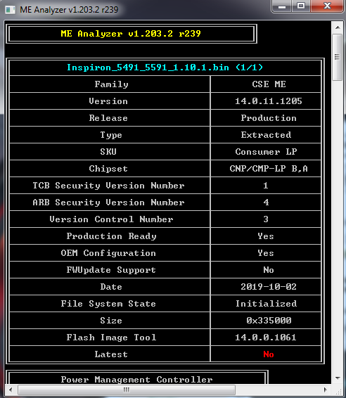

                Your file is not ME cleared, it's just initialized. Unfortunately, I can't clear it too, this is merely just observation.
                  It does not need to be cleaned, as it is original/native dump, and ME firmware was already "married" with the hardware. If it had to be cleaned, I would have done it with or without these observations of yours, so it is not bad to both observe, and to learn some basic concepts.
                  Of course, there is a possibility that OP didn't program the chip correctly, especially if he didn't use verification, there is a possibility that it is not soldered correctly on the motherboard, and so on.
                  But the problem is not always in the bios, and most of the times unfortunately it is just a hardware issue.
                  BTW If you want to learn there is an excellent guide, you can find out how to do it -----> https://www.badcaps.net/forum/showthread.php?t=88533

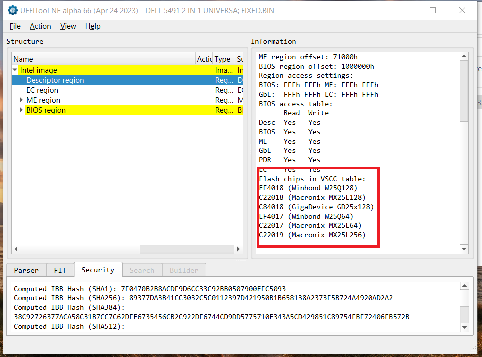

                                      Could you please tell me the name of the bios chip? My motherboard has lost its bios chip
                                      • hoaca388
                                        Badcaps
                                        • Jan 2022
                                        • 12278
                                        Re: Inspiron 5491 2 in 1 bios dump needed.
                                        Here
