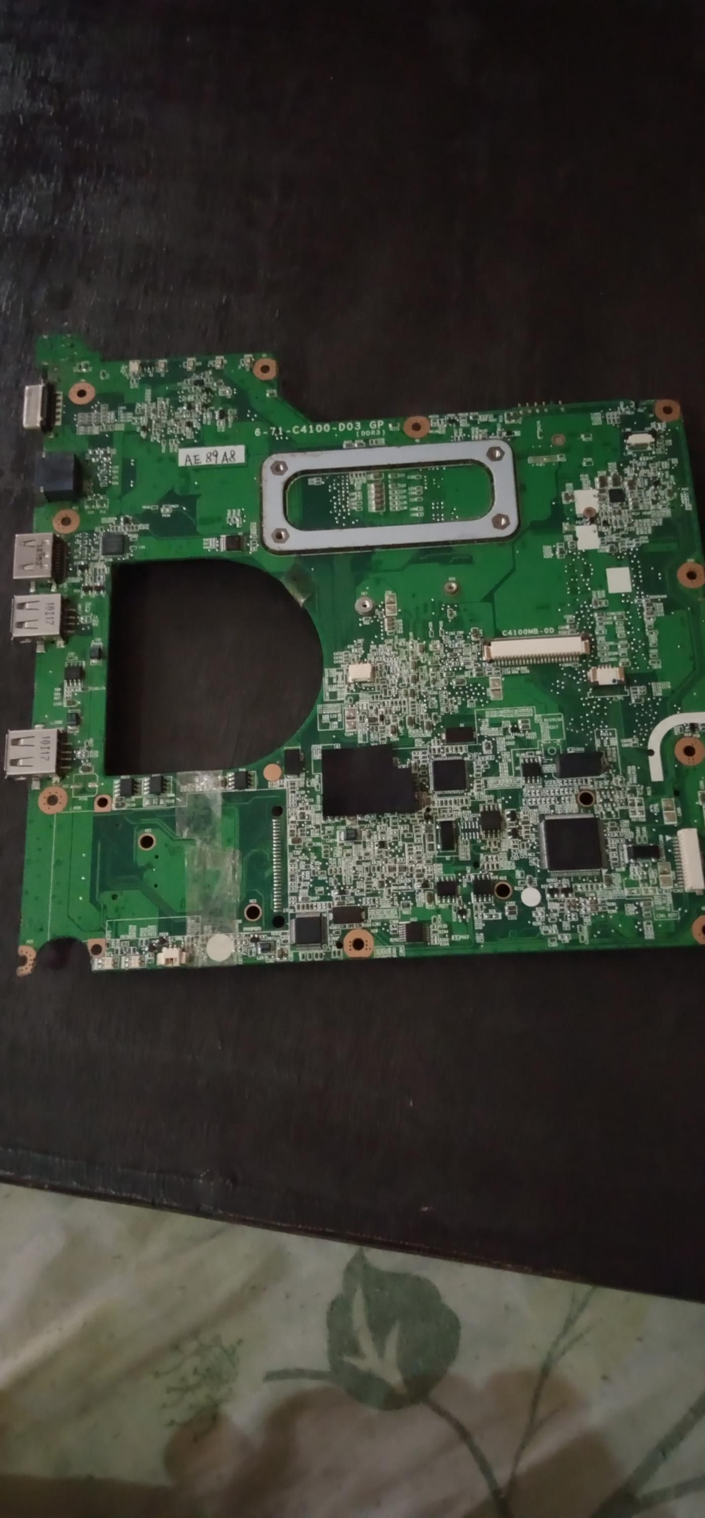

      This is the board zinox

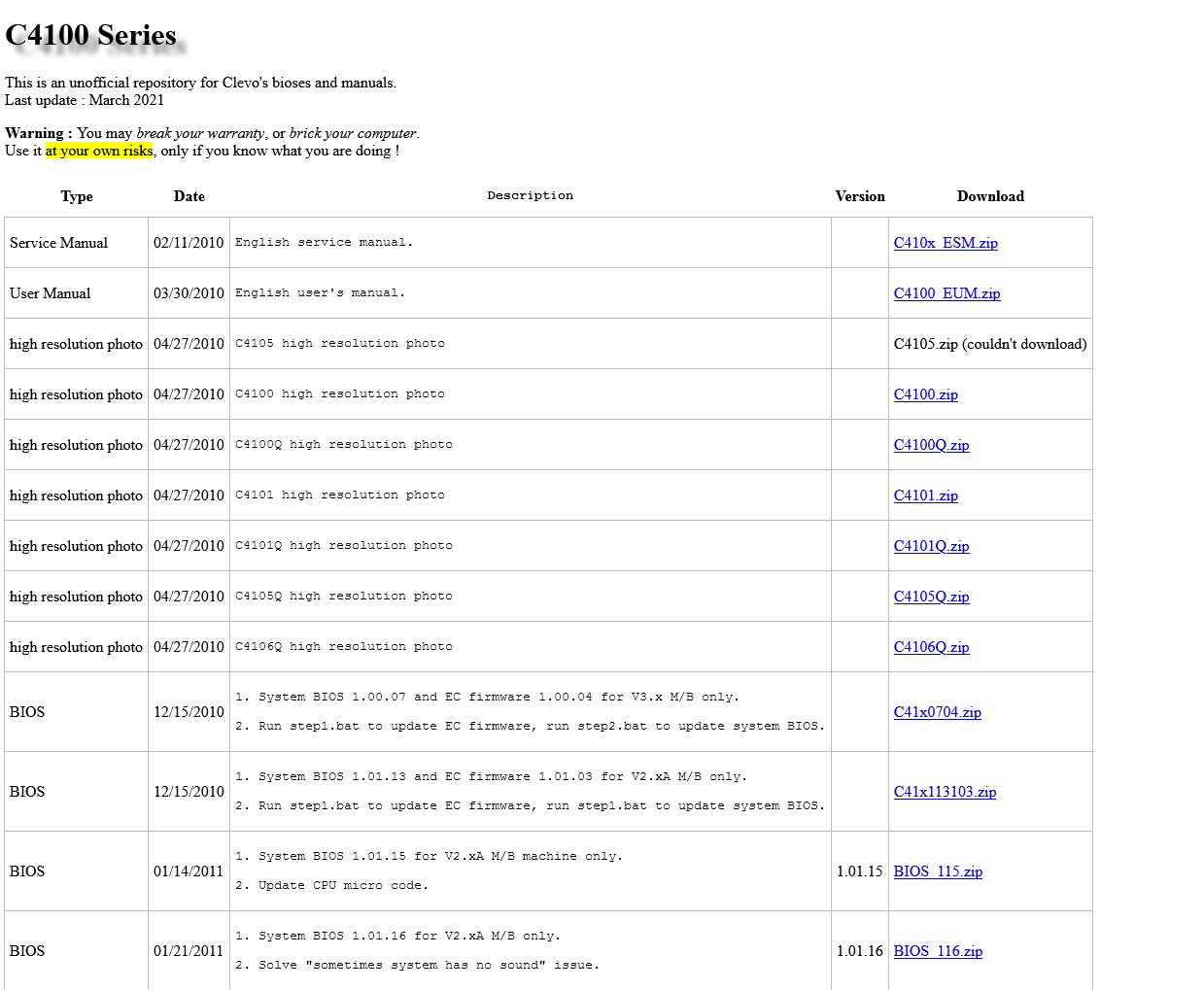

          Here https://repo.palkeo.com/clevo-mirror/C4100/
          Log into the site with
          Username: repo
          Password: repo

              Look further down where it says Bios . Choose the right one for your board version.
                • 21692
                Re: help me with this bios 6-71-C4100-D03
                Originally posted by Zeedu
                Thank you, but I just got manual, if you can help me find the bios file.
                Here is each bios version. Each one has a 2MB 2,048KB BIN for SPI programming. The other files are included too if you want to use them for bios recovery (wph) and for updating the EC from a bootable DOS flash drive.
                System BIOS 1.00.07 and EC firmware 1.00.04 for V3.x M/B only. C41x0704.zip
                System BIOS 1.01.13 and EC firmware 1.01.03 for V2.xA M/B only. C41x113103.zip
                System BIOS 1.01.15 for V2.xA M/B machine only. BIOS_115.zip
                System BIOS 1.01.16 for V2.xA M/B only. BIOS_116.zip

                  I look down but I don't understand how they code the bios instead of c4100, they write c410x. I have downloaded it, is not like the bios I use to flash. See the attachment.

                      See post #10 ,posted a few seconds before you did. Every bios on that page is for the C4100 ,forget how they are named for now. The important thing is to check which board version you have,there must be version number on the board somewhere. The V2.xA is for a Version 2. something A board ,for example the x can mean 2.0A ,2.1A .
                      The same with the V3.x ,it could be V3.0 ,3.1 ,3.2 (they could have made a number of different revisions to the motherboard over the time it was produced.)

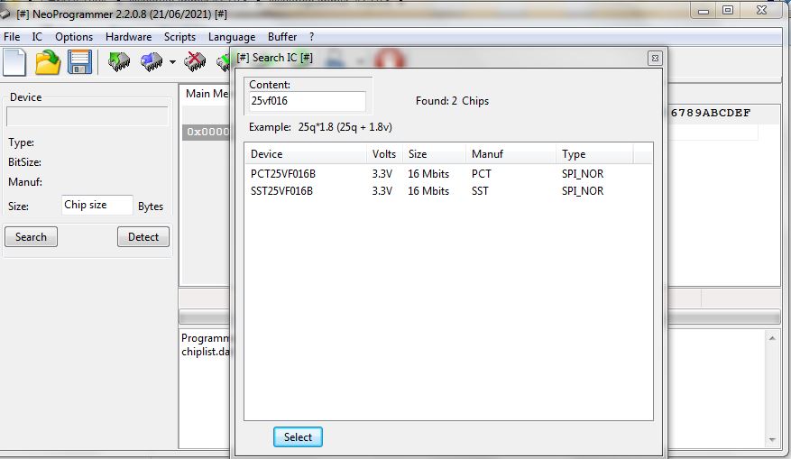

                          What model is your programmer ,and what part number is on the bios chip .EDIT: its a SST25VF016B in the service manual/schematic
                          In my previous post i metioned the version number, i think its on a small sticker on the ram slot
                              Ch341a programmer

                                  Try NeoProgrammer software from this post - https://www.badcaps.net/forum/showpo...50&postcount=5
                                  It supports the chip
                                      Thank you very much!!
