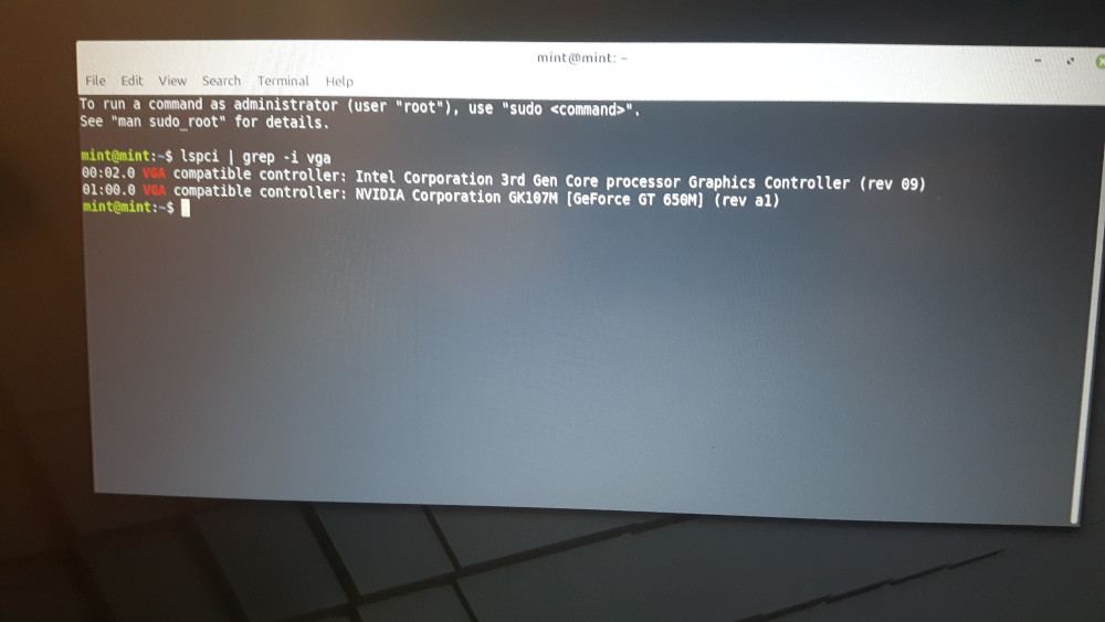

    Hi I need a Dell Inspiron 7720 i7 GT650M bios, DA0R09MB6H1 REV: H, HM77 SLJ8C, my problem == no display. I have tried different bios from different sources but without success. The screen has only one bios without an external graphics card only in the intel hd version but linux and windows do not detect nvidia. I try different bios from https://www.badcaps.net/forum/showthread.php?t=31849, lapbone, alisaller but always without display.
    I'm looking for exactly my configuration.
    regards for all
    sorry my english
    bios only intelhd version from forum elektroda.pl
    good for testing SLJ8C, display, CPU etc
    not good for nvidia

    Do you have the original backup, if so post it,and also the service tag

      this one
      https://www.badcaps.net/forum/attach...1&d=1628091811
      after push on i wait few minutes but blank screen, no display no backlight
      stag == DQ1MDT1

            Try this one,merged with update A17 ,clean ME .

              20 minutes
              • warsztat
                • Feb 2017
                • 190
                • Polska
                Re: Dell Inspiron 7720 i7 GT650M
                WOW
                previously there was no entry from nvidia
                I'll do the tests and pass the report

                  Dear SMDFlea all good, you make good bios. i have one questions, how did you unpack bios from dell site ? what program (version) bios you made ?
                  Thanks again for Your help
                    • 21692
                    With this bios i just ran the exe and got the bios.cap from the temp folder at "C:\Users\MyName\AppData\Local\Temp .It was a bios update so it still had to be cut to the right size with a hex editor,then merged with your backup ,and the ME cleaned.
                    Some of the older dell bios are extracted using the command line
                    bios.exe /writeromfile
                    bios.exe /writehdr
                    bios.exe / writehexfile
